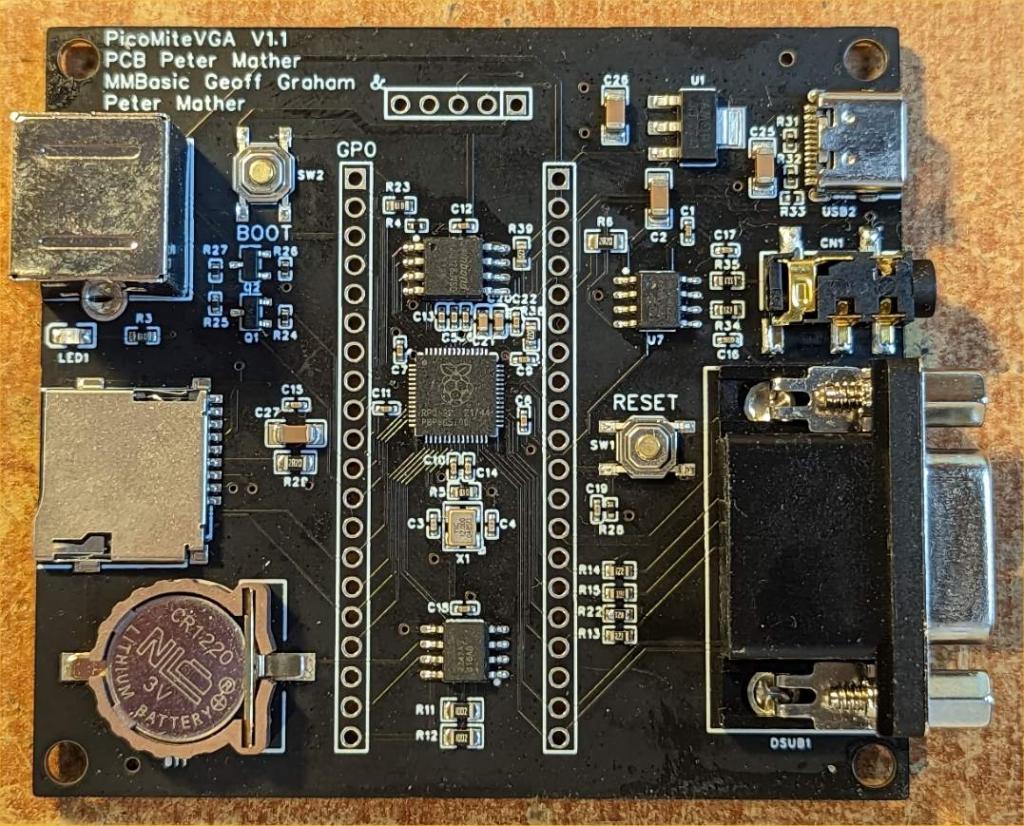

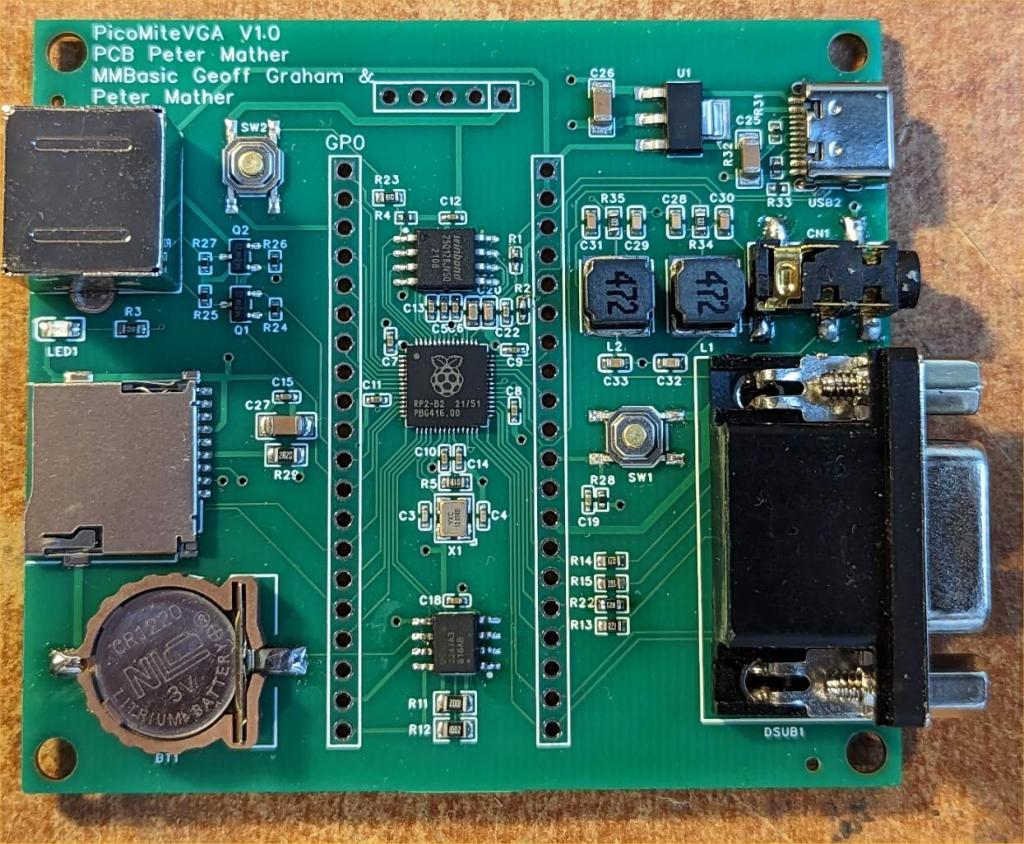

Here are the completed boards as received from JLC. Both the filter and DAC versions work perfectly for all functions with no errors.
If any one is interested I can post the gerbers and design files

Er... why is one V1.0 & the other V1.1?
I'm guessing the files would be for V1.1 - right?
Posts: 12074
Posted: 06:52pm 26 Apr 2023
  Quote  why is one V1.0 & the other V1.1?
V1.0 has Volhout's inductor filter
V1.1 uses the MCP4822 DAC
I will make both sets available - not much cost difference. The DAC has better high frequency response but uses a bit more system resouerce
