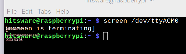

hitsware2
Joined: 03/08/2019
Posts: 738
Posted: 07:51pm 07 Mar 2023
OPTION KEYBOARD DISABLE
Kills the hookup .....
I.E...
my site
Posted: 08:00pm 07 Mar 2023
Yes but then you can re-connect
