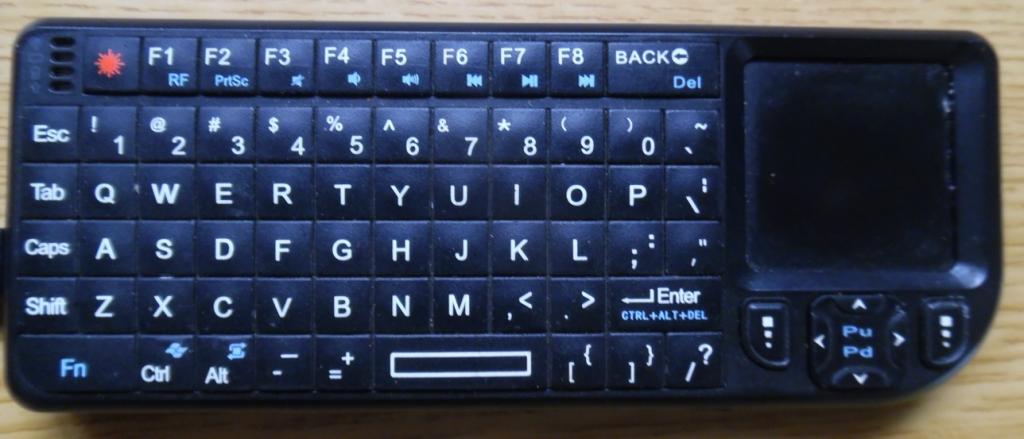

I got a mini usb/wifi cheap fullish kb... with laser pointer but not mmbasic compatible. I'd like a way to convert vga to composite as I got some small screens that only have composite. I'm thinking of mini picomite and vga screen cheap.

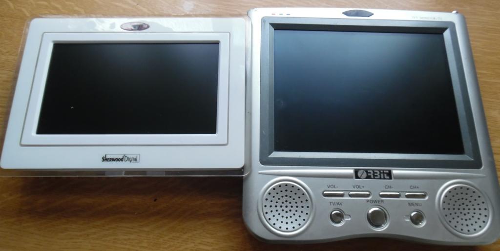

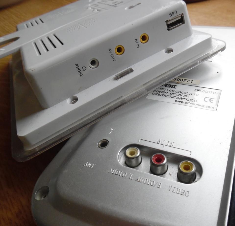

Cheap avi screens from charity shop, one is a meant to be a photo viewer, other an analogue tv.

Wouldn't it be nice to use these cheap mini kbs with touch mouse with mmbasic?

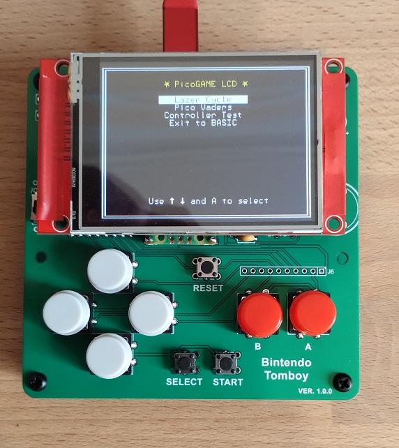

Hi folks,
It still needs some titivating, but courtesy of @bigmik's PCB skills and with a little help from @Turbo46 and others:

Posted: 10:07am 07 Jun 2023
Hi Tom,
Very nice !! And it already plays 2 games !!

Thanks folks, I think the plaudits go to @bigmik; left to my own devices I would have been another 12-18 months to produce a PCB and even then the layout would not have been good.
  Volhout said  And it already plays 2 games !!
PicoVaders is @Martin H's work, I'm still messing with it to get the best behaviour on the Bintendo.
Porting from the PicoMiteVGA to the Bintendo isn't trivial because the standard PicoMite firmware which the Bintendo runs doesn't have the same sprite support*. I'm hopeful I can implement an approximation of the missing bits as CSUBs, perhaps even by repurposing Peter's code from the PicoMiteVGA.
* Though PicoVaders is simpler as Martin didn't use the sprite support ... it may not have been present when he started writing it.
