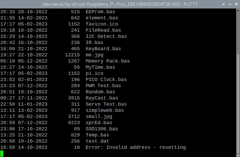

  TassyJim said  MMEdit terminal seems to talk to it OK but there is a problem with the file manager.
XMODEM works but does not conclude reliably. The file list is OK provided there are not too many files to list.
Both problems look like a timing issue that I will track down in time.
The usual "load and run" program transfer seems to be reliable.
They take 10 times longer than USB but will be much quicker than removing a device from service (up a gum tree) to update software!
Yes same here, it will list a full page worth of files and crashes with "ERROR: Invalid address - resetting" on the key press to continue listing files on the SDcard.

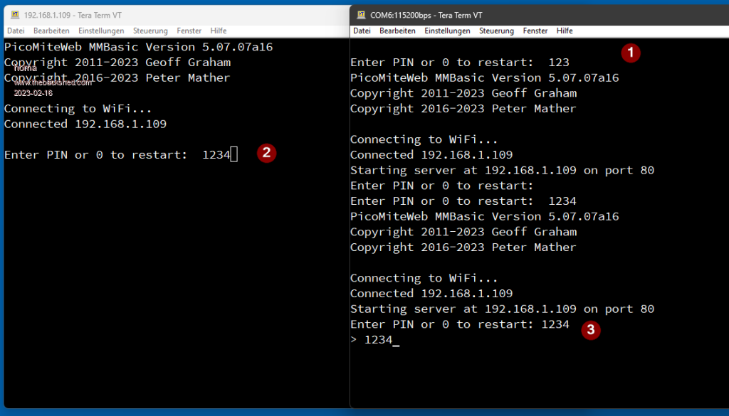

@peter, hint for a  glitch:
to protect the Telenet console I tried to set OPTION PIN 1234.
The incorrect input via USB leads to a reboot! (1)
But when reconnecting via Telnet no access with correct PIN works! Also restart! (2)
Only with access via USB and correct PIN I get back into the Picomite. (3)

It would be better to keep things simple to start with and not use things like OPTION   PIN. Bugs like that are for a MUCH later day
