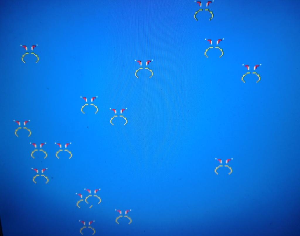

Posted: 10:22pm 03 Feb 2023
Yes Phil, it seems that sprite read does not read black or sprite write does not write black.
I changed the cls to blue and the prog works even though the sprites are from data and have black pixels.
They were drawn for a black back ground, how to use a black background?
16 16x16 animated sprites, to fast to see.

Posts: 3418
Posted: 11:33pm 03 Feb 2023
The darkest non-black colour is dark green, RGB(0,64,0).
Edit.
If that isn't dark enough you could put a 10k pot. in series with the Dark Green pin, GP19 then adjust it to suit. It will also affect any other colours that use dark green such as white so it will be a compromise.
When you run other programs that need normal colours turn the pot back to 0R.
Edited 2023-02-04 09:53 by phil99

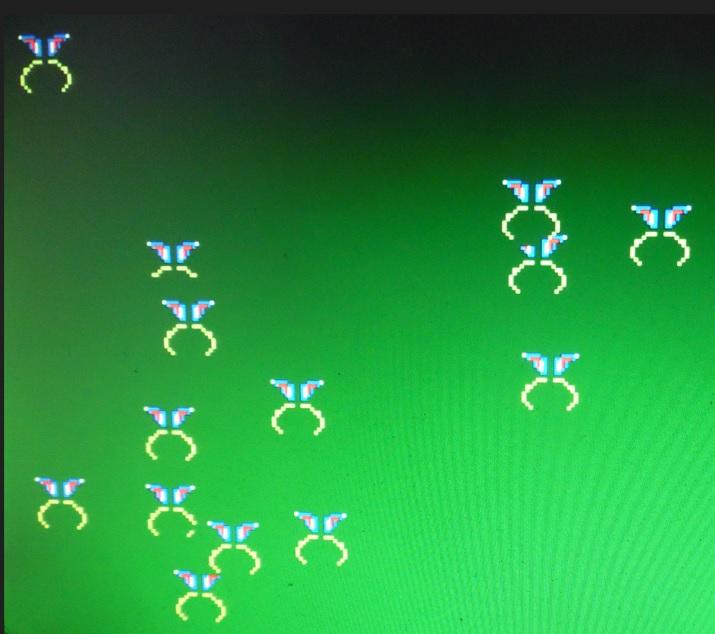

Posted: 08:16pm 04 Feb 2023
Phil- dark green is not black :)
Using ili  480x320 and "sprites" worked but now don't. Maybe new mmbasic. doesn't work with any background colour... but says something about miso connected.. it is set up for touch.. but there's miso issues and I needed a 680R resistor.
cls RGB(0,    0,    255)
blit read 3,10,10,16,16 'reads 16x16 background to blit buffer3
udg1 'draws sprite1 on screen at 10,10
'pause 5000
BLIT READ 1,10,10,16,16 'reads sprite1 from screen to blit buffer1
udg1 'draws sprite2 on screen at 10,10
'pause 5000
blit read 2,10,10,16,16 'reads sprite2 from screen to blit buffer2
cls bl
Having fun with vga and sorting a keyboard
Think I'll restart with 640 bw graphics but what sprite will do or is it colour only...I'll read the manual
cheers, stan
I can't think of an alternative to use sprite to erase a sprite. a box or the code I used to draw the udg would be to slow. only got vga working 3 days and scratching head already.
ps thanks for the 10K pot idea..10K?!?
Edited 2023-02-05 06:30 by stanleyella
Posts: 9258
Posted: 10:10pm 04 Feb 2023
Sorry, you can't use a true black background with sprites. Black is always transparent. The frame buffer has space for 307,200 bits. Those are arranged as 640x480x1 (either on or off) or 320x240x4 colour bits. If you want a "transparant" flag then you have to lose one of the colour bits.  Instead, Peter designed it so that 0000 is transparent (and is also black) so that you don't lose one of the other bits (Red, Lt Green, Green, Blue).
Colour in Mode 1 is interesting. :)  Read the section on Tiles. Font 3 is made for the Tiles in Mode 1.
Edited 2023-02-05 08:13 by Mixtel90
Posts: 3418
Posted: 10:27pm 04 Feb 2023
To erase a sprite overwrite the with background colour.
eg:-
const dg = rgb(0 , 64, 0) 'Dark Green
BOX x, y, 16, 16 ,, dg, dg
Or make a sprite that is the same colour as the background (not black as that will be transparent).
Read latest VGA manual pages 88 to 90. All about sprites.
Edited 2023-02-05 08:29 by phil99

if frame=0 then'which sprite to draw
 box oldspx(temp),oldspy(temp),16,16,0,bk,1 'erase sprite at last position
 sprite WRITE 1,spx(temp),spy(temp) 'draw sprite1 at new position
else
 sprite WRITE 2,spx(temp),spy(temp) 'draw sprite2 at new position
end if
This is interesting, I got my sprite demo to work on black background and the sprites look brighter. It's very fast. I'm amazed. It's simple but looks ok.
