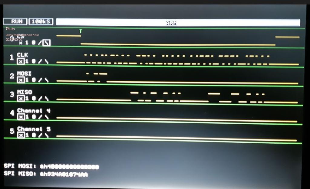

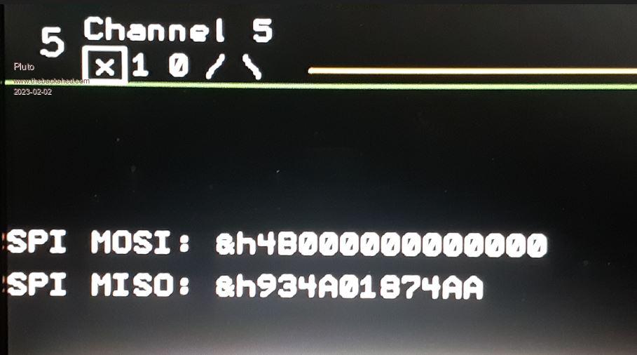

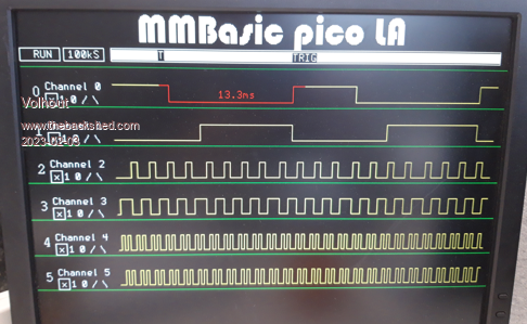

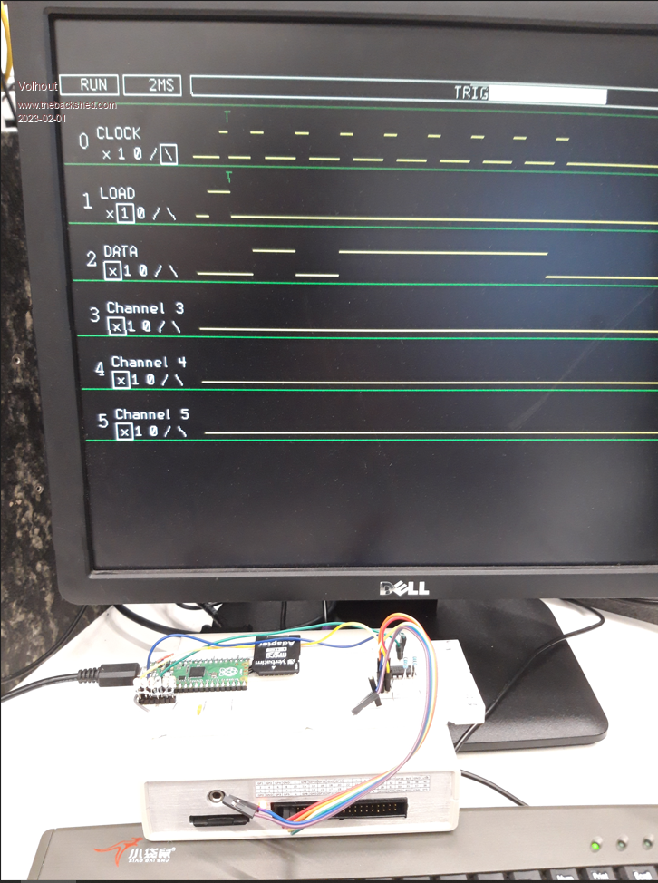

All folks, this is logic analyzer V0.14
This is what I would call alpha 1. When there are volunteers, try to put it to the test. There will be a user manual later, showing the technique behind it.
Since I hear some complaints about picomites that do not perform well at 252 MHz, run this version with OPTION CPUSPEED 126000 (the default picomite VGA speed.
The sampler runs at 126MHz and samples data up to 42MSps. The trigger engine also runs at 126MHz, but can require up to 100ns pulses, depending on the complexity of the trigger requirements.
The logic analyzer uses GP22 as an internal signal. pins GP0...GP5 can be connected to circuits under test (3.3V logic) and like a 6 channel oscilloscope you can observe the signals.
Pressing r will put the LA in run mode (default) and it will show the signals at the 6 pins.
pressing s will perform a single capture, and stop. Each s will restart a new capture.
The LA captures 4096 samples at various speeds. The display will show 128 of these samples at a time. You can zoom in and out with the UP and DOWN arrow keys.
Above the 6 waveforms there is an indicator bar showing what part of the 4096 samples you are viewing.
You can move your viewing window through the 4096 samples using the left and right arrow keys.
Triggering is an important feature of a logic analyzer. It can help you to select a specific part of a waveform. In example I2C. When you connect an I2C signal to GP0 (SCL) and GP1 (SDA) you can view these signals. If you want to capture the beginning of a I2C message you should trigger on the I2C bus START condition. An I2C START condition happens when the SCL clock signal is high, and the SDA data signal changes from high to low (falling edge).
This can be set up when
Channel 0 (GP0) is "1". This can be set by pressing the "0" key on the keyboard, until the "1' is indicated for channel 0
Channel 1 (GP1) is going from 1 to 0. This can be set up by pressing the "1" key on the keyboard until the "\" symbol is highlighed for channel 1.

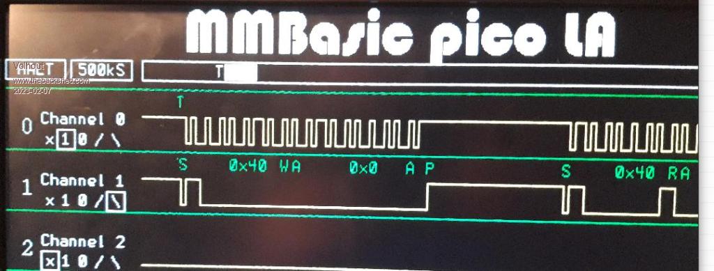

Since the I2C bus is fast, it may be desired to increase the capture speed of the logic analyzer to 1 or 2 MS. This can be achieved by pressing the "+" and "-" keys until the speed indicator indicates 1MS.
Now you should see each new I2C message (the start of it). If you want to study the message, press "s" to stop the sampler, and you can inspect the waveform by using the arrow keys.
When pressing the number keys, you will also be able to change the channel name. This should not present much of a problem to edit. The name can be 9 characters maximum.
I hope this meager introduction will get you going. Take a look at the signal from a NES controller (not I2C, but you can also trigger on it), the real time clock, the 44kHz PWM on the audio pins GP6 or GP7, or a serial port.
Happy playing ....

Logic analyzer version 0.14 in action, debugging the PIO training course exercise for CD4014 (8 bit shift IN register).

some further testing of LA V0.14. Been working on SPI decoding. As a test device I have used MCP23S17  16-Bit I/O Expander with Serial Interface (SPI). The LA is just hooked up on the lines (CS, CLK, MOSI and MISO) between MCP23S17 and the "SPI"- PicoMite (standard green Pico). Testing with 100kHz SPI.
For the LA I am using one of the "clones" (black with a WS2912 on board). Running at 378MHz w/o any problems.
I just added the SUB call for the decoder into LA's main loop:
'display the data
  scrnprint st%,sp%
  SPI_mode0_decoder
End
To start with I have focused on SPI mode 0. The code is still a mess with many fruitless routes commented out. Need some housekeeping before publishing.
I works at least for the case I have tested with various number of bytes involved. Works as long as the whole "CS low" part fits into the buffer (unpacked%()). The decoding results are "live" and changes according to the visible plots on screen. Quite easy to use thanks to your brilliant UI.
The LA will become a very useful tool. My PicoScope has only 2 channels; not too easy to use for SPI. My old USBee LA has enough channels, but operation is not very smooth and it is sometimes difficult to find the part of the graphs that are of interest. It is a Chinese clone! (When do you think we will find a chinese clone of your LA?)
/Fred

  Volhout said  3/ unroll fix (1 sample was sometimes fault when glueing waveform together).
SPI testing on LA V0.14 shows +90% of time correct, but occasionally there is a disturbance. Might be due the fault you detected in glueing together.
/Pluto

Posted: 03:04pm 02 Feb 2023
Hi Volhout,
the vertical lines make it much easier to follow the graph.
Trigger operation
SPI-decoding is very stable now. I thought my earlier disturbances vere due to my breadboarding.

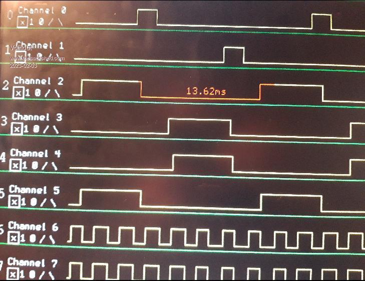

I added a feature I think is pretty usefull: measuring time
User interface: press "m" for "measure"
The sampling will halt, and the centre portion of channel 0 will be highlighted.
When edges are detected, the time between edges is calculated from the sampling frequency of the logic analyzer.
arrow keys change channel or next edges
"m" exits the measurement mode.
The time measured is calculated from the samples in memory. When sampling at 1 miliseconds, the resolution will be in miliseconds. The screen resolution may not show the time measured accurately because zoom may hide details.
The red color depends on the edges of the underlaying tiles, and will not line up with the edges of the signal. But you get an idea.
Here is the code (version 0.16)
LA_16.zip
Happy playing...
P.S. about the cursor... it will not look nice, since the underlying tiles are 16x16, so you will get a 16 pixel wide mis-coloured band. I can do it, but it will look uggggly. To get an idea: run LA_16, type <CTRL-C>, then CLS<CR>. The tiles that make up the screen.
Edited 2023-02-03 07:17 by Volhout

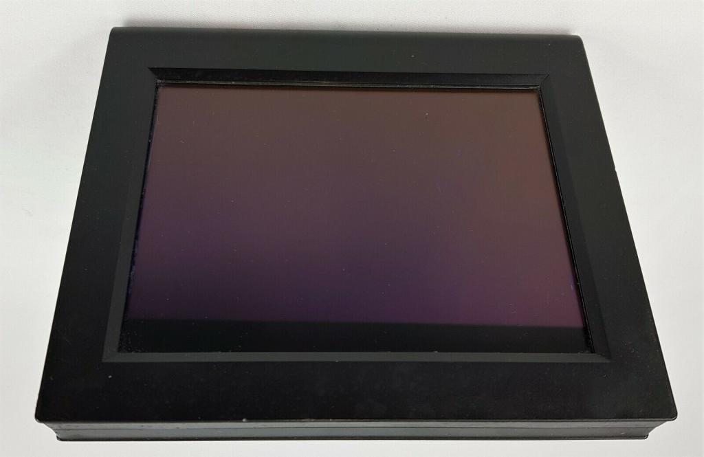

  Volhout said  Getting there..... A nice name for the program...
@Pluto: any idea when you can add the decoders (I2C and SPI) ? Do you feel a bit confident about them ?
wow
this together in a case with an 8' POS Display VGA Monitor like this
and you have a "standalone Unit"
Edited 2023-02-04 01:33 by Martin H.

For those who want to try the first instance of the I2C decoder, try attached version.
OPTION CPUSPEED 252000 for best experience. At 126 MHz the PS2 keyboard is not working optimal. To be fixed....
I2C decoder works best if you have sampling at 500kS or higher.
You have to connect SCL to GP0 and SDA to GP1 for this version.
Trigger: SCL="1" and SDA if falling edge ("\")
Best if you do single trigger ("s"), and when HALT shows top left corner, press the "i" button and wait.
You will see green text aligned with the traces on the screen. The characters "S" (start), "P" (stop), "R" (read), "W" (write), "A" (acknowledge) and "N" (not-acknowledged) are official I2C lables. The adress is in 7 bit notation. The data in 8 bit notation.
You can zoom in with the cursor keys.
Exit I2C decoder mode with the "i" button. Press "r" for repeat triggering.
LA_21_banner.zip
Place both files in the same folder on the SD card of the VGA picomite.
This is what it looks like...
This version does not (yet) provide framing error warnings in case data is corrupted. So you will not be warned in case there are any. Improvements may come in the future.
This decoder is based on PLUTO's work (although re-written to include synchronisation with the actual samples). All credit goes to him...
Edited 2023-02-07 08:09 by Volhout
