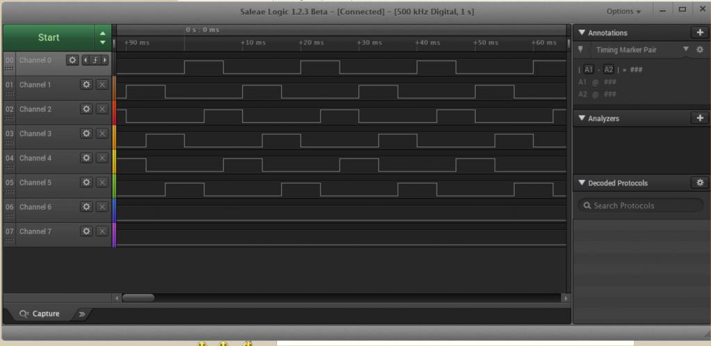

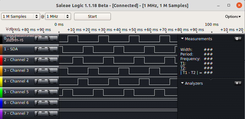

I'm confused. Are you saying that all is OK with channel 0? Certainly looks good on my logic analyser

Yes all good, I put the edit at the start in the hope you wouldn't waste time on it. Brand new Pico has a dud GP0. Output pulls up but not down, with only the scope impedance pulling it down the pulses were wrong.

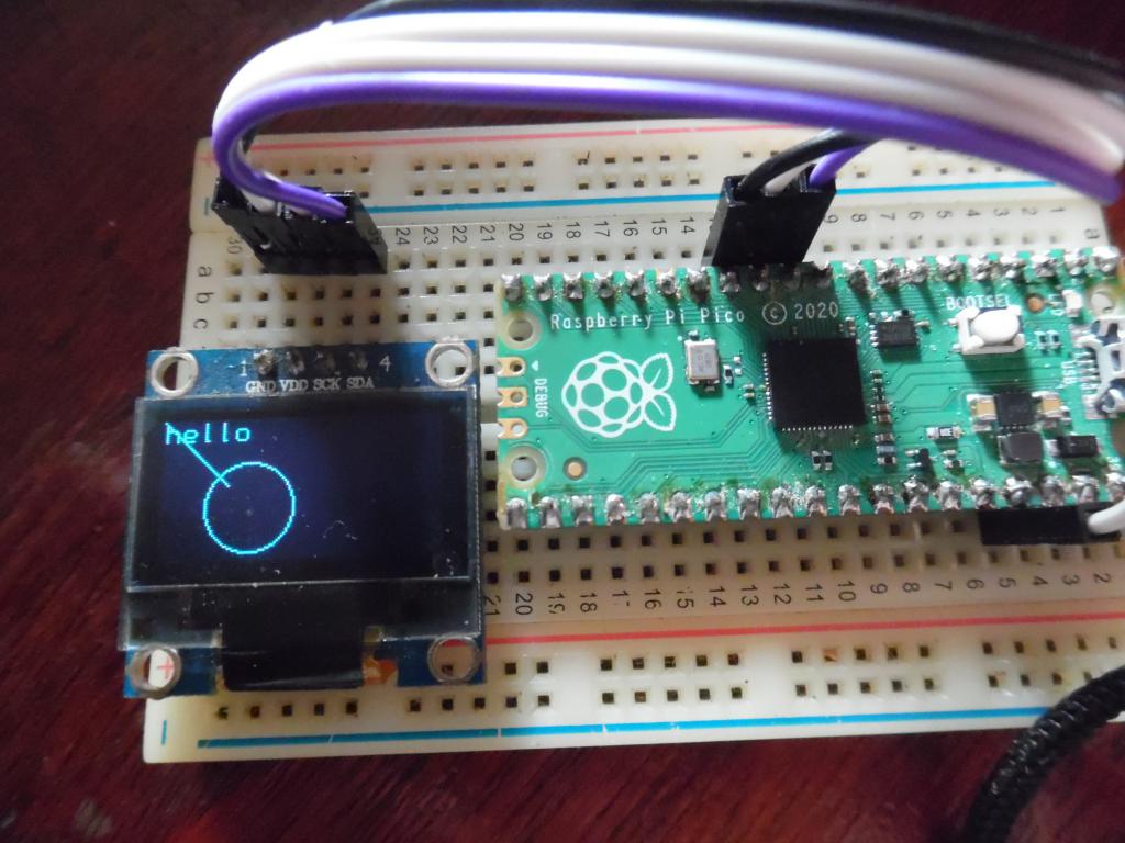

picomiteV5.07.07b2 sorted SSD1306 line and circle not working.
Thanks.

  stanleyella said  picomiteV5.07.07b2 sorted SSD1306 line and circle not working.
Thanks.
Just wondering which of these you mean:
picomiteV5.07.07b2 sorted SSD1306. Line and circle not working.
picomiteV5.07.07b2 sorted SSD1306 line. Circle not working.
The pic you posted seems to have a circle, though.
Also, posting the code probably makes sense.
Posted: 05:04pm 14 Jan 2023
It was a bug in the last release that ssd1306 had no graphics, only text but the beta made graphics work again.
I did post the code or this bug would not probably be fixed.

Confirm: all is good with phase correct PWM in PWM0 in beta 2.
