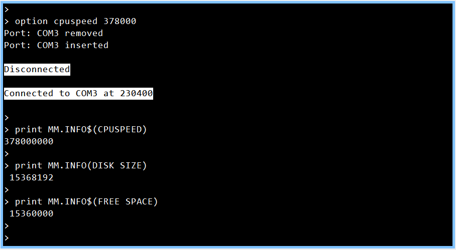

MM.Info(FILESIZE file$) seems to work as expected now. [The manual is still wrong regarding MM.Info$(FILESIZE file$)]

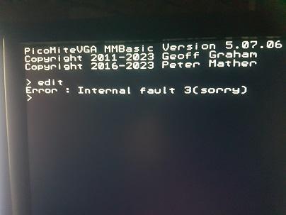

I have upgraded a PiPico VGA to firmware release V5.07.06 and loaded the Mandelbrot program and all went well until I tried to raise the CPUSPEED to the higher value as mentioned by Peter at this point the Pico crashed. I power cycled it and to check if the program was still alive I typed EDIT and I received the following error message:
I reloaded a new uf2 file but now the unit rebooted spazmodically a few times and now is bricked.
Any clues?

Posted: 06:57am 10 Jan 2023
Perhaps that particular unit does not like being overclocked that far. Try to load an old incompatible .uf2 thus forcing it back to default settings (any non-VGA one might work). Then re-try the latest version.

Posted: 07:26am 10 Jan 2023
You could try using the flash nuke program first.

Posted: 07:54am 10 Jan 2023
Found a copy of 5.07.04b8 loaded it and now it does seem to be stable.
Upped the CPU speed to 252000 and still stable. Guess this particular unit doesn't like being overclocked that far. I will try another Pico and see if I get better behavior.
Thanks for the feedback again guys.

Posted: 11:31am 10 Jan 2023
The guaranteed method of clearing this sort of problem is to load the firmware file https://geoffg.net/Downloads/picomite/Clear_Flash.uf2 which will reset the Pico to its factory fresh state, then you can reload the PicoMiteVGA firmware.

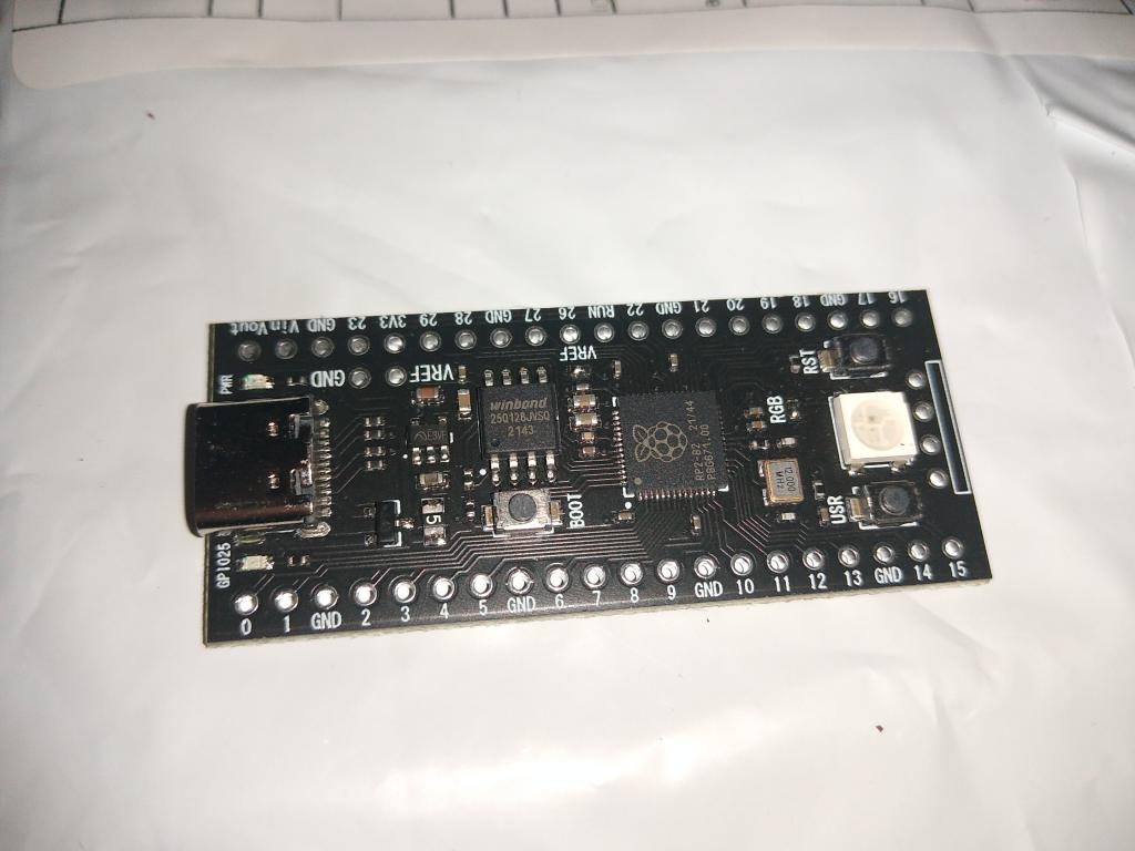

Posted: 01:38pm 10 Jan 2023
Working great, here
Tinine
Joined: 30/03/2016
Posts: 1646
Posted: 01:39pm 10 Jan 2023
Nice module

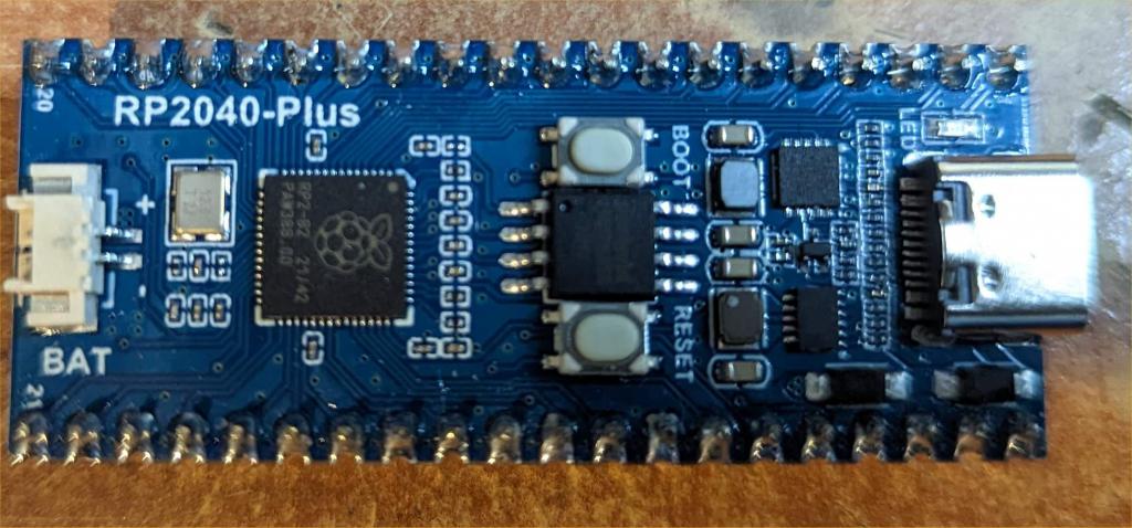

Posted: 01:59pm 10 Jan 2023
This is my favourite module
Waveshare RP2040-Plus
USB-C
Battery circuitry
Boot and Reset
16MB flash
total pin compatibility

Posted: 02:02pm 10 Jan 2023
I have been using these modules since last autumn. Tested several of th 4MB models without problems. 16MB version on their way from China.
+ USB-C connector
+ Lower price than the standard green ones
+ On board WS2812B RGB LED.
Pluto

Posted: 02:03pm 10 Jan 2023
I was refering to Tinine's picture.

Joined: 30/03/2016
Posts: 1646
Posted: 02:27pm 10 Jan 2023
Yeah, I got four....Didn't check re: pin compatibility though.

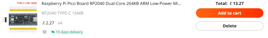

Posted: 05:08pm 10 Jan 2023
Hi Craig
Can YOU share a link? Which salesplatforem is this?
Matthias
