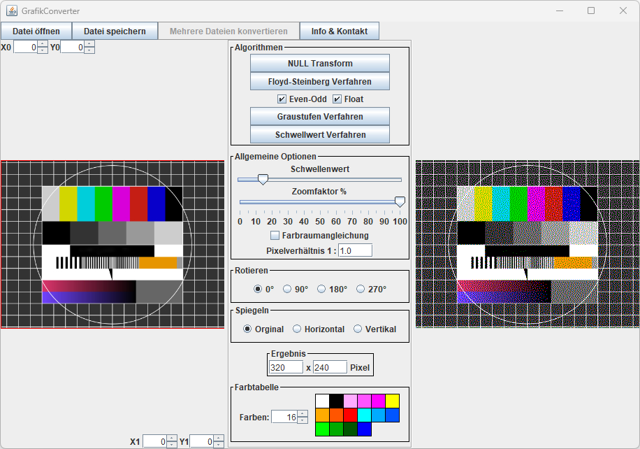

I have found the following tool: http://christoph.laeubrich.de/files/uploads/19/grafikkonverterv1_4.zip
Detail here: https://www.mikrocontroller.net/topic/92623   or also here https://github.com/laeubi/grafikkonverter-tool
Unfortunately you have to enter the 16 colors once as a palette at the beginning, this can also not be saved :-(
Maybe someone can do something with the sources ...
Results see attached.
London extracted from the input post. The bird and a test picture of me ...

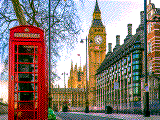

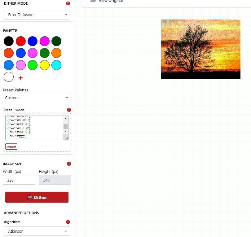

  homa said   _
I Think I've found the(by now) best solution.
Here is an Online Ditherer, where you can save (copy and Past) a Custom Color Palette and it dithers in many different ways:
https://ditherit.com/

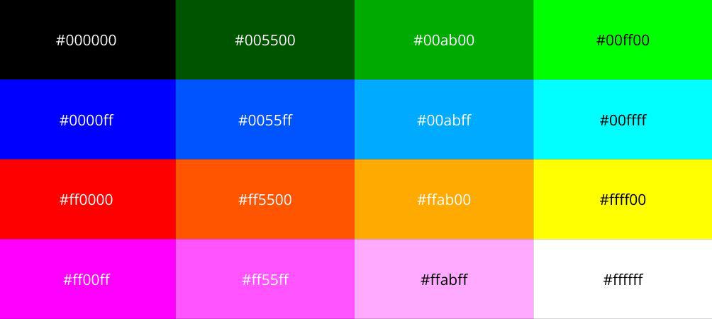

the Custom Palette for the Pico to past in looks like this:
[{"hex":"#000000"},
{"hex":"#FF0000"},
{"hex":"#0000FF"},
{"hex":"#FF00FF"},
{"hex":"#004000"},
{"hex":"#FF4000"},
{"hex":"#0040FF"},
{"hex":"#FF40FF"},
{"hex":"#008000"},
{"hex":"#FF8000"},
{"hex":"#0080FF"},
{"hex":"#FF80FF"},
{"hex":"#00FF00"},
{"hex":"#FFFF00"},
{"hex":"#00FFFF"},
{"hex":"#FFFFFF"}]

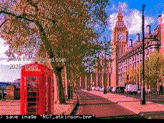

Here the london png with Atkinson dithering looks like this
Mart!n
Edited 2023-01-03 01:25 by Martin H.
'no comment

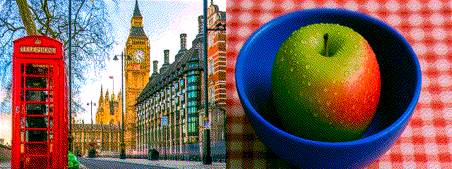

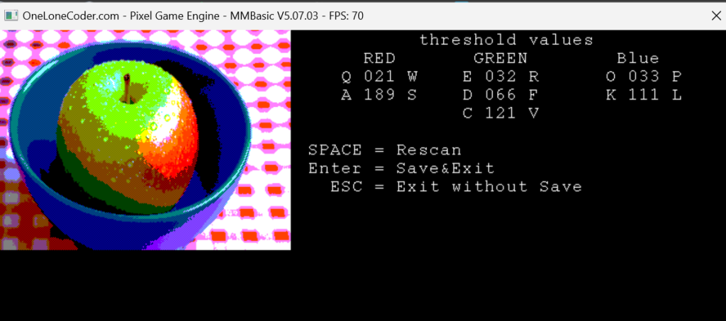

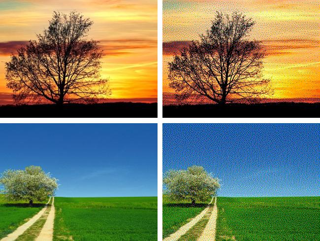

Posted: 08:46pm 13 Oct 2025

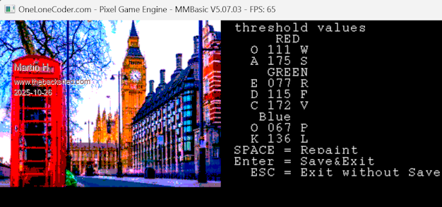

Working on the illustration for Colossal Cave Adventures has resulted in significant changes to my MMB 4 Windows tool.
The program now determines the color thresholds itself.
First, the statistical mean for each color (RGB) is calculated for 8x8 pixel blocks, then the median of this list is determined from all the values.
These values are used as the threshold values.
These values can be changed later using buttons.
becomes
'MMB4W Modes etc. Loads a source PNG and translatet it to 121 RGB BMP
'Enter Source Filename here
FN$="testapple"
Mode 1
dim w, h as integer
open FN$ + ".png" for input as #1
s$ = INPUT$(24, #1) ' Erste 24 Bytes holen (bis Ende IHDR-Header)
' Breite aus Byte 17-20 (Index 16–19 in MMBasic, da 0-basiert)
w = ASC(MID$(s$,17,1))*16777216 + ASC(MID$(s$,18,1))*65536 + ASC(MID$(s$,19,1))*256 + ASC(MID$(s$,20,1))
' Höhe aus Byte 21–24 (Index 20–23)
h = ASC(MID$(s$,21,1))*16777216 + ASC(MID$(s$,22,1))*65536 + ASC(MID$(s$,23,1))*256 + ASC(MID$(s$,24,1))
close #1
BL%=(h*w)/64
Dim integer listR(BL%)
Dim integer listG(BL%)
Dim integer listB(BL%)
cls
load png FN$+".png"
Prescan
Scan
ui
save image FN$+".bmp",0,0,w,h
end
sub Scan
for y=0 to h
   for x=0 to w
       cl%=0
       n=Pixel(x,y)AND &HFFFFFF
       '-->get Red
       r=n AND &HFF
       'Check red thresholds if value is in then dither
       if r>LR and r<UR then
        if (y mod 2)then
        R=255*not (x mod 2)
        else
        R=255*(x mod 2)
        end if
       end if
       inc cl%,255*(r>UR):n=int(n/256)
       '-->get Green
       g=n AND &HFF
       'Check green thresholds, no dithering
       select case g
       case >UG
       inc cl%,&HFF00
       case >MG
       inc cl%,&H8000
       case >LG
       inc cl%,&H4000
       end select
       '-->get Blue
       n=int(n/256)
       b=n AND &HFF
       'Check Blue thresholds, if value is in then dither
       if b>LB and r<UB then
        if (y mod 2)then
        B=255*(x mod 2)
        else
        B=255*not (x mod 2)
        end if
       end if
       inc cl%,&Hff0000*(b>UB)
       pixel x,y,cl%
   next
next
End sub
sub ui
Font 2
px=w+6
do
Print@(px,0);"           threshold values"
Print@(px,20);"      RED       GREEN        Blue"
Print@(px,40);"    Q ";make$(LR);" W    E ";make$(LG);
PRINT " R      O ";make$(LB);" P"
Print@(px,60);"    A ";make$(UR);" S    D ";make$(MG);
PRINT " F      K ";make$(UB);" L"
Print@(px,80);"               C ";make$(UG);" V"
Print@(px,100);
Print@(PX,120);" SPACE = Repaint"
Print@(PX,140);" Enter = Save&Exit"
Print@(PX,160);"   ESC = Exit without Save"
do :k$=inkey$:Loop while k$=""
k$=Ucase$(k$)
select case k$
case "Q"
if LR>0 then inc LR, -1
case "W"
if LR<UR then inc LR
case "E"
if LG>0 then inc LG, -1
case "R"
if LG<MG then inc LG
case "O"
if LB>0 then inc LB, -1
case "P"
if LB<UB then inc LB
case "A"
if UR>LR then inc UR, -1
 case "S"
 if UR<255 then inc UR
  case "K"
if UB>LB then inc UB, -1
 case "L"
 if UB<255 then inc UB
   case "C"
if UG>MG then inc UG, -1
 case "V"
 if UG<255 then inc UG
     case "D"
if MG>LG then inc MG, -1
 case "F"
 if MG<UG then inc MG
 case " "
 load png FN$+".png"
  Scan
case chr$(13) ,chr$(10)
  Exit SUB
 case chr$(27)
  End
end select
loop
end sub

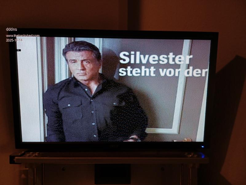

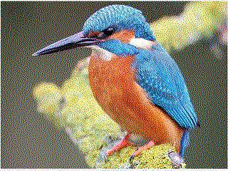

Fantastic thread, thank you all! I'm new to grafics and didn't have an idea how to get into that.
Special thanks @scruss:
  scruss said  A couple of other ways to make pre-dithered images using the venerable (okay, maybe just old) Netpbm toolkit:
1.) Ordered dither
djpeg london.jpg | ppmdither -red=2 -green=4 -blue=2 | ppmtobmp > london_ordered.bmp
Result:

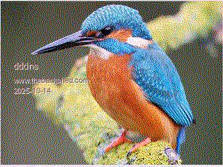

Under Linux all there is to do:
apt install libjpeg-progs
djpeg bird_orig.jpg | pnmremap -floyd -mapfile=<(echo P3 16 1 3 0 0 0 0 2 0 0 2 3 3 3 3 0 3 3 3 0 3 3 0 0 3 1 0 3 2 3 3 2 0 3 1 3 0 3 0 3 3 0 0 1 3 0 0 3 0 1 0) | ppmtobmp > bird_orig_FS.bmp
to have that wonderful result and that is exactly how it look on my unmodified VGA:
load image "b:bird_orig_fs.bmp" :  save image "pico_org.bmp"
Thanks a lot!!
Edit:
Weils soo schön ist:
Mode 3 @800x600
Edited 2025-10-14 08:47 by dddns

sub Prescan Accelerated many times (from 3-4S to 200ms) over and greatly shortened (Sometimes it doesn't hurt to look in the manual)
please replace with:

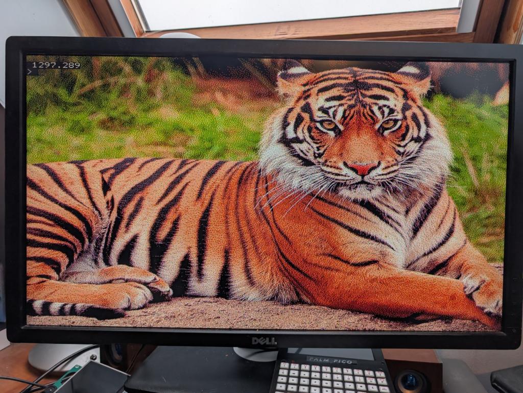

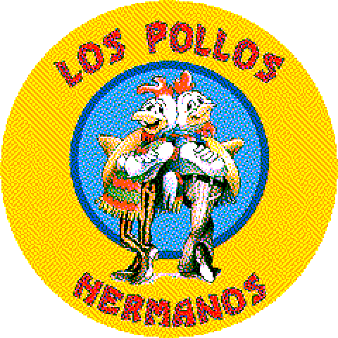

Posts: 12057
Posted: 11:11am 14 Oct 2025
Please don't take this the wrong way....
Here is an image on PICOMITE VGA RP2350 Mode 3 so 640x480 RGB121 standard palette
using the new command
timer=0:load dithered "b:/tiger640":?timer
As you can see it took 1.3 seconds to load and draw.
Here is the genesis of the command using CLAUDE
  Quote  write a function to read a bmp file. Assume the file fnbr is already open and you can read it using the function int IMG_FREAD(int fnbr, void *buff, int count, unsigned int *read)
buffer no more than 5 lines at a time. The maximum filesize is 1920x1080.
Write the file to the display using a dithering algorithm to optimise the visual effect. Accept as an input to the function a parameter that specifies whether the display is RGB121 or RGB332. Assume the bmp file uses standard non-compressed RGB888
  Quote  You can use the function DrawPixel(x,y,c) to write to the screen. No start or end frame calls are needed. The display size is HRes *VRes. Add parameters to indicate the x and y coordinates of the image that should map to 0,0 of the display. Ignore pixels in the image that would fall outside of the display.
DrawPixel takes an RGB888 colour so the RGB121 or RGB332 pixels should be expanded to RGB888 in order to call it.
Use (void *)GetMemory(size) to allocate buffer space and (void)FreeMemory(void *) to free it
  Quote  cast all the freememory functions to void * to avoid compiler warnings. Check for the correct bmp file format and raise an error if incorrect using the function void error(char *)
  Quote  To optimise writing you can use the function void DrawBuffer(int x1, int y1, int x2, int y2, unsigned char *p);
to output to the screen. In this case char *p is a pointer to an array of colour triplets R0,G0,B0,R1,G1,B1...Rn,Bn,Gn
  Quote  apologies it should have been colour triplets B0,G0,R0,B1,G1,R1...Bn,Gn,Rn
  Quote  Finally add parameters x_display and y_display that indicate the top left coordinates on the physical display where the image will be drawn
Total time to create the fully working new capability which will be in the next release - less than 1 hour. The world really has changed
Here is the code

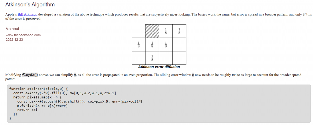

Atkinson Dithering
During the mid-1980’s, dithering became increasingly popular as computer hardware advanced to support more powerful video drivers and displays. One of the best dithering algorithms from this era was developed by Bill Atkinson, a Apple employee who worked on everything from MacPaint (which he wrote from scratch for the original Macintosh) to HyperCard and QuickDraw.
Atkinson’s formula is a bit different from others, because it only propagates a fraction of the error instead of the full amount. This technique is sometimes offered by modern graphics applications as a “reduced color bleed” option. By only propagating part of the error, speckling is reduced, but contiguous dark or bright sections of an image may become washed out.
https://tannerhelland.com/2012/12/28/dithering-eleven-algorithms-source-code.html
FN$="testapple"
' Atkinson Dithering v 0.94 - Korrigierte Randbehandlung
' Converts PNG Source Files to RGB121 BMP
' by Martin H. 2025 (with the help of the AI assistant)
Mode 1
' Read PNG header to determine image size
dim integer w, h
s$ = INPUT$(24, #1)
' Read width
w=ASC(MID$(s$,17,1))*16777216
inc w,(ASC(MID$(s$,18,1))*65536)
inc w,(ASC(MID$(s$,19,1))*256)
inc w,ASC(MID$(s$,20,1))
' Read height
h=ASC(MID$(s$,21,1))*16777216
inc h,(ASC(MID$(s$,22,1))*65536)
inc h,(ASC(MID$(s$,23,1))*256)
inc h,ASC(MID$(s$,24,1))
close #1
dim integer BL%=(h*w)/64
Dim integer listR(BL%),listG(BL%),listB(BL%)
cls
' Load source image
load png FN$+".png"
' Atkinson ring buffer (starts at index 0, goes up to W+3 for safety)
Dim integer RLine(W+3,3),BLine(W+3,3),GLine(W+3,3)
' START SCAN
for Ypos=0 to H-1
for Xpos=0 to W-1
n=Pixel(Xpos,Ypos)AND &HFFFFFF
R=(N AND 255):G=((N >> 8)AND 255):B=((N >> 16) AND 255)
' 1.GREEN (2 bits: 0, 85, 170, 255)
GV = G + GLine(Xpos, 1)
' Clipping (Zwischenwert)
if GV > 255 then GV = 255
if GV < 0 then GV = 0
' Quantization to 4 values (step size 85)
Index = INT(GV / 85 + 0.5)
' Palettenwert berechnen
CG = Index * 85
' Since the index is at most 3 (3*85 = 255), no additional clipping is necessary,
' but for robustness we leave it in:
if CG > 255 then CG = 255
GE = GV - CG ' Error is calculated from GV (intermediate value) - CG (pallet value)      GE = GV - CG ' Fehler wird aus GV (Zwischenwert) - CG (Palettenwert) berechnet
' 2.  RED (1 bit: 0 or 255)
RV=R+RLine(Xpos,1)
CR=0
if RV>128 then
RE=RV-255:CR=255 ' Error is negative, palette value is 255
else
RE=RV:CR=0 ' Error is positive, pallet value is 0
end if
' 3. BLUE (1 bit: 0 or 255)
BV=B+BLine(Xpos,1)
CB=0
if BV>128 then
BE=BV-255:CB=255
else
BE=BV:CB=0
end if
'Plot output pixel
Pixel Xpos,Ypos+h,RGB(CR,CG,CB)
' Prepare errors for distribution (1/8 share for all channels)
RE_EIGHT = RE/8
BE_EIGHT = BE/8
GE_EIGHT = GE/8
' ERROR DISTRIBUTION (Atkinson 1/8 kernel)
' 1. CURRENT LINE (Y) / RLine(F,1)
if Xpos < W-1 then ' (X+1, Y)
inc GLine(Xpos+1,1),GE_EIGHT:inc BLine(Xpos+1,1),BE_EIGHT:inc RLine(Xpos+1,1),RE_EIGHT
end if
if Xpos < W-2 then ' (X+2, Y)
inc GLine(Xpos+2,1),GE_EIGHT:inc BLine(Xpos+2,1),BE_EIGHT:inc RLine(Xpos+2,1),RE_EIGHT
end if
' 2. NEXT LINE (Y+1) / RLine(F,2)
if Ypos < H-1 then ' Only distribute if there is a next line
if Xpos > 0 then ' (X-1, Y+1) - Randprüfung für Index 0
inc GLine(Xpos-1,2),GE_EIGHT:inc BLine(Xpos-1,2),BE_EIGHT:inc RLine(Xpos-1,2),RE_EIGHT
end if
' (X, Y+1)
inc GLine(Xpos,2),GE_EIGHT:inc BLine(Xpos,2),BE_EIGHT:inc RLine(Xpos,2),RE_EIGHT
if Xpos < W-1 then ' (X+1, Y+1)

in case anyone's interested
Further improved version, green is now also dithered in 7 steps
g≤LG    Fixed color 0    Level 1: Black
LG<g≤LG_MID    Dither between 0 and G1    Level 2: Very dark green
LG_MID<g≤MG    Fixed color G1    Level 3: Dark green
MG<g≤MG_MID Dither between G1 and G2    Level 4: Medium green-dark
MG_MID<g≤UG    Fixed color G2    Level 5: Medium green
UG<g≤UG_MID    Dither between G2 and G3    Level 6: Light green
g>UG_MID    Fixed color G3    Level 7: Full green
' V2.1
FN$="london"
Mode 1
dim w, h as integer
s$ = INPUT$(24, #1) 'Get first 24 bytes (until end of IHDR header)
' Width from bytes 17-20
'Height from bytes 21–24
close #1

End sub
sub ui
Font 2
px=w+6
do
Print@(px,0);  " threshold values"
Print@(px,16); "      RED"
Print@(px,32); "   Q ";make$(LR);" W"
Print@(px,48); "   A ";make$(UR);" S"
Print@(px,64); "     GREEN"
Print@(px,80); "   E ";make$(LG);" R "
Print@(px,96); "   D ";make$(MG);" F"
Print@(px,112);"   C ";make$(UG);" V"
Print@(px,128); "    Blue"
PRINT@(px,144);"   O ";make$(LB);" P"
Print@(px,160);"   K ";make$(UB);" L"
Print@(PX,176);" SPACE = Repaint"
Print@(PX,192);" Enter = Save&Exit"
Print@(PX,208);"   ESC = Exit without Save"

Hi Martin,
That last picture you posted looks "darker" than earlier dithering examples.
Any reason why ?

@Martin,
I have a problem when transfering the pictures back to the PC when saved with PicoMiteVGA (colors/brightness change, maybe similar to your above darker picture).
But I will try to put them here anyway. However you should try it yourself on 6.01.00RC7
LOAD DITHERED "london.bmp",,,2
london_bmp.zip
The result (again, try on picomite + monitor, it looks much better that this).
Atkinson gives better result on smaller screens than Floyd. On a larger screen Floyd may be better.
Edited 2025-10-26 20:23 by Volhout
Martin H.
Joined: 04/06/2022
Posts: 1573
Posted: 10:58am 26 Oct 2025
Hi Volhout
  Volhout said  I have a problem when transfering the pictures back to the PC when saved with PicoMiteVGA (colors/brightness change, maybe similar to your above darker picture).
The prescan sub attempts to determine the average value for red, green, and blue. First, it adds the values from 8x8 pixel squares, then sorts the determined values and uses them to determine the threshold values. In other words, it uses the median.
If the result appears too dark, too light, or the wrong color, you can use the keys to adjust the threshold values.TIf i Like to avoid dithering, I set both values directly next to each other, i.e., the upper and lower thresholds to the same value.
However, it always depends on the source material which you work on.
For photos, I would prefer Atkinson, but for other images, such as graphics, I would prefer direct conversion with possible dithering, as with the conversion of PetsciRobots tiles and sprites.
Martin
Edited 2025-10-26 21:03 by Martin H.

Posts: 12057
Posted: 01:07pm 26 Oct 2025
Volhout - see the rc thread for a test VGA version dithering jpg direct to screen
