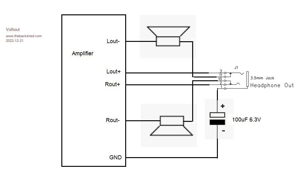

To use headphones on a bridge amplifier connect ground to ground and output L+ to headphone L via a 47uF cap. (+ to L+) same for right. You won't get the maximum volume as only one side of the bridge is being used, but in headphones it will still be enough.

@Phill,
This is what used to be in the walkmans. One or 2 tiny speakers and a stereo headset output.

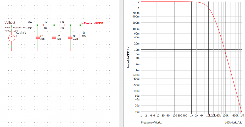

As for the input filter for up to 4 a 5 kHz, you will get decent performance using this (connect 330 ohm to PWM, R4 (10k) will be the volume potmeter. The maximum output voltage is 2Vpp.

  Volhout said  As for the input filter for up to 4 a 5 kHz, you will get decent performance using this (connect 330 ohm to PWM, R4 (10k) will be the volume potmeter. The maximum output voltage is 2Vpp.
Thanks @Volhout, but is this before the amp, or after the amp ... I assume before, in which case where does this "330 ohm to PWM" connect ?

Posted: 05:13pm 21 Dec 2022
In case you have 47nf, 15nf and 4.7nf...that will also work....

@Volhout, Thanks for the filter. Do you think it should have AC coupling to the amplifier?

  Turbo46 said  @Tom, ABACOM are the people who make it. You can download a free demo version but it won't save anything. Otherwise 49.90 Euro.
You can put capacitors in series or parallel for a temporary test setup if you like.
The class D amplifier board thatw as referenced to before has 1uF input capacitors.
AC coupling is on that board...

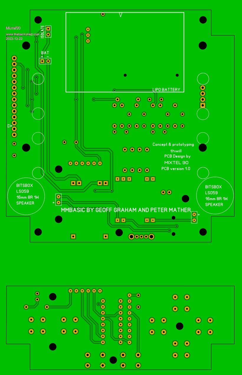

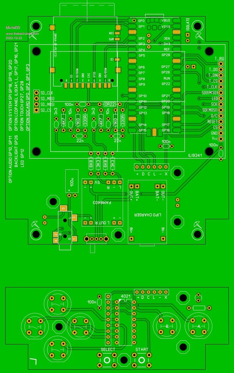

This needs quite a bit of tidying up. It's pretty much still work in progress, but now I'm happy that the bits will fit in the box. I'm not sure that going all SMD would gain much physically, although it would probably reduce assembly cost if several were being manufactured. I made the PicoMite surface mount anyway to save on height.
There's no Reset button and the Boot button isn't accessible with the display fitted.
The main PCB sits on additional 5mm spacers, giving a fraction over 10mm beneath it. That's sufficient to fit a 1500mAh LIPO battery in (8mm thick IIRC). There are no through-hole connections over it to cause damage.
On top of the main PCB, the display is on 11mm spacers. These allow for the usual plug-in connectors. Also on top is the buttons daughter board on 6mm spacers. This would probably have to be hard wired as I'm not aware of a plug-in connector to fit this space off-hand (although something may be possible). I've still not sorted out button tops for Select & Start.
If anyone would like to have a play with this I can supply the SL6 file if Tom is happy for me to do so - it's his project, not mine.
