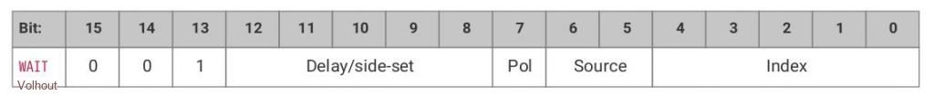

These bits have to be added in the DELAY field (refer to the picture in chapter 1 or chapter 2 on the SET command.
Set GP0 high, dly=19 = 111 10011 000 00001 = 1111 0011 0000 0001 = &hF301
Set GP0 low, dly=18  = 111 10010 000 00000 = 1111 0010 0000 0000 = &hF200

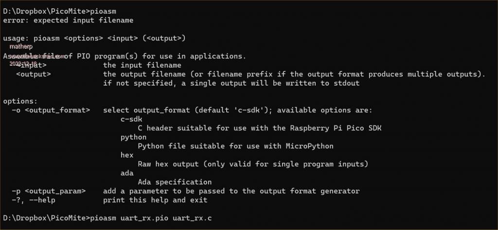

Posted: 10:35am 16 Dec 2022
Please find attached the official pio assembler. This takes a pio source file and generates the hex together with the c commands that set up the pins etc. May be useful at least as far as getting the correct machine code for your source
pioasm.zip
This is a command line executable (windows)
example source file from Pico examples

and the output
// This file is autogenerated by pioasm; do not edit! //

// uart_rx //
#define uart_rx_wrap_target 0
#define uart_rx_wrap 8
static const uint16_t uart_rx_program_instructions[] = {
           //     .wrap_target
   0x2020, //  0: wait   0 pin, 0

Posts: 3418
Posted: 10:56am 16 Dec 2022
Thanks, that will be very useful after I get a better understanding of the basics.

chapter 3.2
Up to now we have focussed on driving output signals from the PIO. But in many projects we would like the PIO to read inputs, to synchronize, or to change behaviour.
Synchronize.
A good way to synchronize is to WAIT until a input condition occurs, and then start executing. To evaluate the condition of a single input pin we can use the PIO WAIT instruction.
The fields have following function:
DELAY/SIDE SET - we already know how to use the delay field.
POL            - the polarity of the input signal we wait for to become true (0/1)
SOURCE         - how to select a source. We use 00 so any GPIO pin can be checked.
INDEX          - the pin number (i.e. 2 for GP2, 29 for gp29)
The input pin does not need to be configured. That is easy. It does not even have to be detached from the ARM processor. You can spy on the ARM IO. Just read any single pin and wait for it's condition to happen.
We can use that to start and stop the tonegenerator (500Hz). Somewhere in the loop we add the WAIT instruction to check if GP2 becomes high, and then continue with the loop. In pseudo code:
label:
wait gp2 to become high
set pin gp0 high + delay 1 cycle
set pin gp0 low
jump to label
The WAIT GP2=1 would assemble to
WAIT gp2=1  = 001 00000 100 00010 = 0010 0000 1000 0010 = &h2082
If you look at above pseudo code, you see that the gp0 pin is high 2 cycles, and low 3 cycles. For a nice square wave output, we should increase the delay with 1 cycle.
