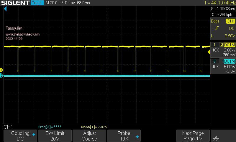

I have the worlds worst DSO (the wife downvoted investing in a good one until my 50th birthday) and with OPTION AUDIO GP0,GP1 configured and no sound being played I am seeing a square(ish) wave at ~11.2 KHz and a Vavr of 1.45V on GP0 & GP1.
What you are seeing is the pico setting the no-signal level to VCC/2 to avoid the clicks when audio starts/stops.
44.1kHz with the duty cycle changing to give the audio.
I think you do need to filter it to minimise the 44.1 kHz.

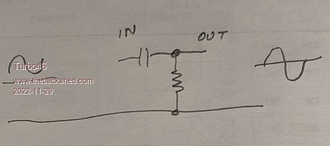

Tom, If Volhout's circuit is working then I would stick with that. The transistor is used to increase the drive capacity of the output pin. It is just switching 0's and 1's to the 'speaker', the speaker is effectively filtering out the high frequencies that it can't reproduce.
Using filter circuits and series capacitors won't work because using them you are feeding a switching transistor circuit with an analogue signal. The transistor is not used as an audio amplifier, its a switch and analogue signals below about 0.6 volts won't turn it on.
To use the filtered output, you need a more sophisticated audio amplifier circuit.
The series capacitor mentioned in the manual would be something like:
That would be used to remove the DC offset in the audio for an external audio amplifier that does not have series capacitor in it's input circuit. If the amplifier was DC coupled through to the speaker then it would have DC through the speaker and they would release the magic smoke.

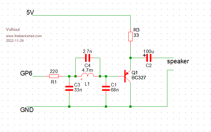

When you use the OPTION AUDIO GPx,GPy on the picomite VGA, it starts a 44kHz (not 11kHz) square wave output on GPx and GPy. When no other command is give this is a steady signal. When you PLAY a WAV file the 44kHz is modulated (meaning the waveform changes in narrower and wider pulses, maintaining the 44kHz (same frequency, it just looks different). Similar when you PLAY TONE.
I have no idea why this would behave different.
But... The simple audio interface you have will give sound, but it will not give good sound. If you want good sound from this loudspeaker, I suggest you implement my audio amplifier/buffer (yes this requires breadboarding, or soldering) consiting of filter to remove the 44kHz.
This is also the filter used in the VGA picomite. Added is a buffer (BC327) to drive the low impedance loudspeaker. The transistor is a PNP transistor.

PS your scope is presumably one of the little LCD versions? You are seeing sample aliasing if it is reading 11KHz (actual divided by 4)

  matherp said  PS your scope is presumably one of the little LCD versions? You are seeing sample aliasing if it is reading 11KHz (actual divided by 4)
But at least that is explained. In layman's terms does that mean the DSO simply can't sample fast enough to read a 44 kHz signal?

I'll build and try with @Volhout's circuit, turns out I do have the right inductor from when I didn't get around to building the PicoGAME 2.0. Though it does seem like a lot of audio circuitry for a simple handheld game so may just use raw PWM - are there downsides other than the single channel and crappy noise ?

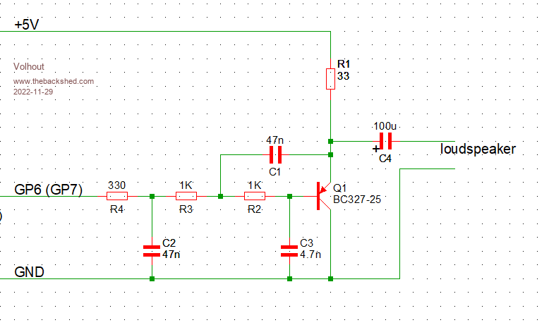

No inductors, try this ....
If you want to go cheap, remove C4, and connect the loudspeaker in stead of R1. But this may not be good for the speaker.
Check: C3 is 4.7nf, C2 and C1 are 47nf (10x larger value).
This will give you good audio up to 8 kHz (enough for game sounds). It is not as good as the inductor filter, but avoids the inductor.
And (not a hot topic here, but it is in my profession) it can be fully SMT. So cheap to get assembled by JLCPCB or who-ever.
Of coarse, if you want stereo, you need 2 of these. (as also with the previous design).
If you avoid any filter, it will generally upset cats and other animals the hear 44kHz. The 44kHz sound level is really high. If you connect to a HIFI amplifier, I would most certainly add the filter. In your hand held gaming toy, you may be able to do without a filter. The gameboy sounds of the 80's and 90's also got away with minimal filtering to the small toy speakers.
Edited 2022-11-29 21:49 by Volhout

Thanks @Volhout. What is the distinction between the BC327 in your earlier circuit and the BC327-25 in the latest circuit ?

BC327-25 / BC327
The "-25" indicates it is a part with a typical current gain (called "hfe") of 250x. Without the suffix you can get values from 100 to 400. Any will work in this application, but 250 is best.
No difference, it is just a symbol from my electronics simulation package.
You can use any PNP like BC327 BC328 2N2907 2N3904.
Maybe even BC557 BC558 BC559 (these are not really as good as the BC327/BC328 in this application on harmonic distortion, tested them before, but they will work).
You could even try BD136 / BD138 / BD140 (medium power transistors). Whatever PNP is in your toolbox. But for best performance the BC327...
