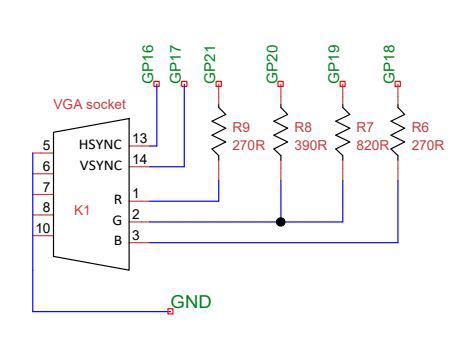

connecting to VGA is not a big deal
If you look at the circuit in Mixtel90s
PicoGame Mini 00 Construction Pack youll get it done
with just 4 Resistors
©Mixtel90
it works

  Martin H. said  connecting to VGA is not a big deal
©Mixtel90
it works

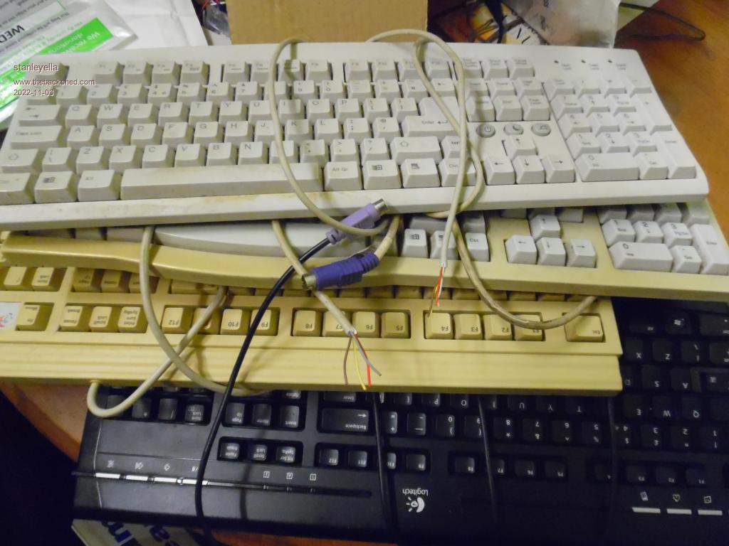

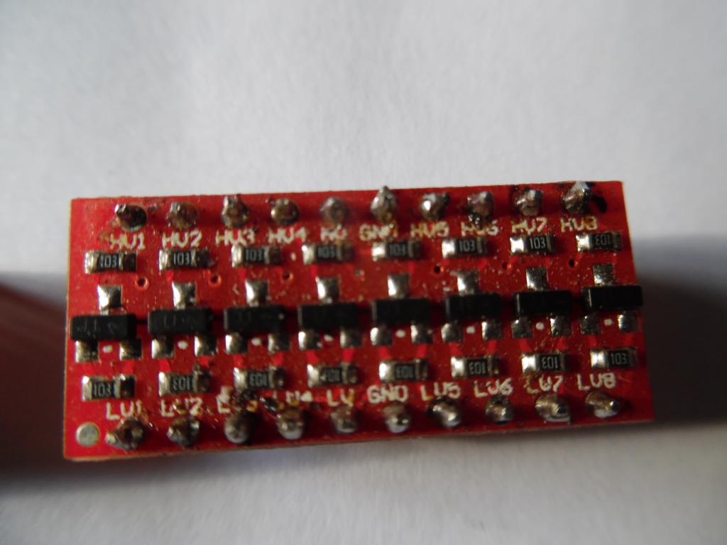

Looks simple for 16 colours, why not in "The manual"?
I will try that. I have 8 channel 3.3V to 5V bi direction boards for the key board.
I got 4 ps2 kb , 2 I cut the plugs off. Would they run at 3.3V logic? Power from 3.3V and see.. can not damage picomite that way or use logic level converter, which has 8 channels,  so useful for other devices. I will try tonight to get vga running.
SPI Lcd is impressive but I must try vga. Will I still be able to use mmedit or will it be vga terminal? I will see... I hope.

If you are lucky a PS/2 keyboard can be connected directly - but you have to be able to power it from 3V3. Keyboards that need 5V *have* to have a level shifter of some sort as they may contain pullups to 5V which will damage the Pico. Unfortunately you can't tell reliably which keyboards will work without trying them.
A level shifter can be two cheap mosfets and 4 resistors.

I have a few of these bi-directional logic level converters.
Nice for ili lcd with 5V logic like pic/arduino 328p.

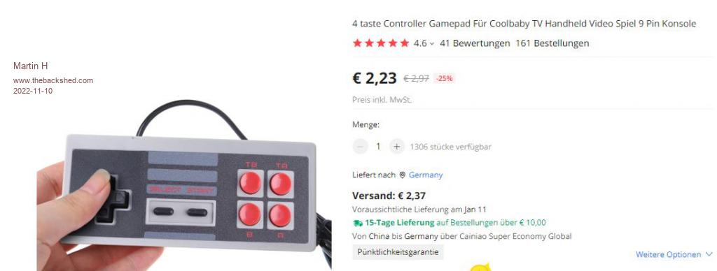

I've been smoke-testing my controller library so have taken liberties with Martin's code:
PicoGAME version with keyboard, NES and Atari joystick support: maze-pm.zip

I Use Mixtel90s PicoGame VGA Board V2.0 and the aliexpress "NES" Controller looks like yours
I used your Test Program , Atari Joystick works an A and B exept the Fire Button (allways triggerd)

That definitely looks like you have at least one short. I'm pretty confident about the code and it is rock solid on my 1.4 PCB.
That controller is cosmetically the same as the ones with the dodgy d-pads that often read up and right at the same time, but I don't think that would explain the symptoms.
I suppose it is possible that you are the only user to have actually tried a 2.0 PCB and that a gremlin got into that version - I certainly haven't populated one yet, but will do so tomorrow - Mick how about you ?
