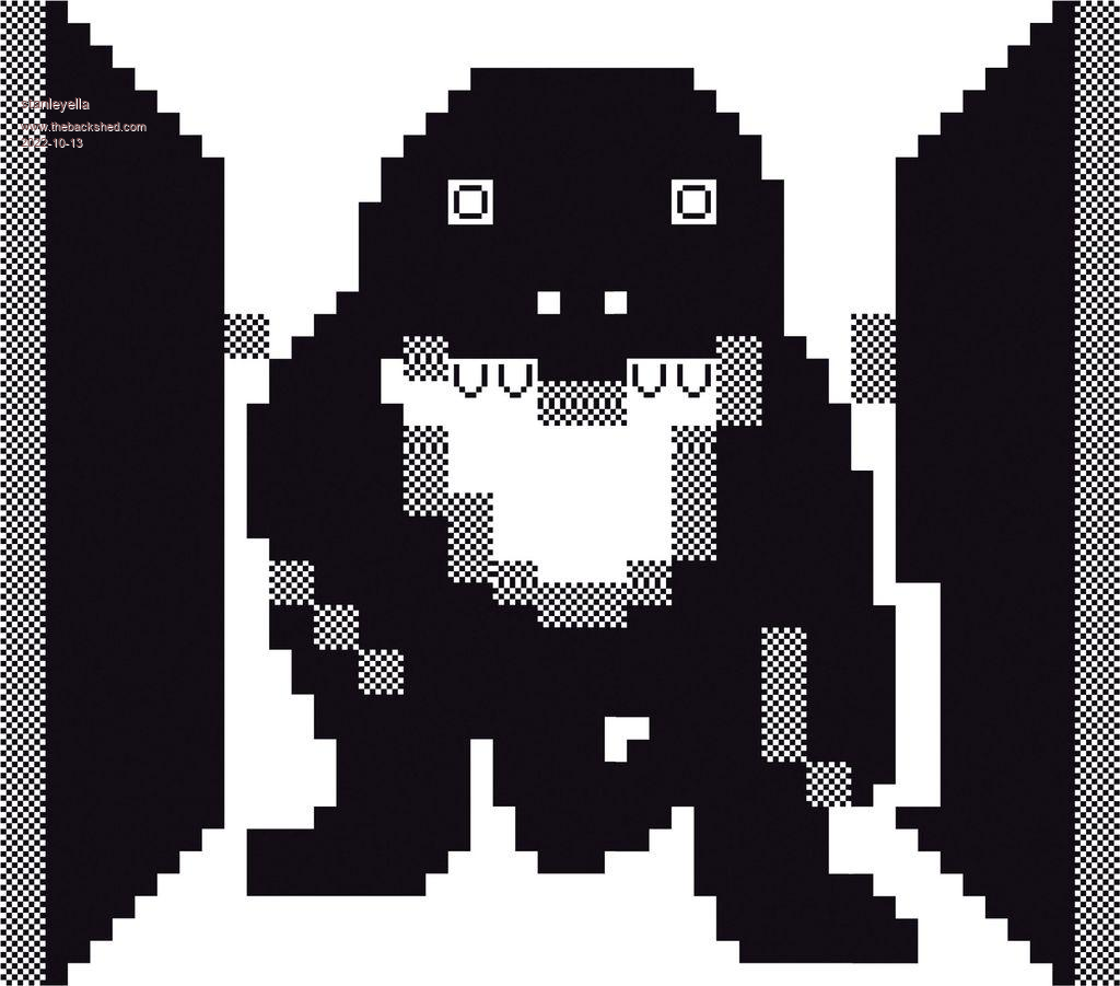

@ Martin H. char set for graphics? nostalgia?

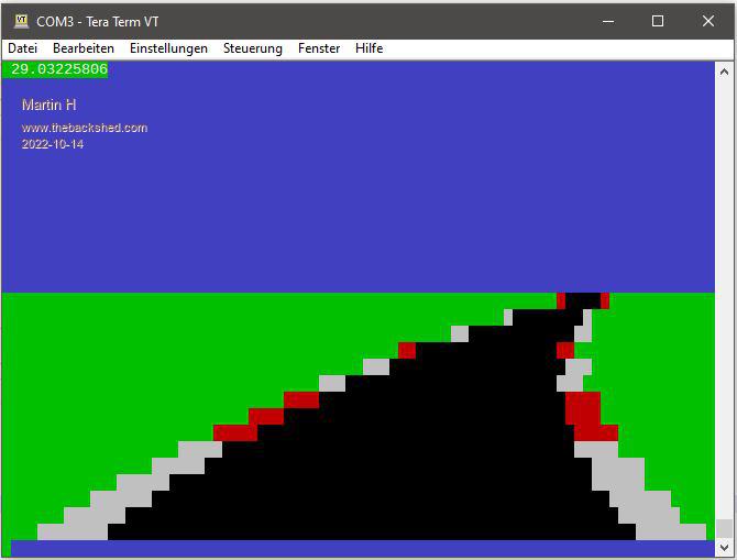

More Like this:
For PicoMite nonVGA
in Terminal..
(runs on a bare Raspberry Pico with MMBasic in VT100 Terminal)
CPUSPEED (KHz) 252000 (13.8 FPS @ 127000 KHz)
(will also run on PicomiteVGA in Terminal but much slower when the Line "Option Display SH%/8,SW%/4" is deleted and Prints garbage on the VGA Screen because it cannot process the VT100 escape sequences)
realy Nightly Build, as i woke Up at 3 AM
quick and dirty translated to VT100, sure there is room for improvements and optimizations
'VT_Road
Cur_off
Dim FC$(8),BC$(8),Xofs%(160)
Option Break 4: On Key 3, on_break
'SH% and SW% Displayresolution
SH%=240:SW%=320
dist%=0:Speed%=4:E$=Chr$(27)+"["
For f%=0To 7
FC$(f%)=E$+Str$(30+f%)+"m":BC$(f%)=E$+Str$(40+f%)+"m"
Next
'Precalculate the Curve
For f%=0 To 159:Xofs%(159-f%)=((160*Exp(f%/50))/20)-8:Next
Option Display SH%/8,SW%/4:' delete this Line on PicomiteVGA
Print BC$(4);:TCLS

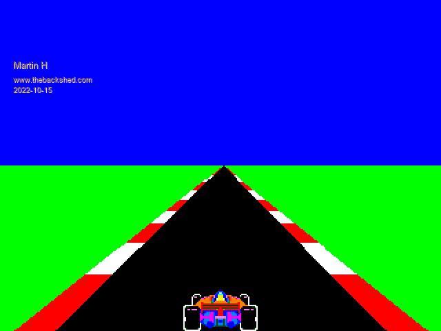

back to the original listing.
The empty road is a little boring.
For this reason I've done some Pixelwork and designed a car which can be integrated into the original listing.
Data uncompressed for better readability

Posted: 03:14pm 14 Oct 2022
  stanleyella said  Sprite read needs to be blit read for non vga mmb. I will try but it is a big sprite.
actually this are 2 Sprites in one... The right Side is a little different from the left Side.
Since the car is symmetrical, I only read half of the car with each sprite and then draw them once mirrored and once normal
I was too lazy to draw the sprite 2 times
Both Programs in combination it looks like this
Edited 2022-10-15 06:41 by Martin H.

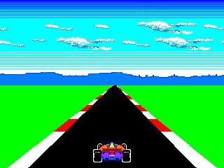

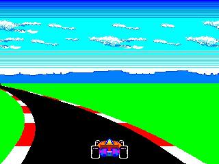

next evolution
added the Car and painted a Background
CPUSPEED 378000

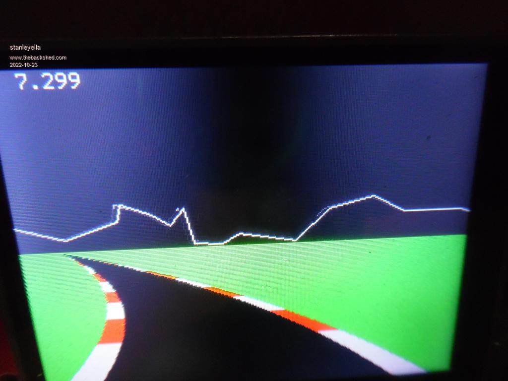

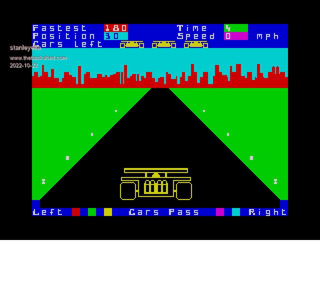

Posted: 08:24pm 22 Oct 2022
I get errors like
RUN
[100] Blit write #2,132,200,1
Error : Syntax
when usibg blit instead of sprite.
The available commands are:
BLIT READ #b, x, y, w, h
BLIT WRITE #b, x, y, w, h
BLIT LOAD #b, f$, x, y, w, h
BLIT CLOSE #b

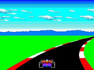

What fun!
Here's a modification to include a track.
At the very end is a data block that encodes the track. You can change it for any course you might like.
I'm not sure if I have the sky movement correct. I don't have an SD card connected, so I can't load the sky graphic to test.
autosave

A lot more to do to convert to non vga but the road works and I can redo the car as any sprite.. sorry blit.
Nice road code. Lots of maths to learn. I am impressed.
My version of scrolling was slow using blit but that was lcd.
Using blit read blit write was faster than using blit x1,y1,x2,2,w,h

Hi Stanley
  stanleyella said  I get errors like
RUN
Error : Syntax
BLIT CLOSE #b
ok, if the Version cannot Flip the Sprite/Blit you can modify the Read procedure and Flip them while creating:
Sub read_Sprites
Local nr%,p%,n%,byt$,m$
'--- Read/Create Sprites
Restore car
 For p%=1 To 31
  Read Byt$:Byt$=expand$(Byt$)
  For n%=1 To Len(Byt$)/2
   m$=Mid$(Byt$,n%,1)
   Pixel n%-1,p%,COL%(Val("&H"+m$))
   Pixel 56-n%,p%,COL%(Val("&H"+m$))
   m$=Mid$(Byt$,Len(Byt$)-(n%-1),1)
   Pixel n%-1,32+p%,COL%(Val("&H"+m$))
   Pixel 56-n%,32+p%,COL%(Val("&H"+m$))
   Next
 Next
Sprite read #1,0,0,56,32:Sprite read #2,0,32,56,32
Pause 5000
so you have 2 fullsize Sprites.
with little Changesin the do_car sub
Sub do_car
 If dist% Mod 2 Then
    Sprite write #1,132,200
 Else
    Sprite write #2,132,200
it should do the job
Mart!n
'no comment
