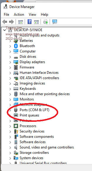

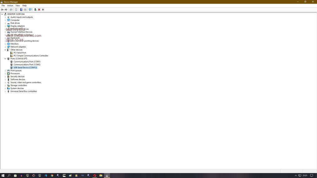

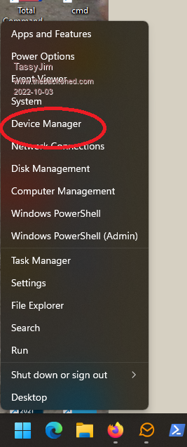

Try the 'normal' way:
Right click on the windows menu button (bottom left on your screen)
click on 'Device Manager'
expand the 'ports' line
Your Picomites will appear as USB Serial Device(COM9) where COM9 etc is the port number. Here I have 2 picomites connected on  COM4 and COM9
TeraTerm and MMEdit5 only list connected devices but the device might not be a picomite etc but a modem or Bluetooth etc.
In Putty, you have to enter the port number yourself.
You are fortunate that the picomite doesn't care about the baud rate.

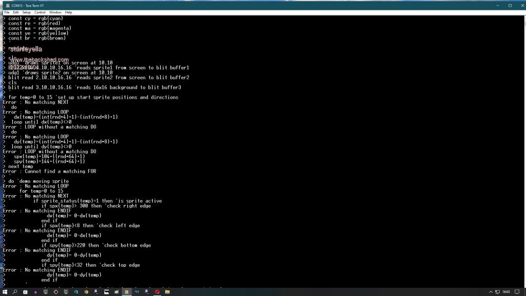

Pasted from mmedit to teraterm.

I ran
OPTION EXPLICIT
OPTION DEFAULT NONE
gui test lcdpanel
which is a command line command yet works in mmedit.

Control-C does work form TeraTerm.
MMEdit uses control-C as the first step in uploading a program so there is no difference there.
Stan has a problem with TeraTerm (or any terminal) that he doesn't want to solve.
That's his choice.
He will just have to live without any console output form his programs.
Very limiting but that's his choice.
  Quote  What problems would be evident using teraterm instead of mmedit please?
Error messages
Edited 2022-10-04 08:38 by TassyJim
Posted: 11:29pm 03 Oct 2022
  stanleyella said   What problems would be evident using teraterm instead of mmedit please?
The fact that (some time ago) you were connected to TassyJim's MMBasic device, not your local picomite, which would not have been possible with TeraTerm.
