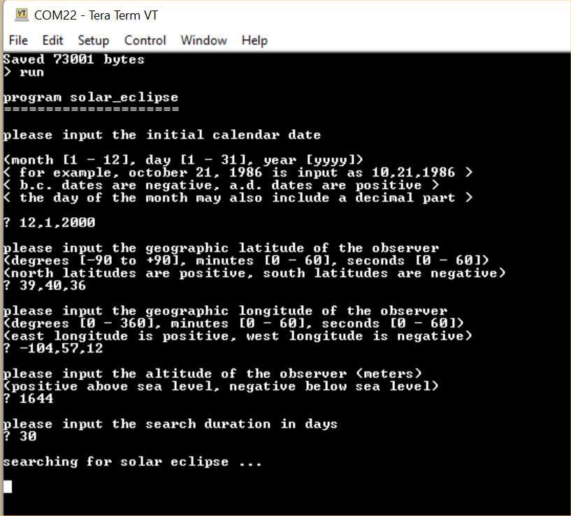

Posted: 06:14pm 29 Sep 2022
Worked perfectly when transferring/running 73000 byte file exactly as above (solar_eclipse) so you will need to try and find what you are doing that causes the problem in order for me to have a look

  matherp said  Worked perfectly when transferring/running 73000 byte file exactly as above (solar_eclipse)
Thanks Peter can you provide download/link to exactly that file so I can do some more investigation on my side over the weekend.
Posted: 06:23pm 29 Sep 2022
solar_eclipse.zip
