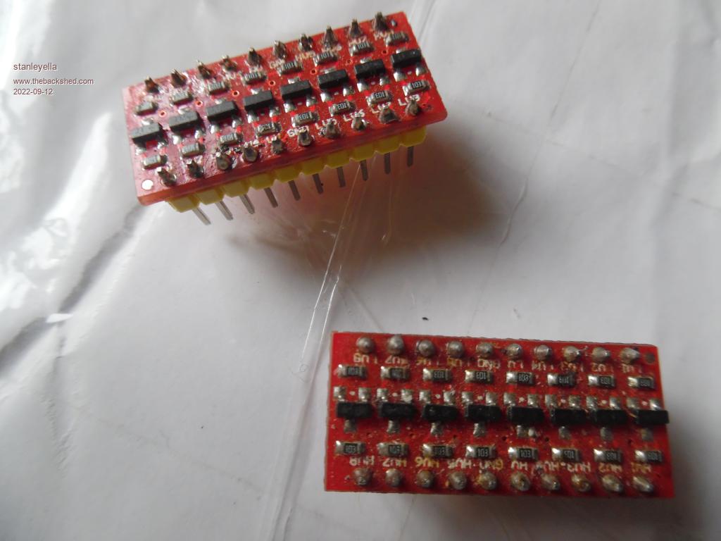

I use these as other pic stuff I do is 5V logic, usually.
Bi-direction logic 3.3V logic to 5V logic or 5V logic to 3.3V logic.
Not needed for pico display. Pics can run at 3.3V, Arduino it slows clock speed.
