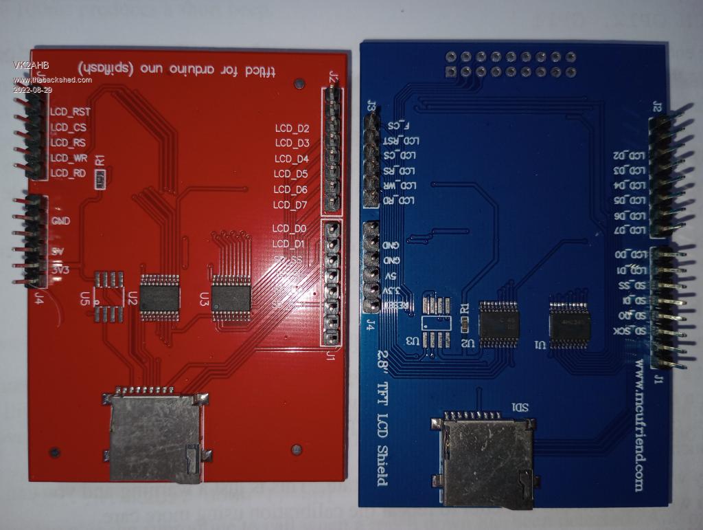

Another problem I have is the LCDs I'm using aren't labelled the same as on P47.
One is a MCUFriend (blue) , the other is tftlcd for arduino (spiflash) (orange).
Anyone using these?
Paul
Posted: 07:40am 28 Aug 2022
  Quote  One is a MCUFriend (blue) , the other is tftlcd for arduino (spiflash) (orange).
Pics? Then we can see if they are supported

Posted: 12:42am 29 Aug 2022
I upladed a photo, where did it go?
Paul
VK2AHB
Joined: 28/07/2022
Posts: 51
Posted: 12:45am 29 Aug 2022
I'll try again...
Posted: 06:56am 29 Aug 2022
Both these displays are wired parallel (not SPI) and are not supported on the PicoMite

OK, thanks for that. I'll have to give up until I get one (or two) that suit.

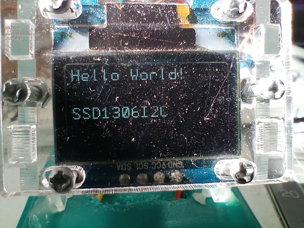

Posted: 12:09am 31 Aug 2022
Small Steps.
I tried connecting the ST7735 with CS, RST and RS but didn't work. I then hoped that I could configure the display as ST7735I2C but no luck.
I then dragged out the OLED display and confirmed that it was SSD1306I2C. It performed the Adafruit graphics test with the Arduino. So I plugged it in, configured it and got this!

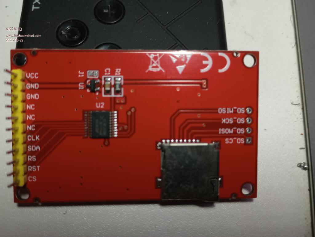

Posted: 10:11pm 04 Sep 2022
If I am looking at the correct image, your ST7735 is a 3 wire SPI display.
Connect SDA to MOSI and leave MISO unconnected.
You will be limited in some graphics capability because you can't read data from the ST7735 module.

Posted: 02:28am 05 Sep 2022
The VGA version of the picomite doesn't do LCD displays so forget anything you read there.
Start by clearing out any options you have set with
OPTION RESET
Then
OPTION SYSTEM SPI CLKpin, MOSIpin, MISOpin
where you tell the pico which pins you have chosen for CLK MOSI and MISO
Which pins you are using is up to you. There are a few choices.
The SD card, if used will share the SYSTEM SPI pins, you just have to tell the pico which additional pin you used for the CS.
OPTION SDCARD CS
Next it's the display:
OPTION LCDPANEL ILI9341, orientation, DCpin, RESETpin, CSpin
You choose which pins you use for DC, RESET and CS
Your panel doesn't have MISO available but it has to be specified under SYSTEM SPI. Connect SDA to MOSI and leave MISO unconnected.
There is also an optional backlight control pin which gets added to the OPTIONs
Its further down the manual under 'Backlight'
  Quote  ', backlight' can be added to the end of the configuration parameters
which specifies a pin to use to control the brightness of the backlight.
If your display does have the backlight pin, it may be 'inverted'
Once the display is configured try BACKLIGHT 50 to set it half way then try BACKLIGHT 90 or 10 to see which way increases brightness.
I don't think your module has a backlight control.
