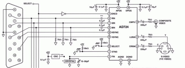

  matherp said  The AD724 handles PAL or NTSC depending on the Xtal used and position of a jumper.
The chip is now expensive from the likes of RS/Mouser (18GBP) but is available from China at cGBP2.
Nimue, if it would definitely be used in schools I'd be happy to do a simple PCB layout for a convertor motherboard.
You would have to run the VGA at 50Hz though. And interlace the video lines ? Or does the AD724 skip the odd lines in the odd frame, and even lines in the even frame of a progressive scan VGA signal ?

Mick--any interest in adding that AD724 composite circuit to your PicoStick instead of the 15-pin socket?
Edited 2022-08-16 01:52 by lizby
Posted: 03:53pm 15 Aug 2022
  Quote  Mick--any interest in adding that AD724 composite circuit to your PicoStick instead of the 15-pin socket?
Please don't - it does need firmware changes to make it work at the right frequency. Would do it for school use but not as a "might be nice-to-have"
I cant do the request justice - so even though I raised this, not worth the time / effort for me --- in my naivety I thought it would be a few timing tweaks and a couple of resistors.

I'll leave it alone unless there's firmware support. There wouldn't be any point.

The 50Hz / 60 Hz issue may not be such a problem.
Most screens new enough to have HDMI, VGA and Composite input are smart enough to sense and adapt to 50 or 60Hz composite input as well as PAL / NTSC (by detecting the colour carrier frequency).
Here I haven't seen a TV made in the last decade or two that can't do this.
They are made for the whole world market.
Edit
Going senile. Forgot about line interlacing, composite uses it but the PicoMiteVGA probably uses progressive scanning.
It is possible that some screens could detect it and adjust, but you need every one to work.
An external VGA to Composite converter would need a frame buffer to do this. I think the chip shown above needs an interlaced input, which a computer can provide through the graphics settings.
I imagine it would be a lot of work to change the firmware to get the odd lines on one field and even lines on the next to make a 25 or 30Hz frame rate.
And if memory serves, to get the two fields to mesh into a frame the first field needs to start and end halfway through its first and last lines. Otherwise they just overlap.
This was all done with just a couple of valves but now needs a chip with tens of thousands of transistors!
Edit 2
From AD724 the data sheet.
"Displaying VGA Output on a TV
The AD724 can be used to convert the analog RGB output from a
personal computer’s VGA card to the NTSC or PAL television
standards. To accomplish this it is important to understand that
the AD724 requires interlaced RGB video and clock rates that
are consistent with those required by the television standards. In
most computers the default output is a noninterlaced RGB
signal at a frame rate higher than used by either NTSC or PAL.
Most VGA controllers support a wide variety of output modes
that are controlled by altering the contents of internal registers.
It is best to consult with the VGA controller manufacturer to
determine the exact configuration required to provide an interlaced output at 60 Hz (50 Hz for PAL)."

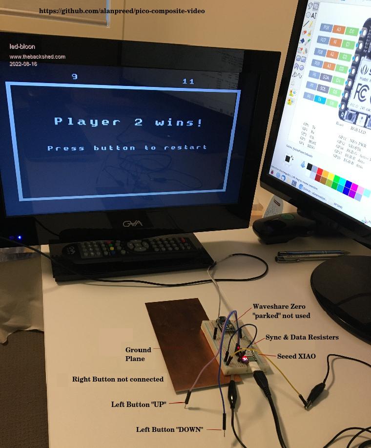

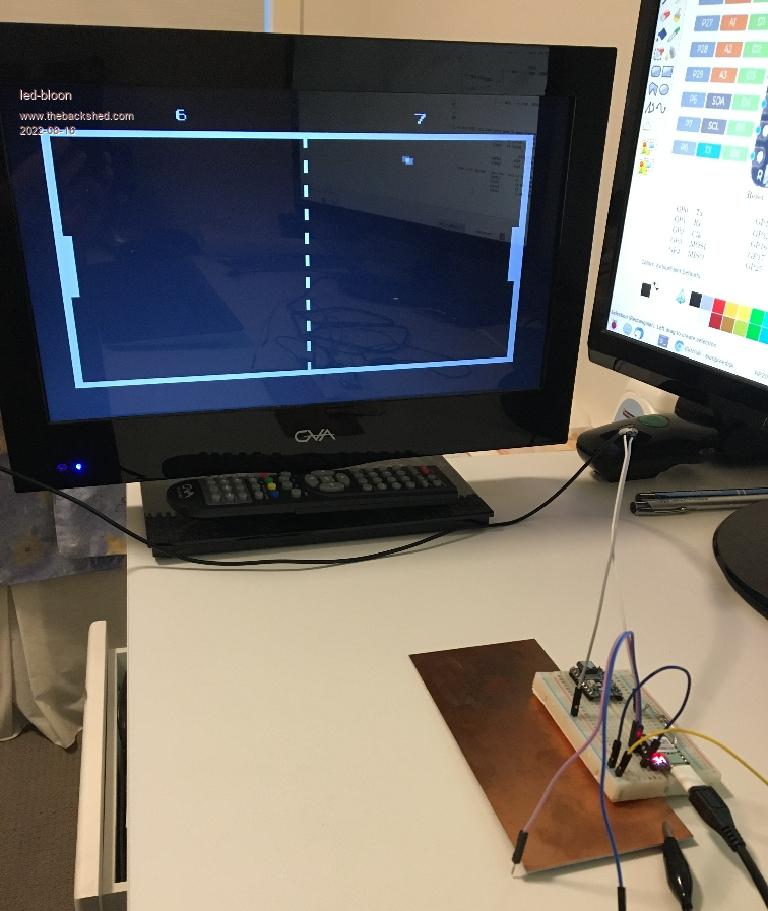

Composite video (B/W only) using 2 GPIO pins + 2 resisters thanks to Alan Reed
Implementing Composite Video
His example of a stand-alone game of pong using 1 pio block and 2 state machines.
I had to "fix" his CMakeLists.txt file for my RaspberryPi setup and once tested on a Pico
I moved across to the Seeed XIAO with subsequent changes to the GPIO pins used.
In all, a solid display and a "cute" version of pong (no sound!!)
