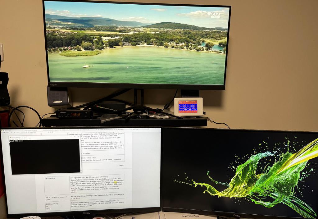

Hi Bleep, All,
The only line I added was RTC GETTIME
Spent half an hour playing with colours to end up near your default colour scheme
Beautiful job.
Here is a picture of near where its final resting place will be.

Hi bigmik,
What type is the display you are using?
Tony

Assuming you mean the TFT module, and not my 3 monitors, I am using an ILI9488 3.5" 14pin SPI module.

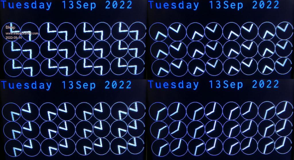

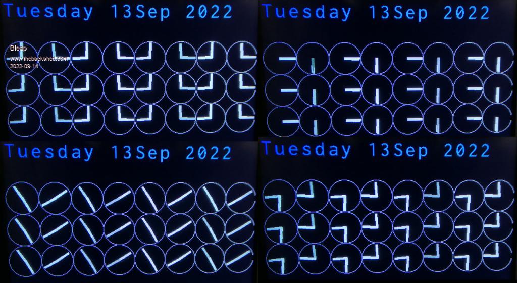

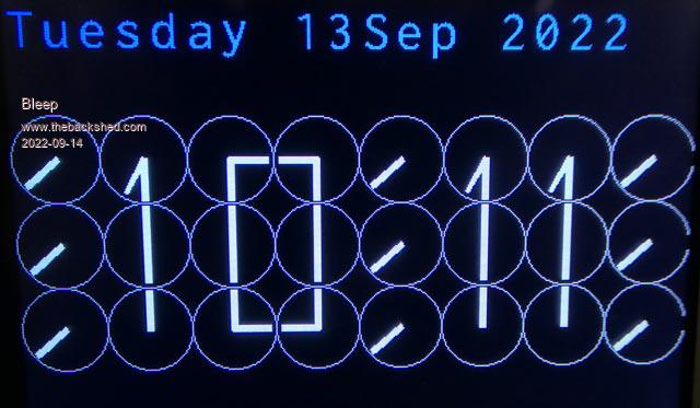

A few pictures for the new number layout and some of the various animations.
This shows the new layout when a '1' digit is being displayed.
Some shots of the clocks in mid animation.
Regards Kevin.
