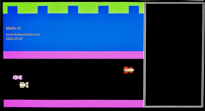

Posted: 12:24pm 06 Jul 2022
well from my point of view, PicoVaders is finnished..
Thanks to Volhout for doing the adaptations To PicoGAME board.
(I can't test it right now  because i dont own one)
I'm just experrimenating with the SetTick function and I'm thrilled.
This opens up further possibilities for the next project
Edited 2022-07-06 22:26 by Martin H.
