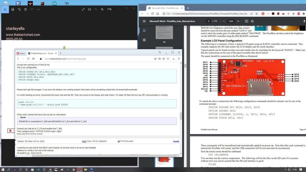

Posted: 04:38pm 30 Jun 2022
Matherp. Your setup is different from the manual. I will try your wiring.
Posted: 04:44pm 30 Jun 2022
  Quote  Matherp. Your setup is different from the manual.
Mine is based on a little I/F PCB that Mixtel designed - no wiring so no risk of errors. One thing I forgot to mention is to test your Dupont wires. I have had these where the crimp was round the sleeving and there was no end-to-end connection and others where the crimp had broken the copper but the sleeve was intact
Posts: 9265
Posted: 04:46pm 30 Jun 2022
The OPTION commands allow pins to be "moved around" on the PicoMite, so it's not unusual to see different pins used on different setups. e.g. there are two SPI ports, both of which can appear on several different pins and will still work identically - if the OPTION commands are correct, that is.
As far as MMBasic goes the PicoMite is unique (so far) in the way that pins can be configured in this way. It makes laying out a PCB much easier when pins aren't dedicated to a particular function.
Duponts - took me ages to be able to crimp them with any reliability. :(  I finally ended up using a simple mechanical tool rather than automatic crimpers. Now I just have trouble *seeing* the darn things!
Edited 2022-07-01 02:49 by Mixtel90
