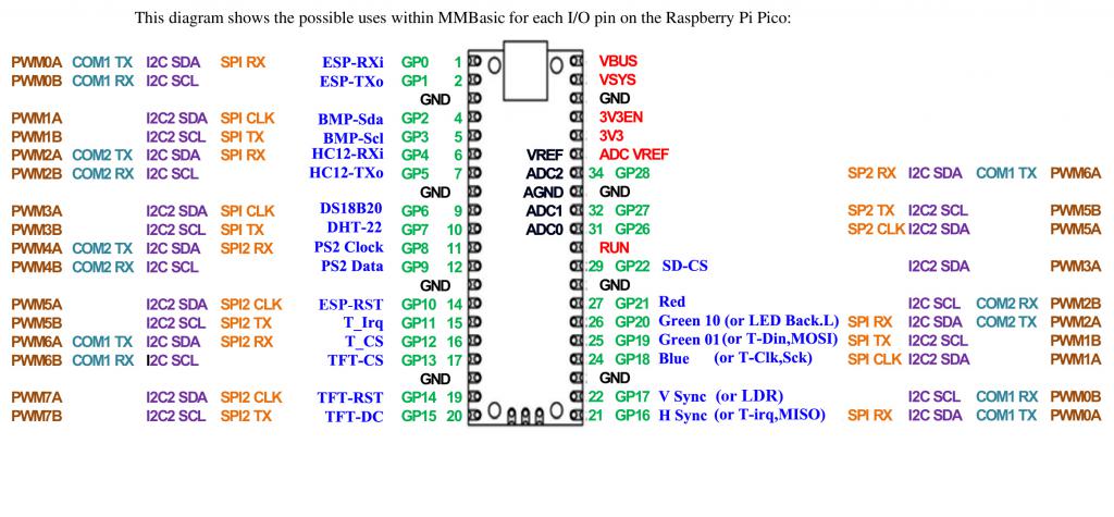

Posted: 12:34am 28 Jun 2022
Hi Phil,
Yes they are (the ILI9488 needs it) but for the test I referenced above I soldered a wire to reinstate the MISO to the TFT.
Posted: 12:59am 28 Jun 2022
Hi All,
@Lizby,
MISO (master input, Slave Output) goes to both the touch pins and the tft pins, removing the pin as I did only removed MISO from the TFT pins, the touch still has MISO else it couldn’t communicate touch data back to the CPU, for the test I did I rejoined the MISO line to the tft (wire from the tft to the pcb it is fitted to)
@Gerry,
I am happy to do the test read the requested data if you can provide some sample code (you know I am pretty lame at programming) and also should I have an LCD PANEL option set or not set to run the code?
I have been working In Conjunction with another ‘shedder, on a new design pico product that I will share details of on TBS soon. I found a few minor problems with both boards it is a 50mm x 50mm pcb for TFT use with a plug in daughter board 20mm x 50mm if you want to use it as a vga/PS2 board. This makes a VERY small footprint for a mini VGA pico PC. Also I have been using my CNC to cut fascia panels out of blank wall plates (same size as light switches) to house my new board to be the home unit for a weather station.
News on these will be posted soon, the boards were mainly to be for the other ‘shedder and mine use but will be available on request if there is any interest.
Once I finalise the cnc files I will also post them for others who might want the same. BTW the cnc is for the 3.5” ILI948x displays hence why I tried the display in question in this thread.
The Pico Pi has sparked my interest in mites again as they are cheaper and more readily available than the MX170 plus it already has USB and 5V to 3v3 power supplies

F4 H7FotSF4xGT
Posted: 01:46am 29 Jun 2022
Hi All,
@Gerry,
Thank you for that quite extensive program.
I ran it on my ILI9341 to see if I get the same result as you but It (from my understanding) fails the TFT chip read test
This is the result I get with an ILI9341 (I tried two different ones a 2.8" and a 3.2")
> RUN
Hard Reset
Send NOP
Soft Reset
ID &H04 HEX
0
0
0
0
TEST TOUCH CHIP
Read TEMP1
845
Read TEMP2
995
I changed the configuration for my setup as follows:
'MICKS CONFIGURATION
LCD_DC=MM.INFO(PINNO GP15)
LCD_RST=MM.INFO(PINNO GP14)
LCD_CS=MM.INFO(PINNO GP13)
SD_CS=MM.INFO(PINNO GP22)
T_CS=MM.INFO(PINNO GP12)
T_IRQ=MM.INFO(PINNO GP11)
MYSPI=1   '2 id using spi2 pins
SPITX=MM.INFO(PINNO GP19)
SPIRX=MM.INFO(PINNO GP16)
SPICLK=MM.INFO(PINNO GP18)
I have checked and triple checked I think I set all of the PINNO correctly. This is the list of the Pin Allocation on my PCB. Note My allocations are in Dark Blue
The Result with the ILI9488 returned a very similar result, the only difference was the TEMP values which were close but a few numbers off
I think the RESET/ID &H04 HEX should not return all 0 for all four positions
Is there some other setting I need to make in your code?
