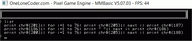

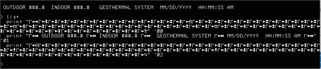

Posted: 12:43pm 21 Jun 2022
Suppose I want to print this with MMBasic for Windows:
? OUTDOOR ###.# ? INDOOR ###.# ?  GEOTHERMAL SYSTEM ? MM/DD/YYYY  HH:MM:SS AM ?
I load the program:
print "???????????????????????????????????????????????????????????????????????????????"
print "? OUTDOOR ###.# ? INDOOR ###.# ?  GEOTHERMAL SYSTEM ? MM/DD/YYYY  HH:MM:SS AM ?"
RUN, then LIST gives me this, with the characters over 127 stripped out:
I can get the box characters with this:  print chr$(201);: for i=1 to 76: print chr$(205);: next i: print chr$(187)
 print chr$(186);: for i=1 to 76: print " ";: next i: print chr$(186)
 print chr$(200);: for i=1 to 76: print chr$(205);: next i: print chr$(188)
Is there some code page or other magic I can use to make the straight print of the PC graphics characters within a quoted string work?
(I feel like I asked this same question several years earlier in a slightly different context.)
Posted: 01:16pm 21 Jun 2022
  Quote  Is there some code page or other magic I can use to make the straight print of the PC graphics characters within a quoted string work?
No: Characters over 128 are tokens so can't appear in a program

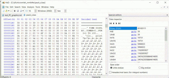

Posted: 02:32pm 21 Jun 2022
  thwill said  Three other options:
Tom -- I think I've done one form or another of all three of those options.
But I have a question for you (or anyone else). The files which Paul has sent me which show up as proper PC graphics drawing characters have those characters actually encoded as UTF-8 triplets, where the first 2 characters are 0xE295 and the third designates which E295 character is encoded. (Looking with the hex viewer HxD.)
How do I save this file so that the 3 characters are converted to the appropriate 1-character above-127 value?

Posted: 02:46pm 21 Jun 2022
  lizby said  How do I save this file so that the 3 characters are converted to the appropriate 1-character above-127 value?
Not something I've ever done, and also I don't recognise 0xE295 as being particularly magical from what I have done with UTF-8.
I suppose it may depend on exactly what code-page you mean by "PC graphics drawing characters".
Can this help: https://www.motobit.com/util/charset-codepage-conversion.asp ?
Could you attach an example file ?

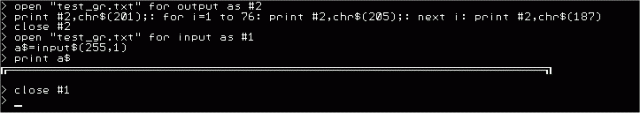

  Mixtel90 said  AFAIK MMB4W doesn't know anything about UTF
That's why I want to convert from UTF to a straight 8-bits per character format. Then I can play further to see how to deal with it.
So, a file written by MMB4W with the graphics characters in it can be read back and printed and they print correctly:
So my question is, how can I write a UTF-8 encoded file so that it's just plain 8 bits per character?
Edited 2022-06-22 00:55 by lizby
Posted: 02:58pm 21 Jun 2022
I'm confused because I don't think 0xhE29590 is a valid UTF-8 sequence, for a start 0xE2 <= 0x7F so would be interpreted as plain ASCII and can't introduce a UTF-8 sequence ... I'm no expert though and may be talking bo**ocks.
Edited 2022-06-22 00:59 by thwill
Posted: 03:05pm 21 Jun 2022
  thwill said  I'm confused because I don't think 0xhE29590 is a valid UTF-8 sequence, for a start 0xE2 <= 0x7F so would be interpreted as plain ASCII and can't introduce a UTF-8 sequence
Uhh, I think 0xE? is greater than 0x7?. But I'm confused too.
Edited 2022-06-22 01:06 by lizby
Posted: 03:10pm 21 Jun 2022
Oh, sorry, yes ... you are correct and I'm tired, 0xE2 can start a UTF-8 sequence.
Could you just post a sample file ?
Edited 2022-06-22 01:20 by thwill

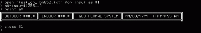

Posted: 03:25pm 21 Jun 2022
Now we're getting somewhere--thank you very much, Tom. That conversion site did the trick--convert UTF-8 to ibm852.
So UTF-8 text (if the forum doesn't do something to it)
converts to ibm852
ษอออออออออออออออหออออออออออออออหออออออออออออออออออออหอออออออออออออออออออออออออป
บ OUTDOOR ###.# บ INDOOR ###.# บ  GEOTHERMAL SYSTEM บ MM/DD/YYYY  HH:MM:SS AM บ
ฬอออออออออออออออสออออออออออออออสออออออออออออออออออออสอออออออออออออออออออออออออน
And if I read it in to MMB4W with "a$=INPUT$(255,#1): PRINT a$", I get this:
Again, thanks very much, Tom. I think this puts me on a path to further investigation.
Edited 2022-06-22 01:31 by lizby

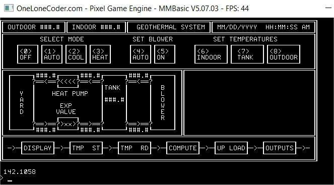

Posted: 11:17am 22 Jun 2022
  thwill said  You read in bytes from the file and feed them through a finite state machine that parses the 2,3 and 4 byte UTF-8 sequences . . .
But with the conversion to ibm852 (one-time), you don't need to do anything if you have a file to read. Easy-peasy:
(The 142 at the bottom says the program is clearing the screen and writing it 100 times in 142 milliseconds.)
