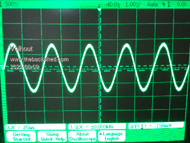

Oh Tom,

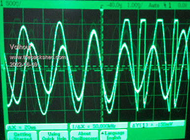

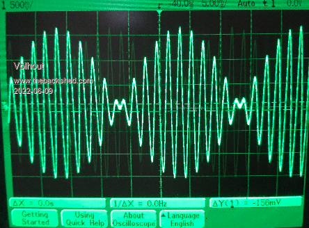

Here you go.
This first picture is a single tone (play sound 1,b,s,500). Each horizontal grid line on screen is 0.5V, so the amplitude of the sinewave is 3.2 x 0.5 = 1.6V.
When you add the second tone (play sound 2,b,s,550) the signal is added to the first. If you add up 2 sinewaves with different frequency there will be moments in time where the voltage is summed up, but in other moments the 2 cancel eachother out. (you can try on MMBasic by drawing a graph of 2 added sinewaves with different frequency)
In this graph you can see that the sum of both sinewaves has an amplitude of over 3V. And this is generated by the PWM on the output pin of the pico. This pin has only 0V and 3.3V levels. So it is at it's max.
The next waveform is what happens if you add a 3'rd sine wave. (play sound 3,b,s,600) The signals sum up to 4.5V, and the pin can only drive 3.3V. What happens is that you get a numerical "wrap around" for +3.3V to 0V. You can clearly see that in the right side of this (zoomed in) waveform. At some point the signal is clipping at 3.3V, and at some point there is a wrap around to 0V. This is an immense distortion that sounds like chirps, with a repetition rate of few Hz. If you add a 4'th it is only getting worse.
Please note that the waveforms will not look as nice as these on your VGA pico GAME board. My picomiteVGA has a better 44kHz filter (sampling rate of the audio), so the PWM frequency is almost invisible in the waveform. There was a discussion on that in the VGA pico GAME board thread.

Posted: 11:08am 10 Jun 2022
Thanks @Volhout,
Something is confusing me though, in the first plot if the horizontal lines are at 500mV intervals then it looks like the peak-to-peak voltage is ~1.6V, doesn't that make the amplitude ~0.8V ?
Posts: 3418
Posted: 12:21pm 10 Jun 2022
After a DC blocking capacitor the peak amplitude is 0.8V but for clipping of the PWM signal the Peak-to-Peak amplitude is what matters.

Posted: 01:58pm 10 Jun 2022
  thwill said  Thanks @Volhout,
Hi Tom,
There are several ways to define the amplitude. Most common are
- peak to peak voltage
- rms voltage (for a sine wave that is 1/(2*sqrt(2)) of peak to peak)
And you are right: the "amplitude" is indeed 0.8V (according WIKIPEDIA)
To avoid confusion I mostly add a suffix. This case I did not....
For this sine wave:
Vp would be the 0.8V
Vpp would be 1.6V
Vrms would be 0.57V
Edited 2022-06-11 00:01 by Volhout
Posts: 9265
Posted: 03:09pm 10 Jun 2022
In this case it's Vpp that matters because you are interested in clipping (and it's usually easier to think Vpp on a scope anyway). Nice scopes will display the RMS as well, but not all will do that - you have to work it out if you need it.

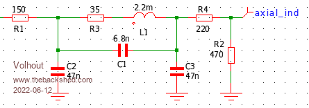

Posted: 03:09pm 11 Jun 2022

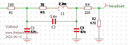

Please can you post the latest version of your audio filter. I  would like to incorporate it in a new version of the VGA PCB. Thanks

Posts: 6206
Posted: 06:43pm 11 Jun 2022
  matherp said  Volhout
Hi Peter,
The filter I reworked on my version of the PicomiteVGA board (your layout) is this:
Theoretically the 5.6nF capacitor should be 6.2nF, but that value is hard to get. If you have sufficient place on the board you could parallel layout 4.7nF and 1.5nF. But board area will be difficult anyway, since the inductors are like large resistors.
The 35 ohm resistor is internal in the inductor (wire resistance), so it is not a separate component.
The BOM would be:
2.2mH inductor Farnell 608622
5.6nF 5% capacitor Farnell 1702663
47nF capacitor Farnell 1100392
180 ohm resistor Farnell 1700227
220 ohm resistor Farnell 1700228
470 ohm resistor Farnell 9343245
The output can drive a 32 ohm headset, but can also connect to a stereo amplifier (0.5Vrms). The frequency response is up to 19kHz, so HIFI is definitely possible (play WAV from SD card).
I also experimented with a amplifier circuit, which uses more common components (no inductor, and more common resistor and capacitor values) but that takes even more board area, and uses 5V. The 5V can be dirty, so I propose to use the above circuit. Compact and simpel.
Edited 2022-06-12 04:49 by Volhout

I'd used the 1.5mH inductors whem I laid it out. I've just re-done it - those 2.2mH things are pretty big! :) It's fitted on the board though. Just. :)
Posts: 6206
Posted: 06:19am 12 Jun 2022
Hi Mick,

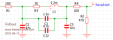

With 2.2mH you get a better image rejection. I mentioned that when you have 44kHz PWM sending a 10kHz tone, that there is an image at 44-10=34kHz. You do not want 34kHz, only 10kHz. So you need to reject the 34kHz.
The 1.5mH filter will also work, but this one is just a bit better in that respect. especially if you use 6.2nF capacitor in place of the 5.6nF (4.7 parallel to 1.5) or 6.0nF (12nF in series with 12nF).
Normally I would not do this kind of tuning and work with the standard E3 or E6 range, but there are limitted inductor values available, and 180 ohm is the max I think the picomite could drive with it's internal resistance of 50 ohm. So this is a balancing act in combination with "available parts engineering".
If you drop the 180ohm as minimum load, and would go to 150 ohm, then the filter could look like this. I will buy components and check on my picomite if 150ohm is still feasible. I am actually quite happy if 150 ohm can be done...
Edited 2022-06-12 17:12 by Volhout

It's worth the board space to get rid of that 34kHz. A sacrifice I'm happy to make. :) Many thanks for your efforts in this.
RS have 6.2nF MLCC, but only as 0603 or 0805. Still, if someone is already doing a bit of surface mount I might see if I can get the pads in to use one of those as an option. They can go underneath the board. RS also have the 2.2mH inductors if a second source is needed.
(I like RS because their postal charges are much more reasonable than Farnell unless you want a lot of stuff.)
EDIT:
Got pads on for 0803 size because they are easier to solder. 0805 will fit the same pads if that's what's available.
Edited 2022-06-12 16:46 by Mixtel90
Posts: 6206
Posted: 07:14am 12 Jun 2022
Mick,
A better solution would be to layout a single 2e through hole capacitor, use 4.7nF, and solder a surface mount 1206 of 1.5nF at the bottom between the through hole solder pads. That would also allow for the (under investigation) 150 ohm driven filter that only uses a single capacitor.

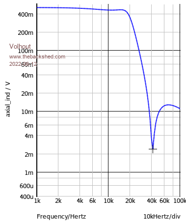

This is the response...(I love it)
The issue with 150ohm is that the P-FET in the pico, and the N-FET in the pico have different impedances, there will be linear distortion. I have to check if that is at an acceptable number (I can calculate/simulate the number, but that doesn't say anything, I will listen to WAV played from the SD card to see if it is enjoyable).
P.S. get me a link to the RS part you plan to use. I'll run it though the simulation.
Edited 2022-06-12 18:02 by Volhout

Wow... that's a lovely response! As near to perfect as anyone would need. :)
I was looking at my resistors for something the other day. The leads on all my 180R value have gone bad (black and rough). That's the only value affected. No idea where they came from, but I need to get some more at some point anyway.
Unfortunately RS's web site is down for scheduled maintenance until 1pm today. I'll get back to you on that.
