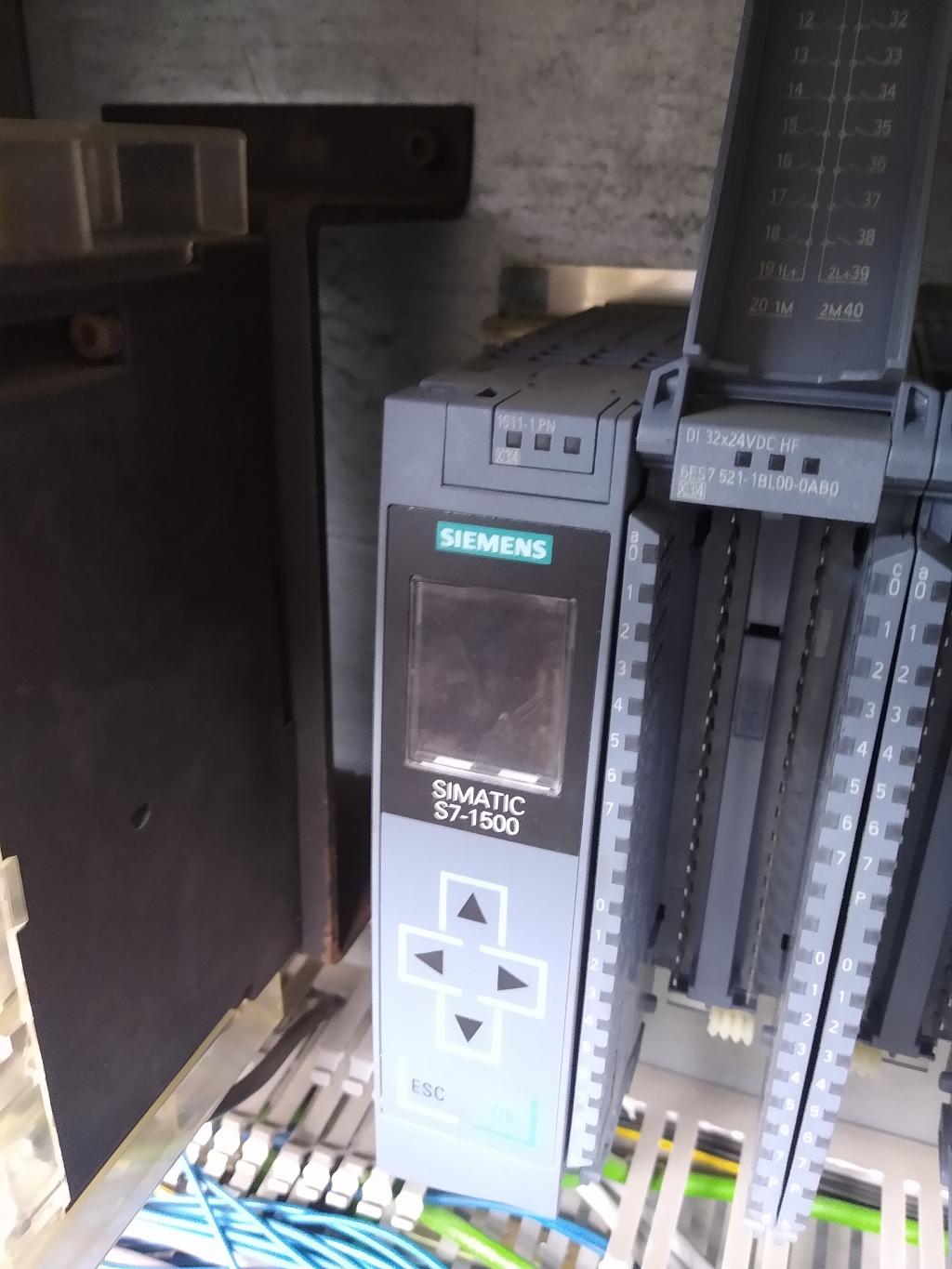

So, this CPU module goes for 2800 quid(!!!!) and doesn't do a darned thing....until you add the 500 quid interface modules.
The proposed MultiMite PLC would smoke this rubbish
Craig
