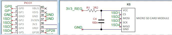

I'm confused about the setup for the SD card on Pico1. I would have thought that it would have been OPTION SDCARD 4,5,6,7 (SCK, MOSI, MISO, CS) but the circuit seems to indicate OPTION SDCARD 6,5,7,4. What should it be?
UPDATE: Ok, now I see printed on the bottom OPTION SDCard GP2,GP4,GP3,GP5, so OPTION SDCard 4,6,5,7 (and that works).

It seems to be
CS - GP2
SCK - GP6
MOSI - GP3
MISO - GP7
No matter what the circuit says. Sometimes it tells lies.  :)
I'm wondering if I put the wrong version of the circuit in the construction pack - or if I'm looking at the wrong SL6 file. The above have come from the SL6.
Note that it's the same for both Picos. This is a version 0.2 board I'm looking at.
Edited 2022-08-10 03:22 by Mixtel90

  Quote  OPTION SDCARD 4,5,6,7 (SCK, MOSI, MISO, CS)
SDcard is CS[, clk, mosi, miso]
Edited 2022-08-10 03:34 by matherp

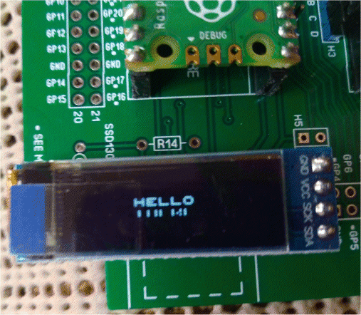

Thanks. What was written on the board works. I don't think I'll need the SD card on Pico2.
option system i2c gp16,gp17 followed by option lcdpanel ssd1306i2c,rl,2 also works, but there's some wierdness with the text--some of the pixels are not displaying.
> cls
> text mm.hres/2,mm.vres/2-15,"HELLO",cm,1
> text mm.hres/2,mm.vres/2,"THERE",cm,1

Is there a bit offset value to tweak for that display? IIRC there is on the one I used.

Ah - I've found out why I got the wrong info. I was looking at version 0.2 and you have an original version 0 board.
Version 0.2 adds a JDY-40 and micro SD card sockets. It also moves the GP4 and GP5 connections to GP6 and GP7. That change allows access to COM2 on Pico1. I don't appear to have made a construction pack for version 0.2. I was probably trying to squeeze more onto it. :)

Correct display type for this display is SSD1306I2C32
Posted: 11:31am 10 Aug 2022
  matherp said  Correct display type for this display is SSD1306I2C32
Thanks--that did the trick.
