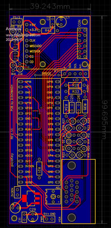

Hi Mick! Length is only a problem because it must (or should) fit into an existing keyboard. But I managed everything to fit within my determined specs. At least I would say you can't go smaller with through hole components...
So here is the PCB so far:
The reset switch must be wired externally, as well as the power jack. But I think this is a good thing, you can place it whre you like. Most importantly the VGA connector fits.

Looks like a good project, but you may want to revisit the choice for resistors.
I did this (hack a keyboard to convert it to a MMbasic computer) using a CMM1.
I noticed the height inside the keyboard is not that much.
When you have a vertical resistor UNDER the picomite the total height may exceed space you have. Maybe place it flat.
At the VGA connector side the height must be okay otherwise it won't fit at all. But similar for R15-18, R42 (under the SD card slot) and C1 (under the SD card slot).
For the resisors (there is no place to lay them flat) you could use SMT resistors (1206) that are not to hard to solder.
The capacitors... either
- move them to an area where they are not UNDER another board
- rotate the footprint so you can bend them over to lay flat.
Good luck...
(*) On the CMM1 there where 7mm height headers to support an Arduino shield. I had to remove these since there was only 7mm height in the keyboard (and the PCB was 1.6mm thick with 1mm soldering at the bottom side).
Edited 2022-04-15 16:24 by Volhout

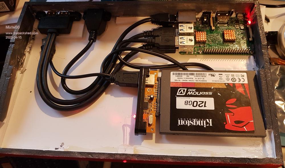

It's a pity it's PS/2. There are a lot of little bluetooth and USB keyboards that are very slim. You could mount one of those as the top of a box with the PicoMite in it.
A bit like I did with this foamboard & hot glue RPi 3B keyboard:

Speaking for myself I am glad it is PS/2 because most USB keyboards are cheap rubber dome and not mechianical this is a really really important thing for me. And there are indeed slim mechanical keyboards! Look at the Cherry G84-4100. This keyboard is interesting because it has a rectangular (overall keys) shape and you can build it into another case.
But Peter just triggered me to try wether it is possible to fit a picoVGA into a keyboard... Even if this will not succeed, we (or at least I) have a small footprint picoVGA :)
Here is the new update, suggested by Volhout

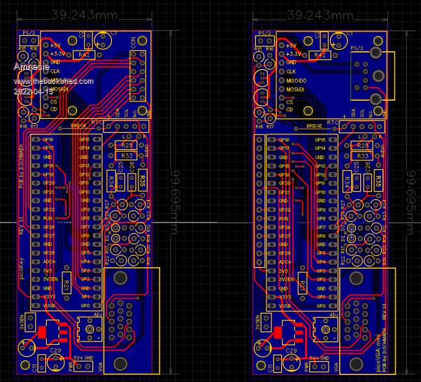

Okay,  there will be two versions.
One, on the left will ment to be for some "internal use" where a keyboard is directly connected.
However, the second is a simple mini version of the picoVGA, where underneath the SD-breakout is the PS/2 (Mini-Din) connector available. The GPIO is on the far left and can be connected via a ribbon cable or handwired to some outlets, or even attached to a male / female counterpart PCB (sandwitch style).
Every version, of course, has it's downside due to the limited space.
As soon as I have tripple checked with the schematics I release the Gerber files and kiCad etc. to the public to do whatever you want with it. Modify it futher to fit your needs.

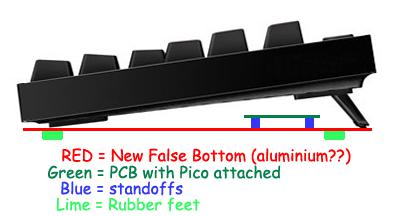

GDay All,
I did a little bit of a sketch to toss the idea around.
I looked at my keyboard (albiet a USB one) and thought along these lines
I think you could use a bit of 3mm acrylic (or Aluminium) sheet cut and attached to the under side of the keyboard with the feet extended and this should give a small area to mount your boards and only raise the keyboard height by 5-6mm
