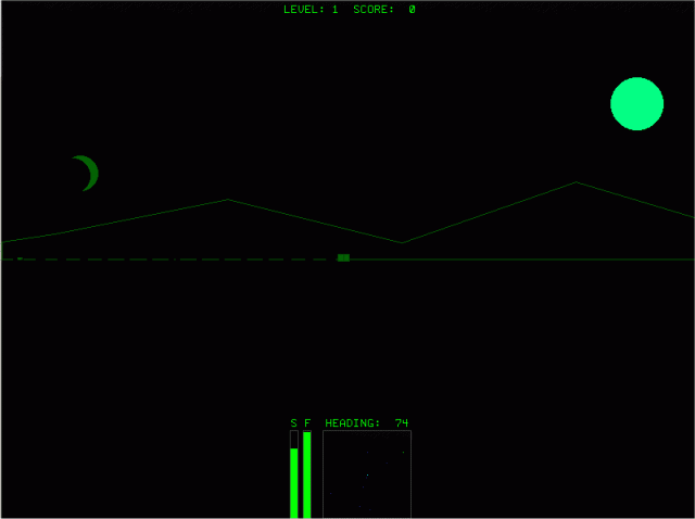

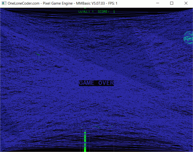

Posted: 08:23pm 27 May 2022
Re: Stellar Battle in the Seven Green Hills Zone
I'm trying to run this on MMB4W. Without making any changes, I get a screen where I can scroll with the arrow keys apparently around a horizon (sun, moon, and Jupiter appear).
I can shoot at something with Shift or Ctrl. I even got a shooter to disappear by aligning with it. I blew up some kind of starship (I think). But after not very many seconds I get this:
Do I need to slow it down (how?). Is this something like what it's supposed to look like and how it should work (obviously not the "GAME OVER" screen)? (I have no familiarity with how a game of this sort is supposed to look, or how one should interact with it.)

Posted: 09:16pm 27 May 2022
  lizby said  Do I need to slow it down (how?). Is this something like what it's supposed to look like and how it should work (obviously not the "GAME OVER" screen)? (I have no familiarity with how a game of this sort is supposed to look, or how one should interact with it.)
Hmmm. My work computer won't allow me to run MMB4W any more - most peculiar. It gets deleted if I even try to copy the zip file. Excessive organizational security, I guess. I'll try again at home.
That looks sort of right, but not entirely. Speed shouldn't be an issue, the frame rate is timed. Line 76 forces minimum 25ms per frame.
Your shield has dropped to zero, hence your death and game over.
Do you see cubes and pyramids, plus moving enemies? Can you see your shots when your press CTRL or SHIFT?
Posted: 10:57pm 27 May 2022
I can see shots incoming and outgoing, but no cubes or pyramids (or on re-looking, tiny cubes and pyramids which I am not able to align with to shoot--if I'm supposed to shoot them). I occasionally see a shooting moving enemy, and succeeded at hitting on. I did see what appeared to be an aircraft or starship, and destroyed it.
Perhaps I'll last longer if I don't shot without seeing what I'm shooting at.
Sometimes I see blue triangles which grow larger as they approach. If I do nothing, the column marked "S" diminished and after about 45 seconds, I get "GAME OVER".
vegipete
Joined: 29/01/2013
Posts: 1185
Posted: 11:19pm 27 May 2022
Sounds like there is a scaling issue.
On line 16, change this part:
math scale v(),sc*10,v()
Note the "*10". Try different values to see what you get.
vegipete
Joined: 29/01/2013
Posts: 1185
Posted: 01:23am 28 May 2022
Just tried it on my pc at home with the last posted MMB4W I could find (v5.07.03b10) and my code posted higher up works mostly as expected, including sound. There are some text scaling issues (ex: S and F don't line up with their corresponding gauges, some colours are different and individual pixels look especially tiny. This latter affects the radar display in the bottom center most. Also, the keyboard doesn't quite work as it should. Pressing SHIFT or CTRL to fire seems to clear any active arrow keys. Use ALT instead to fire.
The text size improves when I CTRL-C from the program and run again.
Change line 5 to
dim di(AC),o(AC,6),c(8)=(&h2A2AA5,&hFF00,&hAF00,&h6000,2^14,0,&hFFC000,&hC000FF,&h404040)
to fix the colours.
Change lines 161 and 162 to
circle 51+x*140/B,51-y*140/B,1,,,c(0+6*(o(n,6)=5)+(o(n,6)=4))
circle 51,51,1,,,&h00FFFF
to improve the radar visibility.
(Leave line 16 unchanged - no scale change needed.)
About the game:
I deliberately omitted any specific description in the original post so that people would have to run it to see what it was. Tom (thwill) 'leaked' that info when he mentioned "Battle Zone" - indeed, this is a take on Battle Zone or Stellar 7.
The player pilots and has a first person view from a battle tank, driving around on a rectangular plain (surrounded by Seven Green Hills!) Scattered about the field are indestructible obstacles - cubes and pyramids. There is a fuel bay - marked in green on the radar. Drive through it to fuel up, and get some shield repair. There are also a pair of enemy tanks driving around the field, and they are coming for you! There's a slower one and a faster one. If they run into things, they stop, turn a bit, then continue chasing you. Shoot them before they shoot you. Fortunately for you, they will also shoot each other. When destroyed, the enemy tanks are replaced with new ones, starting from a far corner. Once you kill enough on a given level, a Star Gate appears. Drive through it for transport to the next level. Enemy tanks get faster with increasing levels.
