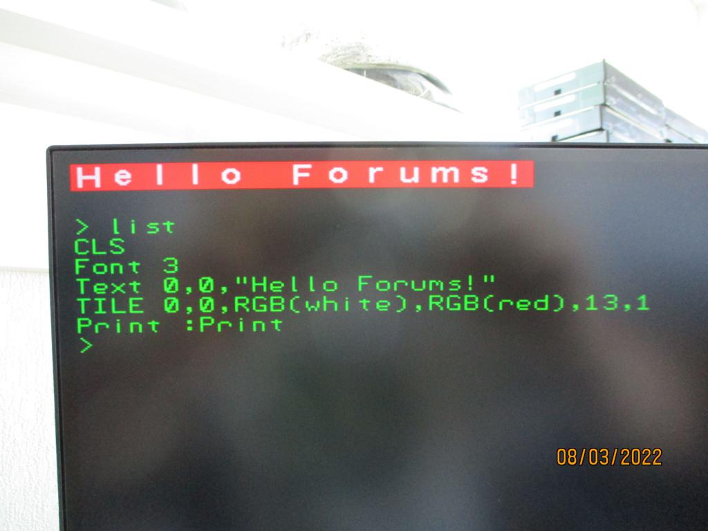

To change the colour of the text, you first write the text to the screen(after setting the default foreground/background), and then use the TILE command to change the colour of the text/background at any one point on the screen.
When the TILE command co-ordinates are the same as the text you just wrote to the display, then the text colour changes at that point, but not via the TEXT command.
That's how I understand it, anyway.
EDIT - Like this:
Edited 2022-03-08 11:00 by Grogster
