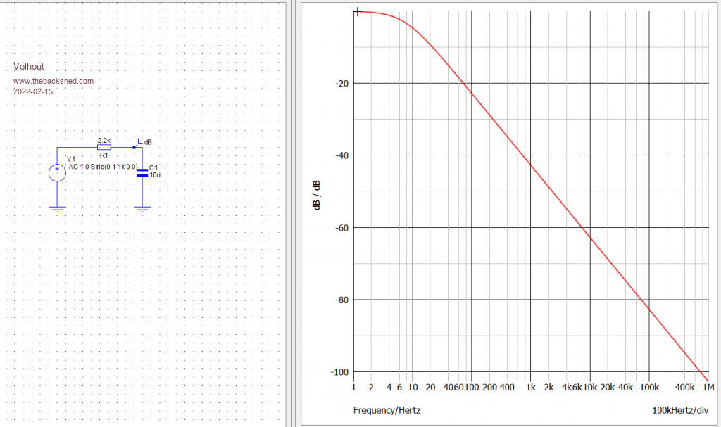

Posts: 6206
Posted: 03:01pm 14 Feb 2022
Hi Robert,
I hope you are not anoyed by my interest and feedback.
Thank you for the explanation. I understand what you are trying to achieve.
If you are running the PWM at 1250Hz to achieve 16 bit resolution (Geoff suggest).
1/ to suppress the ripple from 10V to 100mV at the 10uF cap, you need a factor 100 (40dB) reduction of pp ripple. If your goal is 10uV (1ppm) I think 100mV is too much, but opinions may vary. Anyway, you need at least 2.2k resistor to get 100mV.
If you use 2.2k then the peak current drawn from 10V is 5mA. That will generate ripple on the 10V. Therefore it is better to buffer the 10V with a low drift opamp, and use the buffered output to power the PWM.
However...
If I read read the datasheet of the AD587 correctly, the tuning range from the TRIM  pin is +/- 14mV. There is already a high impedance resistor inside the AD587.
When the tuning range is that limitted, you van also run the PWM from a accurate 3.3V, and apply the output via a relatively high impedance resistor to the wiper of the potmeter. As long as it is high impedance with respect to the potmeter. Something like 100k. So power the MX170 from a accurate and temperature stable 3.3V (does not need to be as accurate as the AD587 itself) and use it's push-pull output to drive the RC filter directly. No need for external switches.
By the way the trimpotmeter needs to have good long term stability (metal film ?).
And you may already have to be carefull about the metals you use. Thermocouple voltages between solder and copper will already play a role at only few degrees temperature difference.
My colleague, who has designed multimeters also suggest that when you have to use mechanical relays, use bi-stable relays, because heating of relays coil will cause thermoelectric voltages that destroy your 1ppm goal.
Edited 2022-02-15 01:05 by Volhout

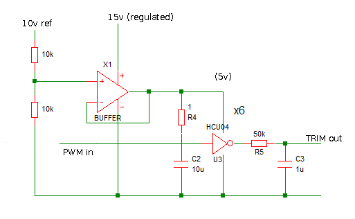

Posted: 04:30pm 14 Feb 2022
  Volhout said  I hope you are not annoyed by my interest and feedback
no worries, not annoyed at all - your feedback is very much welcome and appreciated.
the recommendations on the EEVblog metrology forum seem to be to keep the switching frequency relatively low. Andreas on EEVblog suggests 300Hz to aid in rejection of both 50Hz and 60Hz mains. i rather like your idea of using an opamp to buffer the 10v, conveniently at the same time it can be halved to 5v which makes using a 74HCU04 easier:
(edited from schematic in EEVblog posting linked to earlier, "TRIM out" goes to trim pin via a high-value resistor)
i can always use a second PWM channel to provide a second trim voltage through an even higher feed resistor if needsbe, thereby achieving more effective bits of resolution.
  Volhout said  Anyway, you need at least 2.2k resistor to get 100mV
the schematic i borrowed above uses 50k, it just needs to be a couple of orders of magnitude less that the associated high-value resistor. remember that we are only wanting to shift the trim pin a very small amount.
i would rather not use the MX170's PWM output pin to drive the resistor/capacitor directly, as there is still quite some electrical noise on the PWM pin. the use of a CMOS logic chip running from the reference voltage seems to be a trusted approach to mitigate this.
  Volhout said  By the way the trimpotmeter needs to have good long term stability (metal film ?)
'professionals' replace trimpots with fixed-value resistors after calibration! but will address that one when i get to it.
rob   :-)
Posts: 9265
Posted: 07:51am 15 Feb 2022
  Quote  i would rather not use the MX170's PWM output pin to drive the resistor/capacitor directly, as there is still quite some electrical noise on the PWM pin. the use of a CMOS logic chip running from the reference voltage seems to be a trusted approach to mitigate this.
Looking at Volhout's plot above, even with only 2k2/10u any noise from the MX170's PWM pin is going to be very well filtered out. The primary clock frequency is well above 1MHz, where you are already at -100dB and falling rapidly. Harmonics will be non-existent. I would suggest that if you are seeing noise on the output from the filter then it's to do with poor layout or is coming from your reference supply rather that produced by the chip.
If response time isn't an issue but noise is, you could always use a 2-stage filter rather than a single RC stage. PWM is always a compromise between allowable ripple and filter response time. :) Use a good quality capacitor. (50k? What sort of new-fangled value is that? What happened to good old 47k? It'll be feeling left out ...)
Posts: 6206
Posted: 10:46am 15 Feb 2022
In case the adjustment range on the trim pin is +/-14mV on a 10V range that is 28mV/10V = 0.003. If you are goaling for 1ppm ripple (10uV on 10V) from the PWM you need a filter that outputs max 10uV/0.003 = 3mVpp ripple at the TRIM pin.
With the chosen 300Hz frequency Zc=1/(2*pi*f*c). For 10uF Zc= 53ohm.
To get 3mV from 5V at the HCU04, you need 0.003/5 gain is 1/330'th
Therefore the series resistor must be minimal 330x53ohm = 17k. So your 50k/10uF is fine for 300Hz.
Please note that ceramic capacitors capacitance value is voltage dependent (at 12V they can be 5uF only), but with 50k you have sufficient margin. But if you want to go a certain, pick a film capacitor for that one. And maybe a 1nF ceramic parallel to make sure no high frequency passes.
Another thing to think about is:
If you really achieve 16 bits (1:65000) you potentially can avoid the potmeter completely, and do it all in SW. +/-14mV adjustment range at 16 bits resolution would allow you to adjust to 0.5uV steps. That should be sufficient for many applications.
Nice project...
