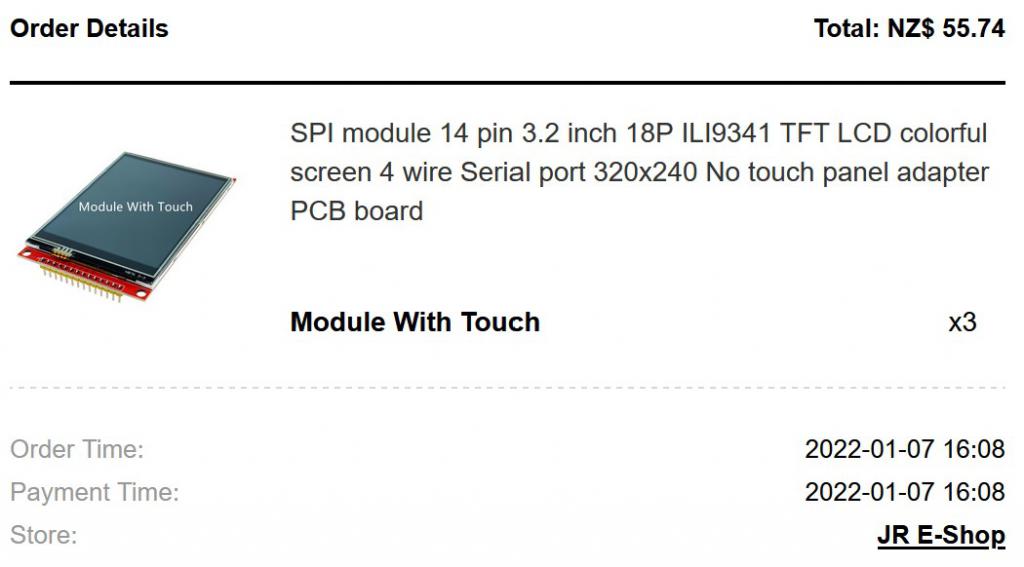

"It was indeed an ILI9488 sold as an ILI9341"
That is two now, could either of you let everyone know who the vendor is to save them the hassle you have been through?
Posted: 09:49pm 03 Feb 2022
If it says 3.2" assume ili9488
Posts: 3418
Posted: 10:03pm 03 Feb 2022
"If it says 3.2" assume ili9488"
It depends on the vendor. I have an actual 3.2" ILI9341 working perfectly with the ILI9341 options that I got from JR_E-Shop on AliExpress.
Glen0
Joined: 12/10/2014
Posts: 102
Posted: 12:07am 04 Feb 2022
This was my purchase.
Posts: 3418
Posted: 04:57am 04 Feb 2022
Ok! Same vendor, what you get is just a "lucky dip". Only solution is to try both drivers. At least you should have got some extra resolution (480x320) for your trouble. Are all three the same or a mixture?
