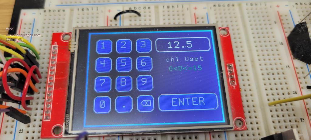

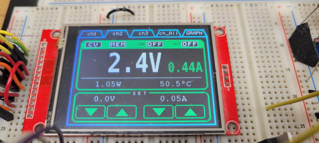

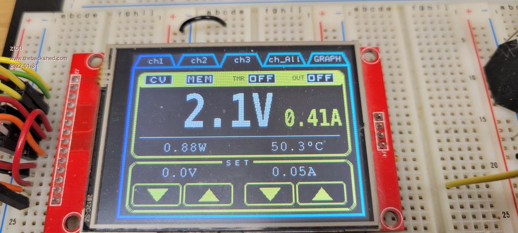

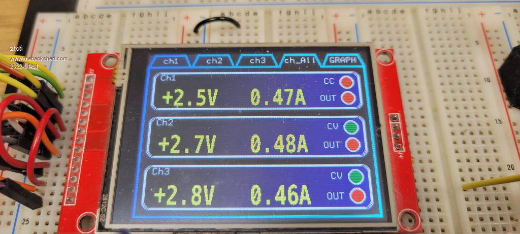

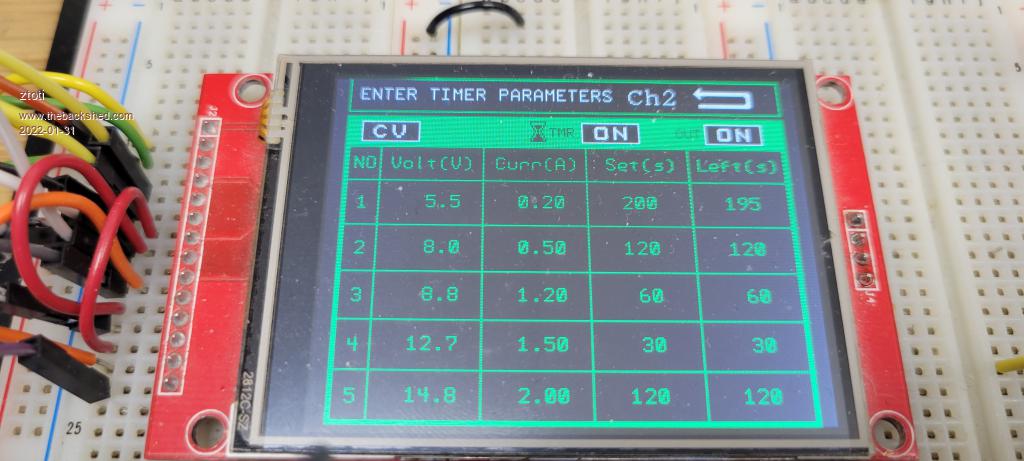

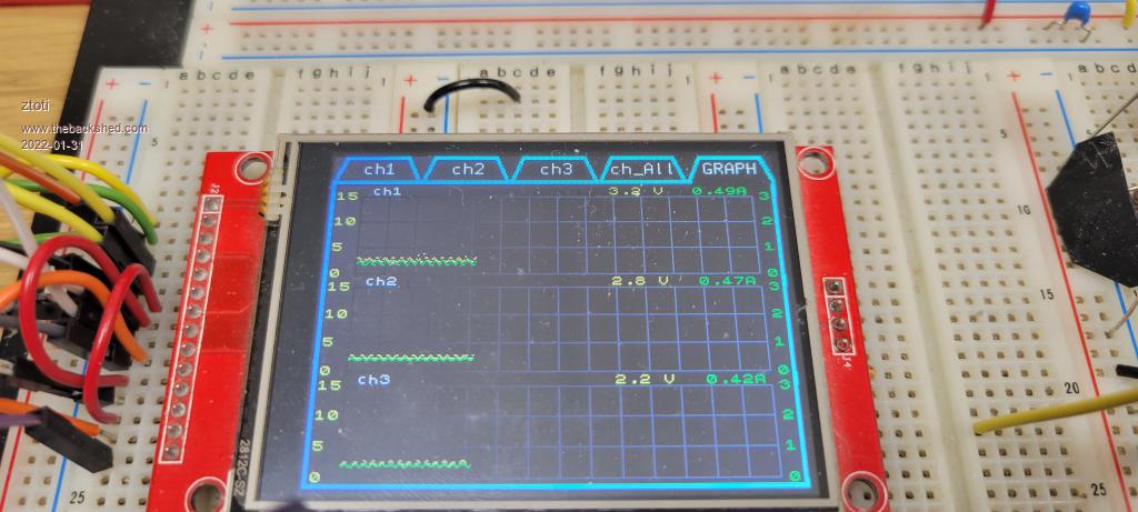

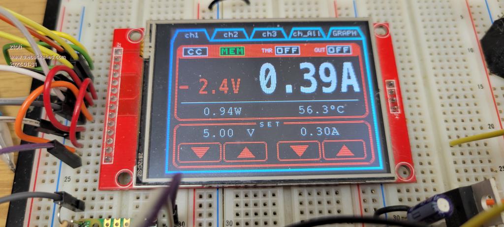

I now that small scope on aliexpress is available for low price, but I'm happy with audio range scope. I'm not trying to replace the real scope, the PICO scope is just one part of my project. I'm building breadboard lab which include:
1. 3 channel full controlled power supply ( +-voltage control, current control, timer
  mode, graphic mode)
2. Function generator
3 Voltmeter, amp meter, RLC meter, ESR meter
4. small oscilloscope
5. frequency counter
6. Curve tester
7. maybe logic analyzer
Check out the screens from my power supply ( everything works great) and when I finish the project I'll upload the schematic and .bas file

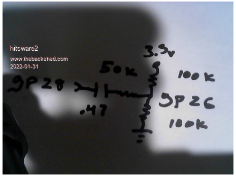

Here's Mine ...... :)
SetPin gp28, pwm6a ' bonus 5 kHz generator
PWM 6,5000,50
Dim v!(127)
ADC open 500000,1
CLS
ADC start v!()
For x%=0 To 127
Pixel x%,20*v!(x%)
Next x%
Pause 200

@ztoti,
That is a nice project. How do you control the individual power supplies ? I2C ?
Is it your intention to run all the lab instruments on one micromite, or does each instrument have it's own micromite ?
Interesting project,
@hitsware,
That is the circuit I use to measure the mains voltage (with a resistor in series with the capacitor). The mains voltage is isolated by a transformer (8Vac) to keep me from being electrocuted...

It's handy to put a high value resistor across the cap, Volhout, just so that you don't get a 2xpeak spike into your system next time you connect the mains input. :)
I saw an application note for a PIC microcontroller where, to detect zero crossing, they simply connected an input pin to Live via 1M and used a capacitive dropper to power the PIC. Apparently the protection diodes on the PIC are sufficiently robust for that. (Please don't try to emulate this on a PicoMite input - especially an ADC one as I don't think those have protection diodes at all!).
