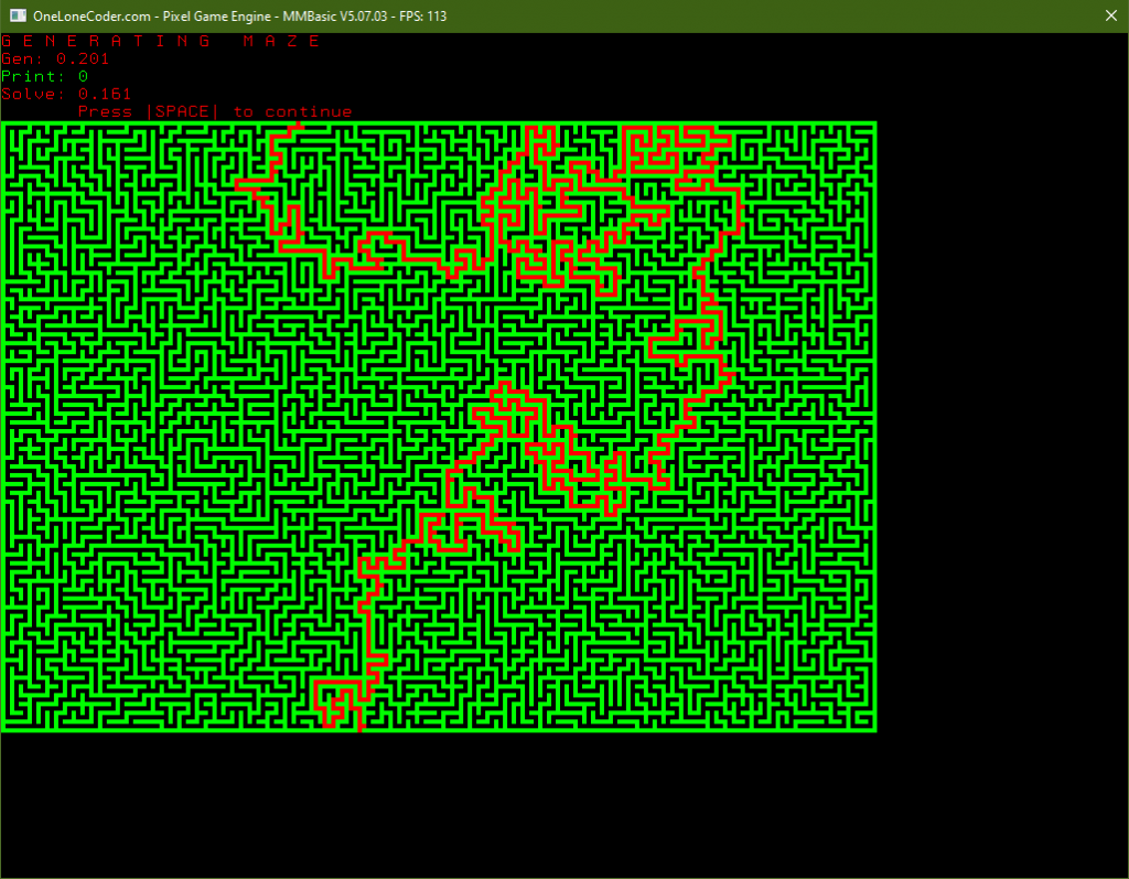

I'm impressed on you speed of coding and your results. I took Mazist and broke it down to the essentials of generating a maze, printing it to screen and the using the mouse solve routine - couldn't use the original Mazist as it uses commands unknown to Windows MMBasic such as TEXT, MATH SET, GUI CURSOR and MAP commands. Each routine was timed and then I ran the same program on my MM2 to see the difference. My PC is an old I5 and only scores 185934 grains on KnviD's Benchmark.
Maze size 99x69 nodes
MM2: Generation: 1.8-2.7 seconds
    Print: 0 seconds!
    Solution: 1.55-2.33 Seconds
PC:  Generation: 0.2-0.28 Seconds
    Print: 0 Seconds!
    Solution: 0.16-0.18 Seconds
Near enough to 10 times the performance for these routines. I'm looking forward to future developments.

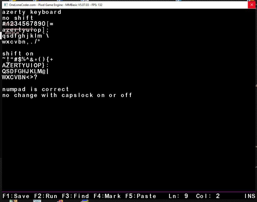

I have also problem with keyboard. I am in frech (azerty), but with mmbasic
some keys are in qwerty and others in azerty. It is very difficult to use
for exemple : all keys on up of keybord are in numeric mode by default and specials keys are not in same place as azerty. but all alphanum keys are good

not exactly, no "_" key, and azerty for alpha keys not qwerty

  Quote  not exactly, no "_" key, and azerty for alpha keys not qwerty
Interesting, it seems the keyboard routines deliver mapped keys for the alpha part but raw position codes for the numbers etc.
To solve this I'm going to need help from foreign language keyboard users (including US)
later today I'll post a special diagnostic version which will print the raw codes I receive together with the keyboard map and will be looking for someone with each language to create a map for their language

my azerty keyboard
each line is same as each keyboard key line

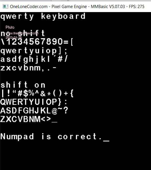

Peter, this is what i get with qwerty keyboard. Not sure in what format you need to have it.
/Fred
