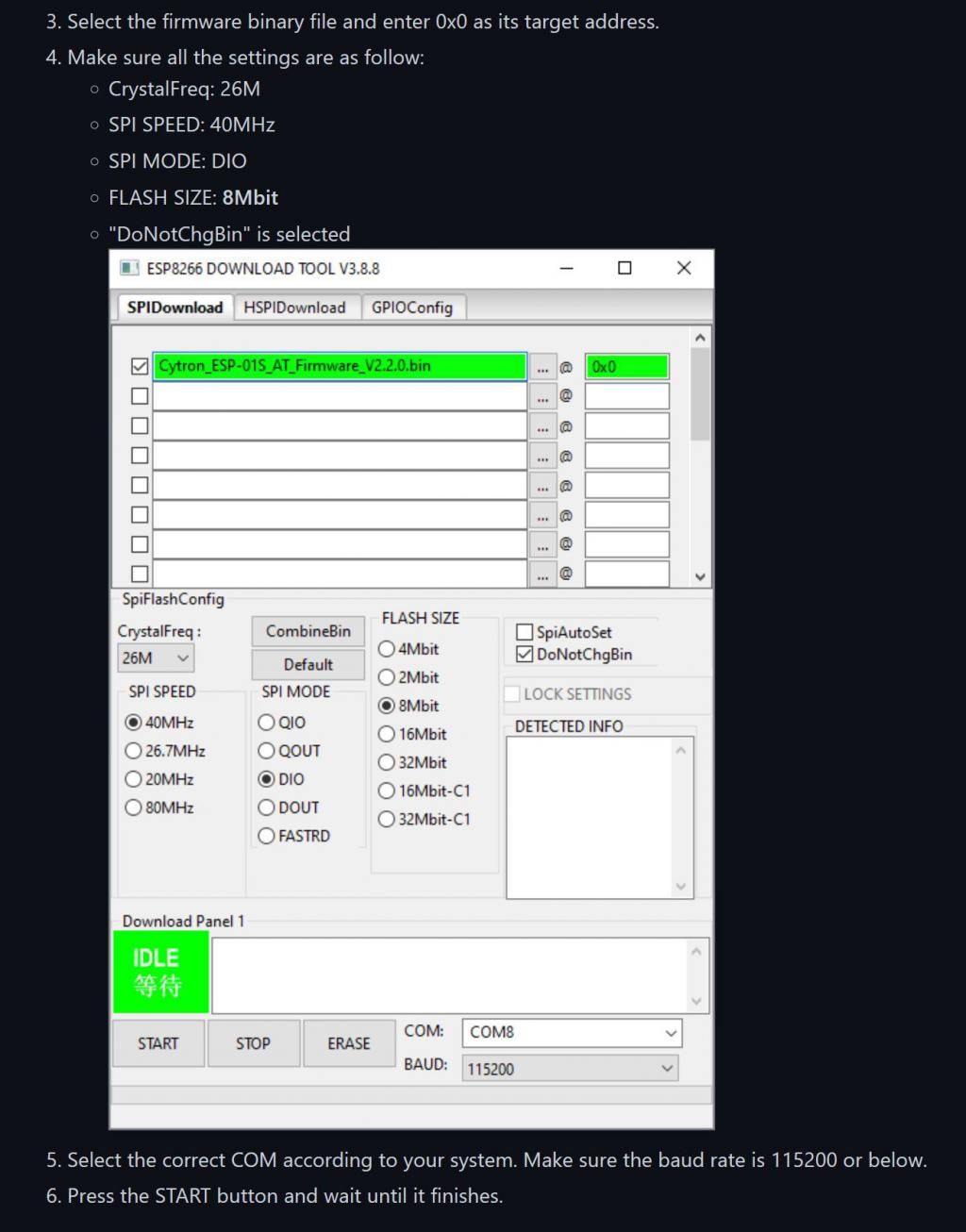

Peter
Have a look here *Custom Compiled ESP-AT Firmware Binaries*
  Quote  These are the AT command firmwares for ESP8266 compiled from Espressif ESP-AT Source Code.
The firmwares have two different sizes:
   Cytron_ESP-01S_AT_Firmware - For ESP8266 with 1MB flash size (eg: ESP-01), doesn't support OTA update.
   Cytron_ESP-12F_WROOM-02_AT_Firmware - For ESP8266 with flash size 2MB or above (eg: ESP-12E, ESP-12F, WROOM-02).
It has links for a simple ESP flash tool with instructions and there is only 1 binary to flash
This is the espress gitgub page with more information including the roadmap

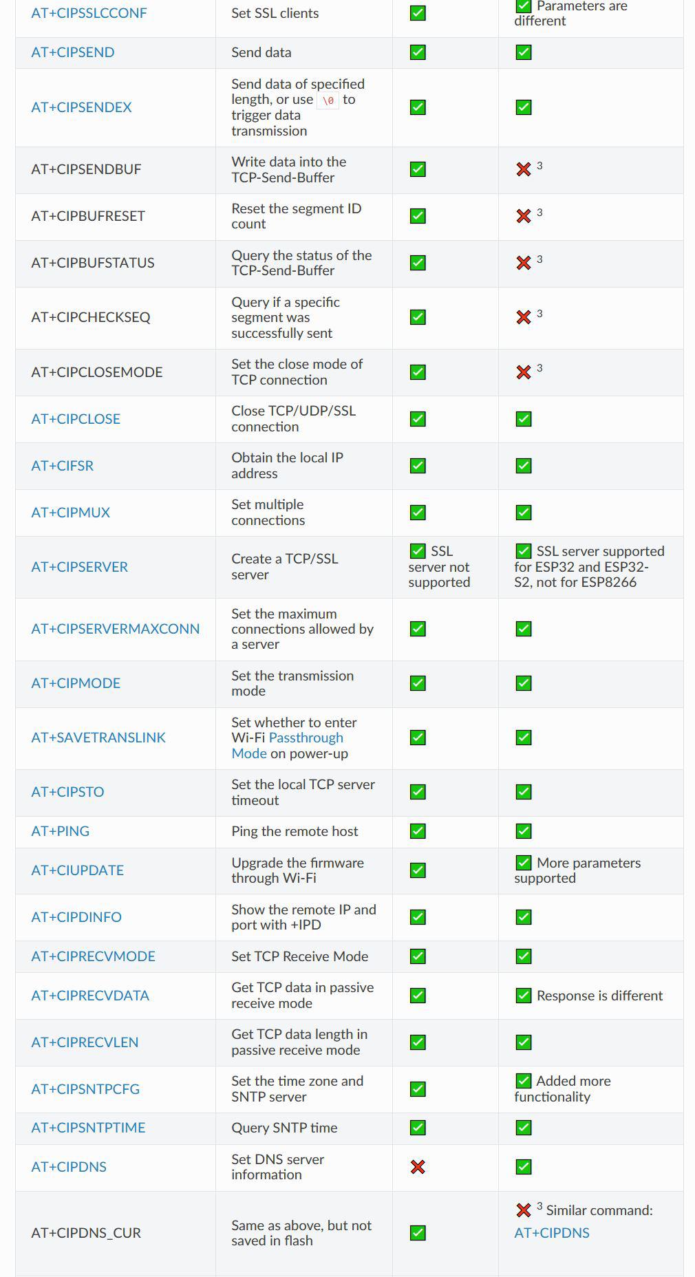

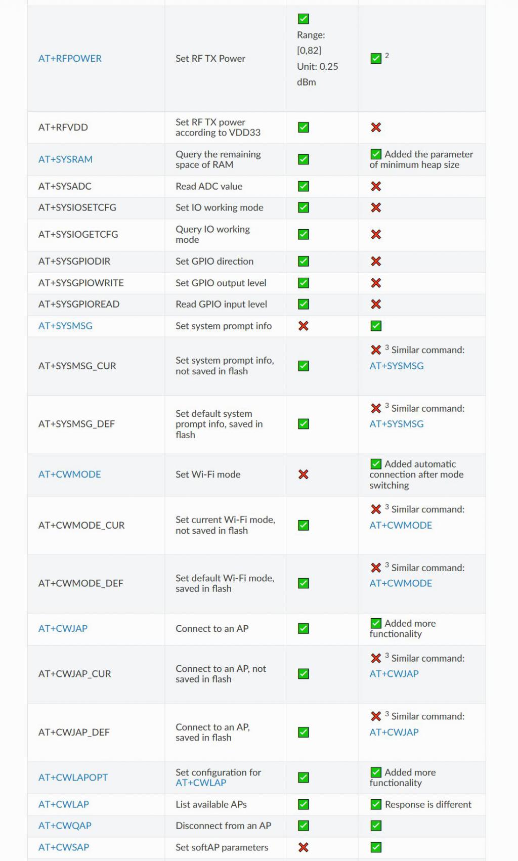

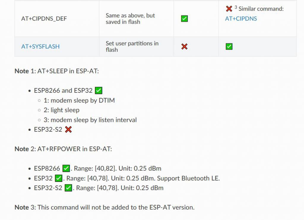

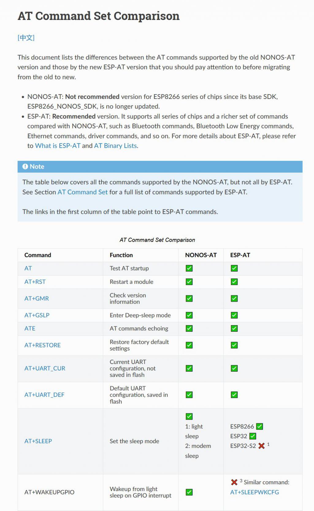

These are the AT commands
***The next version of ESP-AT firmware (v2.4.0.0) is planned to be released in March 2022. At present, only ESP32-C3 series firmware is planned to be released, and ESP32-C3 firmware would support Bluetooth LE 5.0.***
This should do what everyone wants? and be easy enough to use?
And once it's flashed it can be updated over the air {if neeeded}

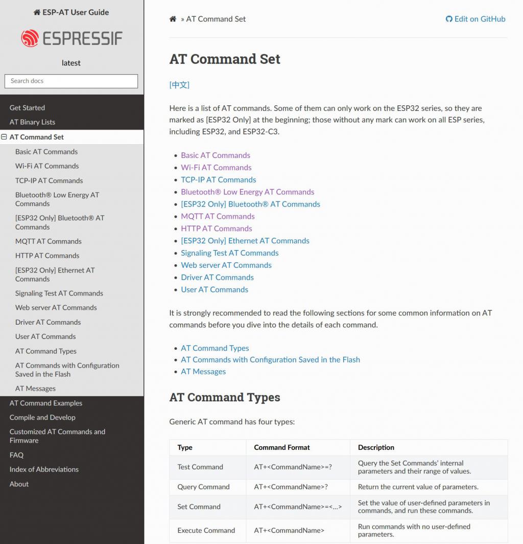

That was precompiled binaries and the information on their page
This is the MQTT AT Commands
   AT+MQTTUSERCFG: Set MQTT user configuration
   AT+MQTTCLIENTID: Set MQTT client ID
   AT+MQTTUSERNAME: Set MQTT username
   AT+MQTTPASSWORD: Set MQTT password
   AT+MQTTCONNCFG: Set configuration of MQTT connection
   AT+MQTTALPN: Set MQTT Application Layer Protocol Negotiation (ALPN)
   AT+MQTTCONN: Connect to MQTT Brokers
   AT+MQTTPUB: Publish MQTT Messages in string
   AT+MQTTPUBRAW: Publish MQTT messages in binary
   AT+MQTTSUB: Subscribe to MQTT topics
   AT+MQTTUNSUB: Unsubscribe from MQTT topics
   AT+MQTTCLEAN: Close MQTT connections
   MQTT AT Error Codes
   MQTT AT Notes
Full AT command set
This page has the official EspressIF binaries for the various ESP chips along with the flashing tool

  Quote  That was precompiled binaries and the information on their page
They have to be compiled into the binary otherwise they aren't there. Without a major amount of work it seems impossible to know what is included in who's local build and Expressif (possibly deliberately) have clearly broken the ESP-01(S)
This is my last post on this issue I'm not pursuing it further and not including support in any port of my ports of MMbasic, too messy and too chaotic - sorry Lewis

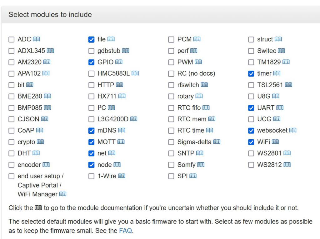

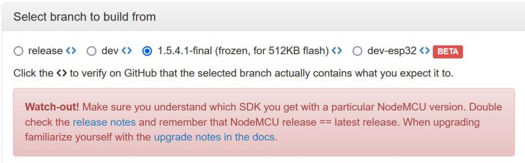

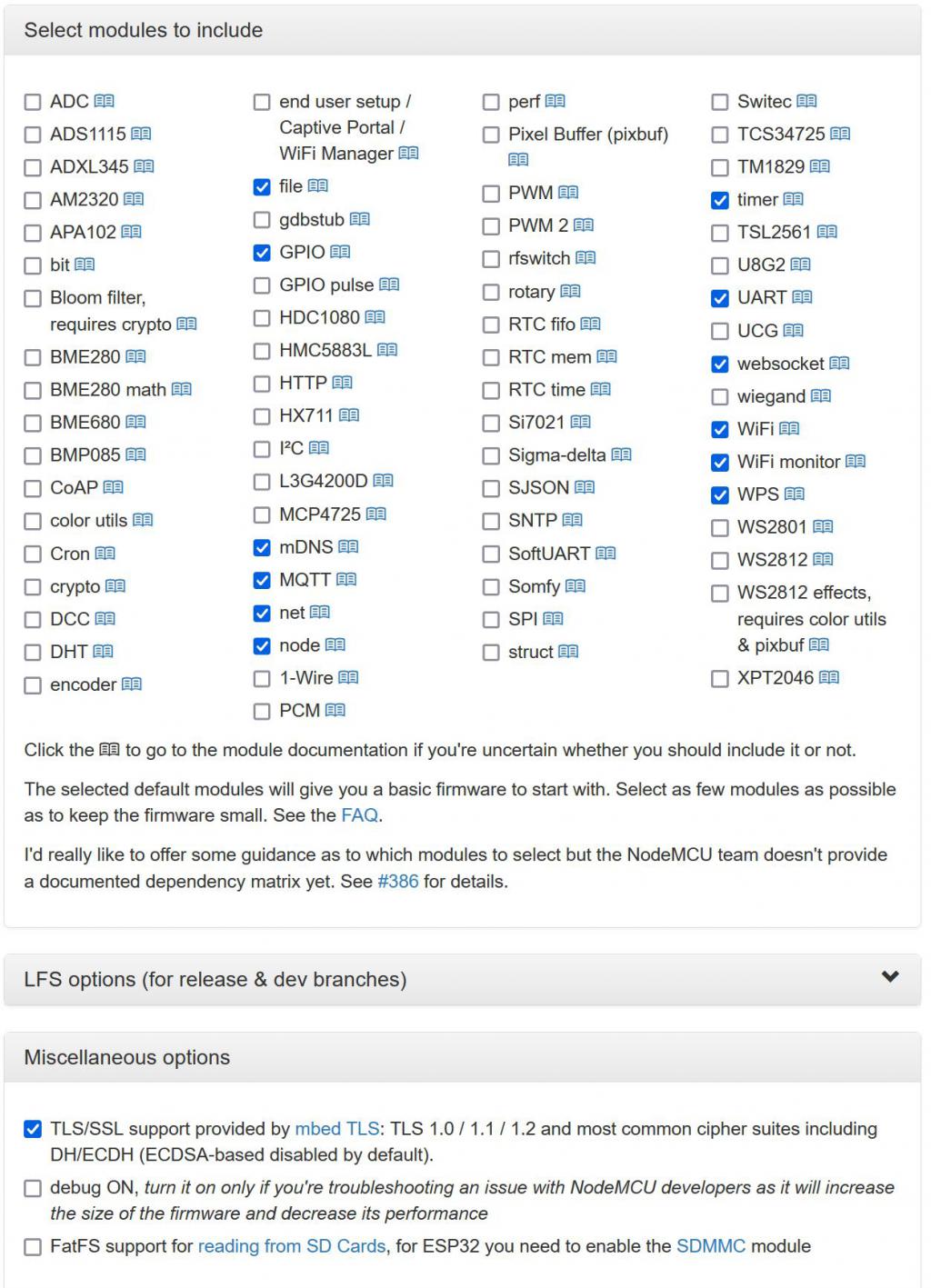

I totally understand, but for anyone interested I found this
Which tells you how to simply and easily make your own binary with only the actual modules you need using the NODEMCU page HERE
You simply select which branch you want to build your binary from, select and it builds it for you online.
The 512K branch is for the ESP8266-01 with memory of less than 1Mb (most of the early ones released)
This is the full list of modules you can select, you just pick the modules you want
It might be of use to anyone that has or wants to use any of the ESP modules from 8266, 8285, esp32 wifi mqtt (still no idea what that is) or other things
This way you're using your own binary that has only the actual modules you want/need in it
The only issue is it doesn't use the AT command set but is NODEMCU
it seems easy to use but I can't say, it does however look like sending commands to it from any MM device would be really simple

Posted: 05:50pm 20 Jan 2022
  Quote  make your own binary with only the actual modules you need using the NODEMCU page HERE
I have built NodeMCU binaries a few times at various times using the online builder and never got it to work reliably despite trying different ESP8266 modules etc. Lots of crashes/reboots. Same hardware was rock solid using Arduino IDE so I gave up on NodeMCU. I think the NodeMCU firmware overhead was too much for a resource limited device like the 8266.
I was looking for a tiny ESP32 module with through hole header pins like the ESP01 but couldn't find one. Is there a ESP32 version of ESP01?
Edited 2022-01-21 03:53 by flasherror

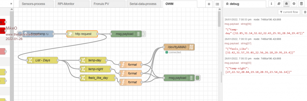

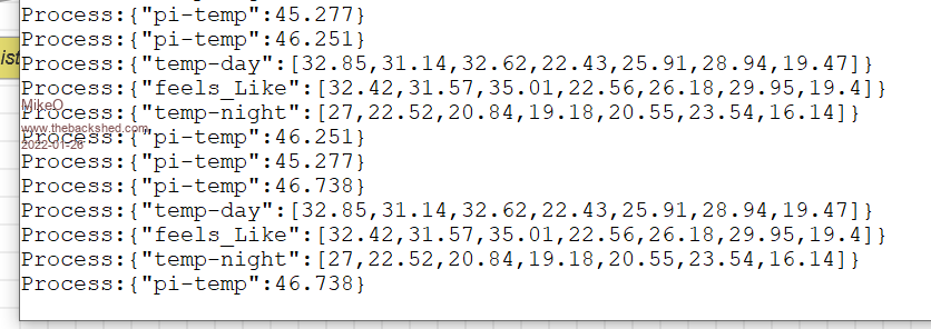

Been experimenting with my Raspberry Pi - Picomite combination. Raspberry Pi (could be a Pi Zero W)running Node-Red works extremely well parsing HTTP "Get" to APIs in this case OpenWeatherMap. This makes all types of Network/Internet comms possible (HTTP, MQTT, UDP ) etc. In this case I did a HTTP request to OWM as a 7 Day Forecast request and I have just selected a few nodes to send to the Pico. Here is screenshot of the "Flow" (Node-Red speak) and the received data on the Pico.
Edited 2022-01-26 18:33 by MikeO
Codenquilts
Posts: 9265
Posted: 08:53am 26 Jan 2022
That's so pretty - but completely beyond my comprehension. :)
I may have to go and lie down in a darkened room now...

Posted: 11:20am 26 Jan 2022
That's fine, not advocating, just suggesting as others had done, until someone writes such universal code for suitable hardware, there are other ways that may suit as a solution for some situations.
Cheers, Mike

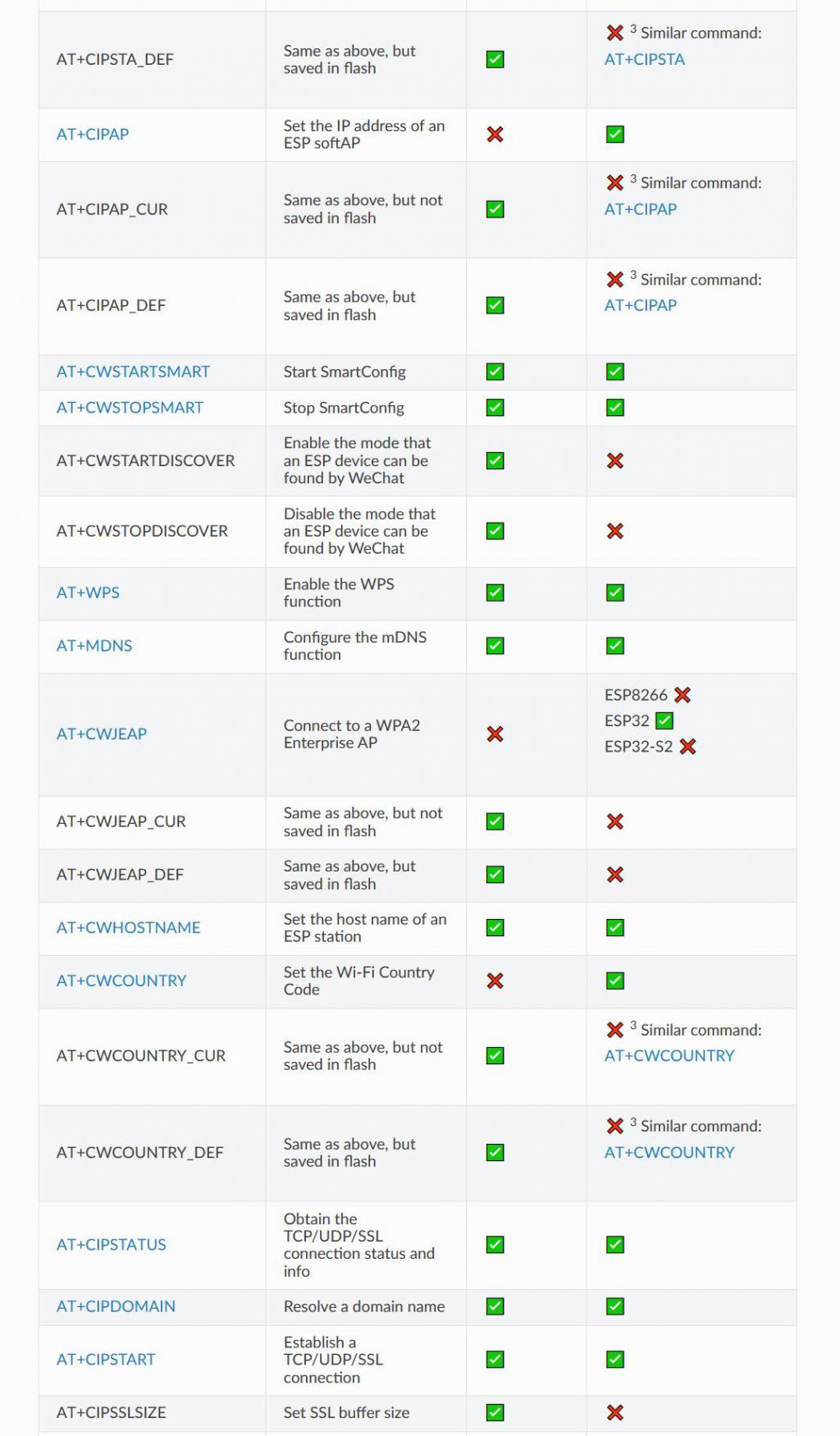

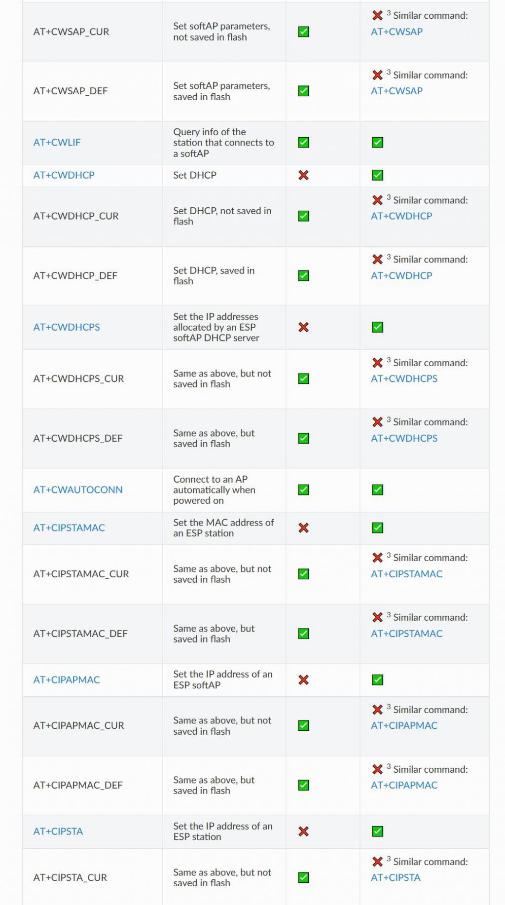

ESP8266 flashed with the AT command set
From what I can see it has the full AT command set installed
IF I can find an ESP8266 and a programmer I'll try flashing it with the firmware which can be downloaded here and see what commands actually are installed
This firmware is for the 1MB and doesn't support OTA
This image is for the larger ESP8266-12
I think I might have got rid of the programmer though so if anyone else has an ESP8266 and actually wants to try it?
For those with the 512K esp8266 here's a link to the last version of Espressif's 1.74 binary for that one

Posted: 12:50pm 26 Jan 2022
It's the same support problem, isn't it? They put up version 2.2.0 binaries, but where's the command list? It would have been easy to include that on Github - after all, someone put the binaries there. Why should the user have to try every possible combination of every command to see if it works? What about new commands that weren't in previous versions? How do we know they are there? Do these people not care about their users? We know the Cytron AT commands aren't exactly Hayes compatible in some ways, but in *what* ways?
This *may* help:
https://drive.google.com/file/d/1zrOoTNiCZ-GEth75b6xNpIUiE0UkjG61/view
Edited 2022-01-26 23:00 by Mixtel90
Posted: 01:06pm 26 Jan 2022
  Quote  It's the same support problem, isn't it? They put up version 2.2.0 binaries, but where's the command list?
Fully agree. One of the key requirements is MQTT is it included? Nowhere is there any useful information.
Makes me appreciate even more Geoff's wonderful manuals
