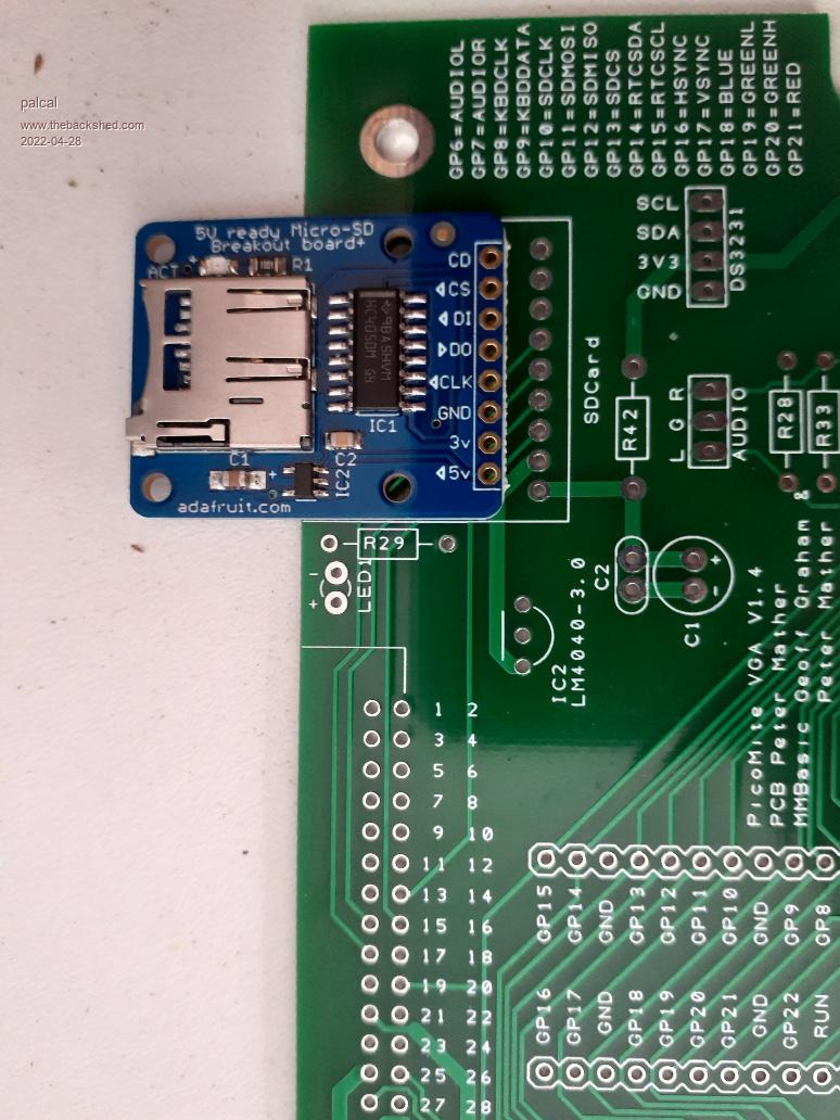

Posted: 04:43am 28 Apr 2022
I ordered the SD card breakout board from Element14/Farnell part no. 279-9953
It is different to the one shown in the photos. I can't read the silk screen on matherp's photo and the scematic in the ZIP file is .sch format that I can't open.
Here is a picture of what I have. I think I will have to offset it but do the pins match up. There was no photo on the Element14 site so I was flying blind.
Edited 2022-04-28 14:48 by palcal

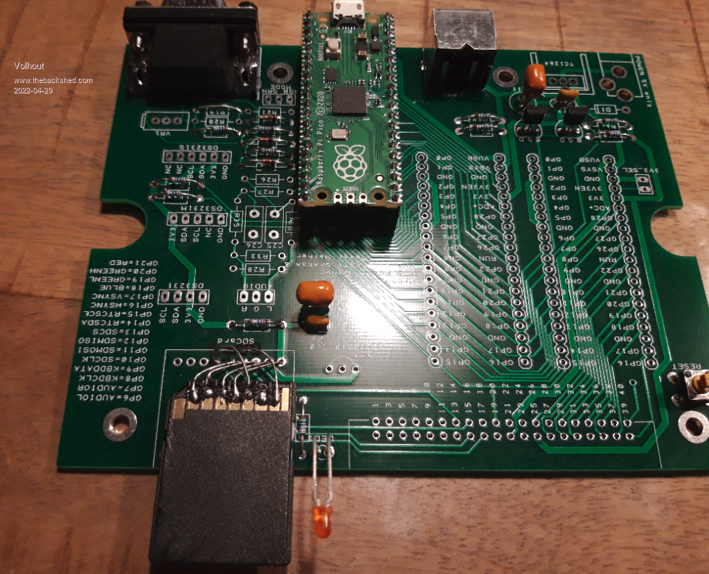

Posts: 6199
Posted: 05:53am 28 Apr 2022
Hi Pascal,
Your sd card board is capabele of 5v. The board that Peter designed is 3.3v
So you have the wrong board.
But you may be able to get it to workshop by tying 5v and 3.3v pins together to 3.3v.
And you may have to swap pins in the Option sd card definition.
Turbo46
Joined: 24/12/2017
Posts: 1694
Posted: 05:54am 28 Apr 2022
I got the one specified from Core Electronics.
The pin layout is different and yours has a voltage regulator and level shifting which are not needed for Peter's board. There is a datasheet on the Element14 site for info on the one you have.

Amnesie
Joined: 30/06/2020
Posts: 763
Posted: 08:35am 28 Apr 2022
  Volhout said  Hi Pascal,
I am using this Adafruit Sd Breakout on ALL my picoMite builts. It works perfectly with 5V directly, since it has own level shift but it also works via 3V3 on the corresponding pin. In my opinion this is the ultimate breakout because it is ready for every voltage. Of course it is a slightly different pinout than the black (3v3 only) version for which the original picoMite VGA PCB was desigend for.
So in short: the Adafruit blue version does work, but it won't fit the pinout on the board.
Greetings
Daniel

Posts: 6199
Posted: 08:35pm 28 Apr 2022
Pascal, I was impatient....
palcal
Joined: 12/10/2011
Posts: 2053
Posted: 08:43pm 28 Apr 2022
I think we have all done wiring like that at some time.

One way to use a different breakout would be to make a carrier board out of strip board which will fit the mounting for the specified board and fit the alternative board on top of that with the cross patching done on the strip board. That will allow you to fit the correct one later if you want.
