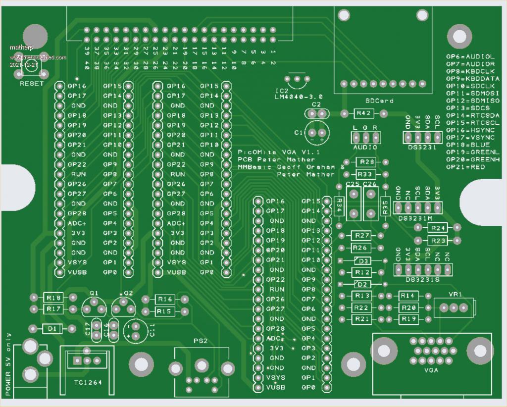

Posted: 06:42pm 20 Dec 2021
Here are the gerbers - hopefully OK as I've just ordered 5 boards from JLC
PicoMiteVGA.zip
Ignore the filenames - they are the right ones

Posted: 04:42am 21 Dec 2021
Peter - your schematic and gerbers don't match.
Schematic says 78xx reg for IC1, but gerbers say TC1264.
Gerbers show IC2, schematic has no IC2 at all.
Can you please post an updated schematic or better yet, a BOM for your board?
I have also ordered five PCB's.

updated schematic
VGAMite - Project.pdf
Note SDcard holes are probably too far from the card edge as I don't yet have a module to measure. Will update in V1.1. Suggest you wait a few days until I post V1.1 before getting any made.
LM4040 is optional - see Pico module datasheet
missing from silkscreen - will add "OPTION SDCARD GP13,GP10,GP11,GP12" and other configuration data
Will also add audio filter in V1.1 to be populated if the user requires

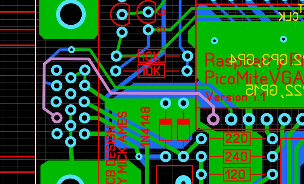

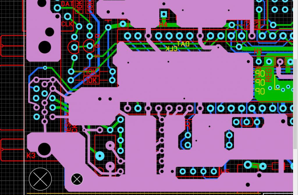

Posts: 10076
Posted: 06:46am 26 Dec 2021
Mick - you seem to have an error on the new layout.  Several pins on the Pico module are directly connected to ground, including pins on the VGA socket that should not be such as the red video signal.  Pin 13(H-sync) is not connected at all.
See attached image:
Posts: 9265
Posted: 08:10am 26 Dec 2021
OOPS - Thanks Grogster! I think I picked up the wrong folder... that looks familiar.
The right ones this time (I really should keep tidying up as I go along.  :(

Posts: 10076
Posted: 08:17am 26 Dec 2021
Much better.
H-sync still is not connected.
You have it on pin-12, which is "ID Bit 1".
Needs to go to the pad just above it - pin 13.

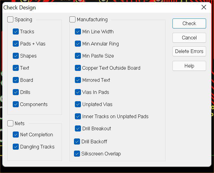

Posted: 08:27am 26 Dec 2021
I know Grogster does it and is successful but I think laying out even a simple PCB without starting with a schematic is asking for problems.
The "bug" in your layout could simply not happen if you had a schematic and use any decent package to confirm correspondence between schematic and layout and therefore to check layout errors
My advice to anyone designing PCBs. Start with the schematic and use it to derive the layout. I have NEVER had a design with a layout issue. The only changes are always because the schematic has a design error or to enhance a design.
The image below shows the checks DesignSpark does and only when there are no errors, or they are ones I accept (e.g. silkscreening outside board area) do the gerbers get created
