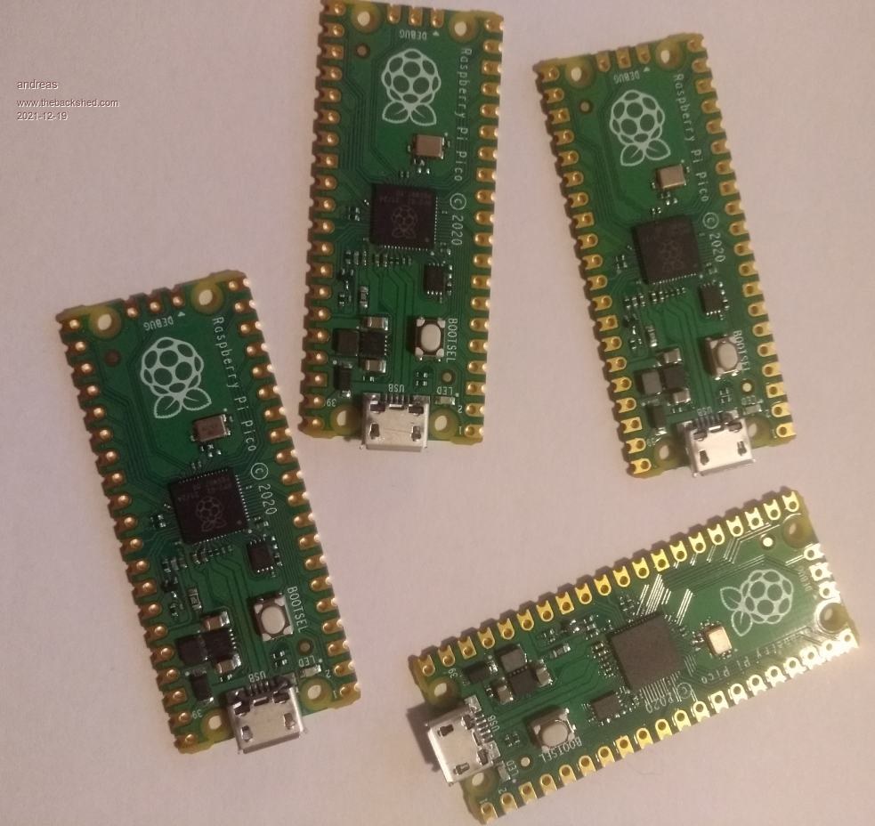

Now I have tested 5 different Picos, all processed the same way:
1. Cleared the flash: Clear_flash.uf2
2. Installed Picomite: PicoMiteV5.07.02b1.uf2
3. Started minicom 2.7.1 (my host = debian linux)
4. Started: XMODEM RECEIVE on the pico and pressed Ctrl A+S to start a transfer
5. Selected: Upload xmodem
6. Selected the "running mean.bas" and started it after transfer to the pico
The results are here   :

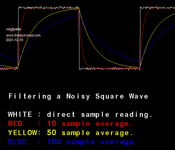

Since everyone likes pictures, here's a version for the CMM2, filtering a noisy square wave.

 reading = RandGauss(32) * 40 + square
 ' calculate new averages
 inc average_10,  (reading - average_10 ) / 10
 inc average_50,  (reading - average_50 ) / 50
 inc average_100, (reading - average_100) / 100
 blit 1,50,0,50,MM.HRES-1,300  ' roll to the left
 line MM.HRES-1,0,MM.HRES-1,MM.VRES-1,1,rgb(BLACK)  ' clear
 ' plot graph
 line 798,old_reading,799,reading,1,rgb(WHITE) : old_reading = reading
 line 798,old_ave_10, 799,average_10,1,rgb(RED) : old_ave_10 = average_10
 line 798,old_ave_50, 799,average_50,1,rgb(YELLOW) : old_ave_50 = average_50
 line 798,old_ave_100,799,average_100,1,rgb(BLUE) : old_ave_100 = average_100
 inc count  ' generate square wave
 if count > 200 then
   count = 0
   square = 100 + (square = 100) * 200
 endif
loop
function RandGauss(samples as integer) as float
 local i,s
 for i = 1 to max(samples,4)
   inc s,rnd
 next i
 RandGauss = s / max(samples,4)
end function

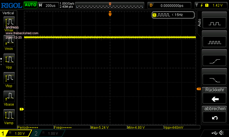

andreas
Joined: 07/12/2020
Posts: 226
Posted: 07:43am 20 Dec 2021
Hello,
thank you for all the good tips!
Today I looked at VBUS the power from the USB cable comming from the PC which powers the pico. Peter told me that "You would see a change in temperature of over 4C for a small 1% change in reference voltage".
I can see that the VBUS is not only changing by 1% but by 8.8% (440mV). The hihgest voltage is 5.24V and the lowest 4.80V. This explains all the problems I have with pin(temp) if it is based on this power supply.
Lesson learned: A computer is not a good voltage reference when doing measurements!
So the solution seems to be to get a reliable, stable power source (possibly by battery?), before doing any measuremnts.
-andreas
