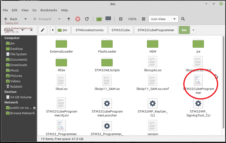

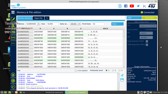

Posted: 04:16am 13 Dec 2021
I spoke too soon.
navigate to Graeme/STMicroelectronics/STMcube/STM32CubeProgrammer/bin
right click on STMCubeProgrammer
and "run as administrator"
bingo!!!
And No, you can't just right-click on the desktop icon ans select "run as administrator". That would be too easy.
And the fact that you are in the administrators group probably doesn't make any difference.

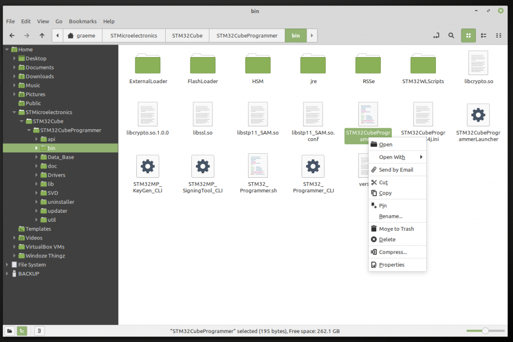

Posted: 06:07am 13 Dec 2021
Won't work for me.
Still says no DFU detected if I right-click run that file.
You say run as administrator - but there is no option to do that if I right-click that file.  I can only open it normally.  There simply is no menu entry saying "Run as administrator" when I right-click that file.
Have I missed something?
EDIT: Here is a photo of what I am seeing....
Edited 2021-12-13 16:14 by Grogster
Posted: 06:48am 13 Dec 2021
That's two differences between our installations of Linux Mint 20.2
My version is codename "Uma"
It might be because you are an administrator but I have really run out of ideas now.

Posts: 3419
Posted: 07:07am 13 Dec 2021
What happens if you select the bottom one, Properties? Can you set the permissions there?
Still on Mint19 so may be different.

Posts: 10076
Posted: 07:09am 13 Dec 2021
  phil99 said  What happens if you select the bottom one, Properties? Can you set the permissions there?
NO.
I did look at that, but there is nothing in there that allows me to tell Mint to run the file as administrator.
Posted: 07:11am 13 Dec 2021
