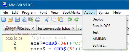

Hi Jim,
I currently have .BAS files associated with MMEdit and run the MMBasic program by clicking on the gear icon or the running man as appropriate. I would like to be able to associate .BAS programs with both MMEdit and MMBasic.exe but Windows doesn't allow that.
I was thinking of either another batch file to choose between MMEdit and MMBasic and maybe Notepad as well or just right clicking on the .BAS file and choosing 'Open with' (probably easier).
Do you have an alternate?
Is it possible to use the one instance of MMEdit with either version of MMBasic.exe? Somehow choosing which version to run.

Posted: 04:58am 03 Feb 2022
  Turbo46 said  Hi Jim,
I use right-click to run using another program (usually notepad++)
In MMEditV5, you can configure as many external programs as you desire.
The first one in the list will be the one that runs when you click on the gear icon. It doesn't have to be MMBasic.exe
I may add a second icon.

Thanks Phil,
But that doesn't work for me. I thought you were supposed to be able to drag and drop a .bas file into MMEdit but that doesn't work. I end up with my BASIC program on the desktop and the MMEdit shortcup moved to one side.
Dragging a file into MMBASIC's shortcut does run the BASIC program but not in the directory where it comes from. I need that for the program I am working on because it has other support files and folders in that directory. Sadly the 'Open with' option does the same thing.
Dragging the BASIC program into a copy of MMBASIC.exe in the same directory DOES work though so I can avoid the MMEdit intermediate step.
