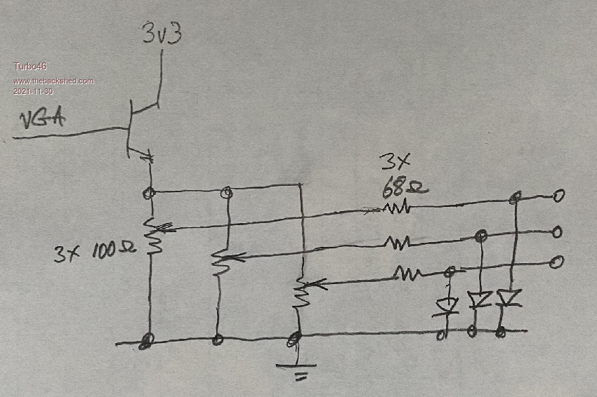

@Grogster, This would be my first pass at a circuit for VGA. Untested and I don't have an easy way to test it.
But I really think it's all a bit OTT and unnecessary. I think Volhout's suggestion is all that's needed, perhaps allow for different value resistors in place of the links to adjust the colour if it's needed.

  Turbo46 said  @Grogster, This would be my first pass at a circuit for VGA. Untested and I don't have an easy way to test it.
be wary: 2.7v into 33 ohm (3x 100 ohm in parallel) equals 80mA of current consumption JUST for the one-transistor video driver!

80mA and more through the monitor inputs. The PN100 is good for 500mA and 625mW so that should be OK. Minimum gain is 80 so only about 1mA base current needed. I did look at that because I was concerned about the load and dissipation.
Edit: I still think it's OTT.
Edit2: 80mA+ has implications for the power supply though.
Edited 2021-11-30 19:29 by Turbo46

The diodes can be omitted as all the monitors I have tried don't mind a bit of overdrive. Up to 1.5 V seems ok. A 270 ohm series resistor will ensure it stays under 0.8V for 3.3V supply.
With (270 + 75 ohms) x 3 at 3.3V = 29mA so the emitter follower may not be needed for this. The MX270 in the ASCII terminal did need it.

  Quote  For the VGA colors, jumpers to select green/white/amber is enough
Does the saying "A camel is a horse designed by a committee" ring a bell?
K I S S
PS While I think my circuit above would work, the pots would only be effective for about half the adjustment because anything above half way would be clipped by the diodes.

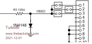

My preferred version of the VGA output.
A modified copy of the mono maximite circuit. The links allow selection of one or more colours and for those who want to fiddle, vertically mounted resistors could replace the links to produce any colour they want.
If a larger CMM1/2 box was used the board could include a 'sea of holes' to cater for those who want to add all manner of weird and wonderful things.

For the video out, I refer you to my earlier post:
https://www.thebackshed.com/forum/ViewTopic.php?TID=14328&P=2#178157
3 resistors.
One each to red green blue.
Provided the user doesn't use values below 270 ohms (I would prefer 330 if the display is bright enough), the pic will not be over-loaded and the monitor will not be over-driven.
Minimum load on the power supply.
Blue omitted, 680 ohms to green and 330 ohms to red for amber.
If you want to get really fancy, a 470 ohm pot in series with a 270/330 ohm resistor but I call that overkill.
