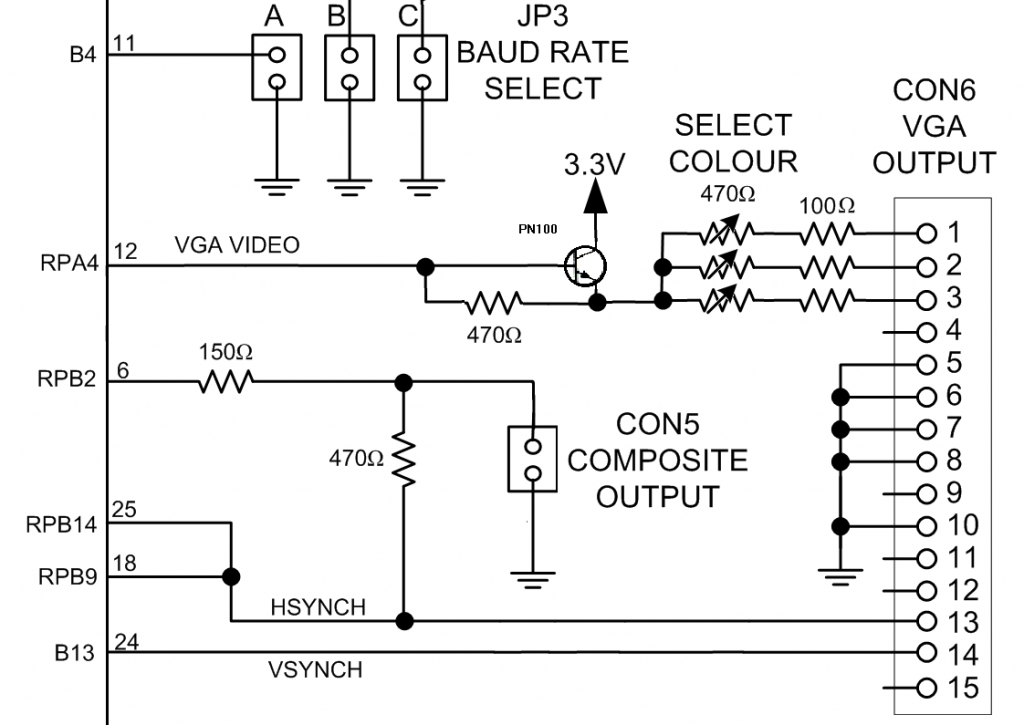

Posts: 3419
Posted: 11:27pm 28 Nov 2021
"Can the VGA output drive more then one of the colour inputs to the VGA monitor?"
On Geoff's ASCII terminal I used an NPN emitter follower to allow it to drive all colours.

Posts: 10076
Posted: 03:12am 29 Nov 2021
  phil99 said  "Can the VGA output drive more then one of the colour inputs to the VGA monitor?"
Owwww - that's a clever idea, and so simple.
Did you just use a 75R emitter-ground resistor for the load?
Did you have one NPN per colour channel, or just one NPN driving all three?
Your post would seem to suggest just one NPN driving up to all three...
@ Jim: Yes, Amber is a nice compromise too.  I still remember some ancient old WYSE terminals I used to repair that had amber CRT's, and they were quite easy on the eyes too, so perhaps.....
If I put the RGB jumpers after an emitter-follower, then we could drive all three colour signal lines in any combination you want.  I think that will have to be the plan.
Would probably want to use the clamping diodes for that arrangement I guess.

Posts: 3419
Posted: 04:57am 29 Nov 2021
@Grogster
Here is what I used.

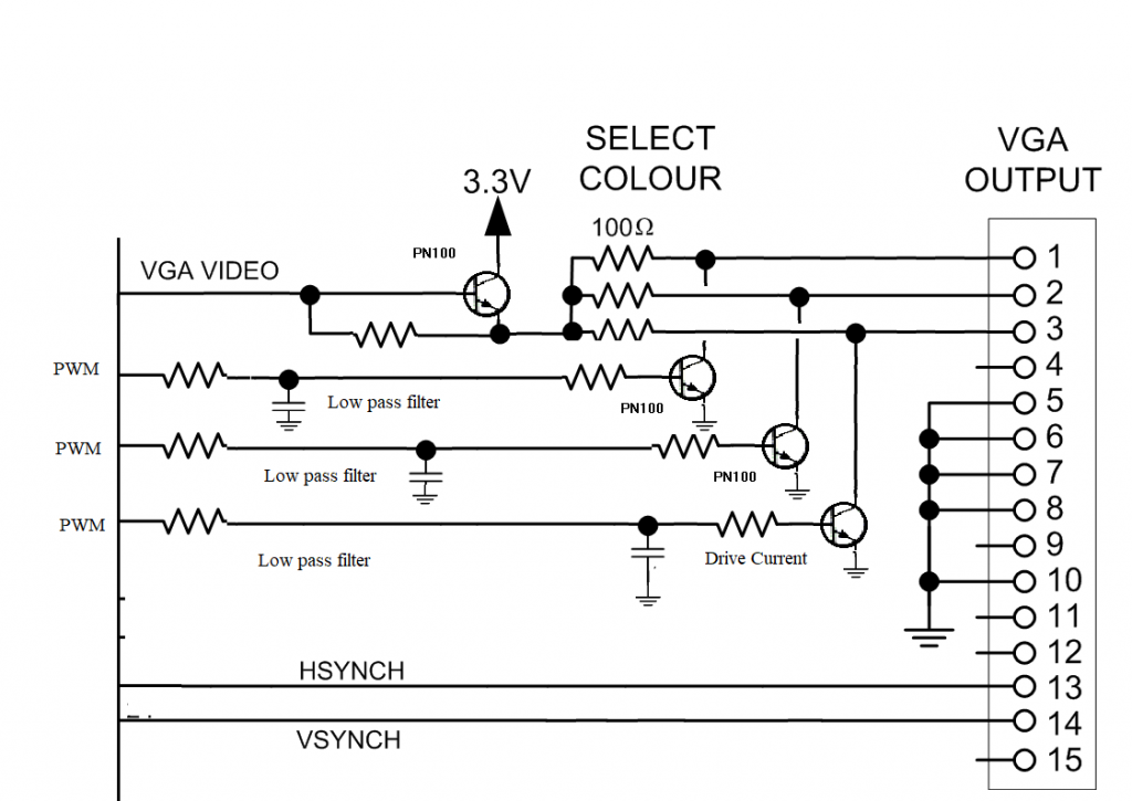

Posts: 3419
Posted: 06:19am 29 Nov 2021
Analogue software colour control might be as easy as using 3 PWM signals to shunt signal from the three VGA colour pins. Rudimentary colour graphics done by changing the colour mix between graphic commands.
