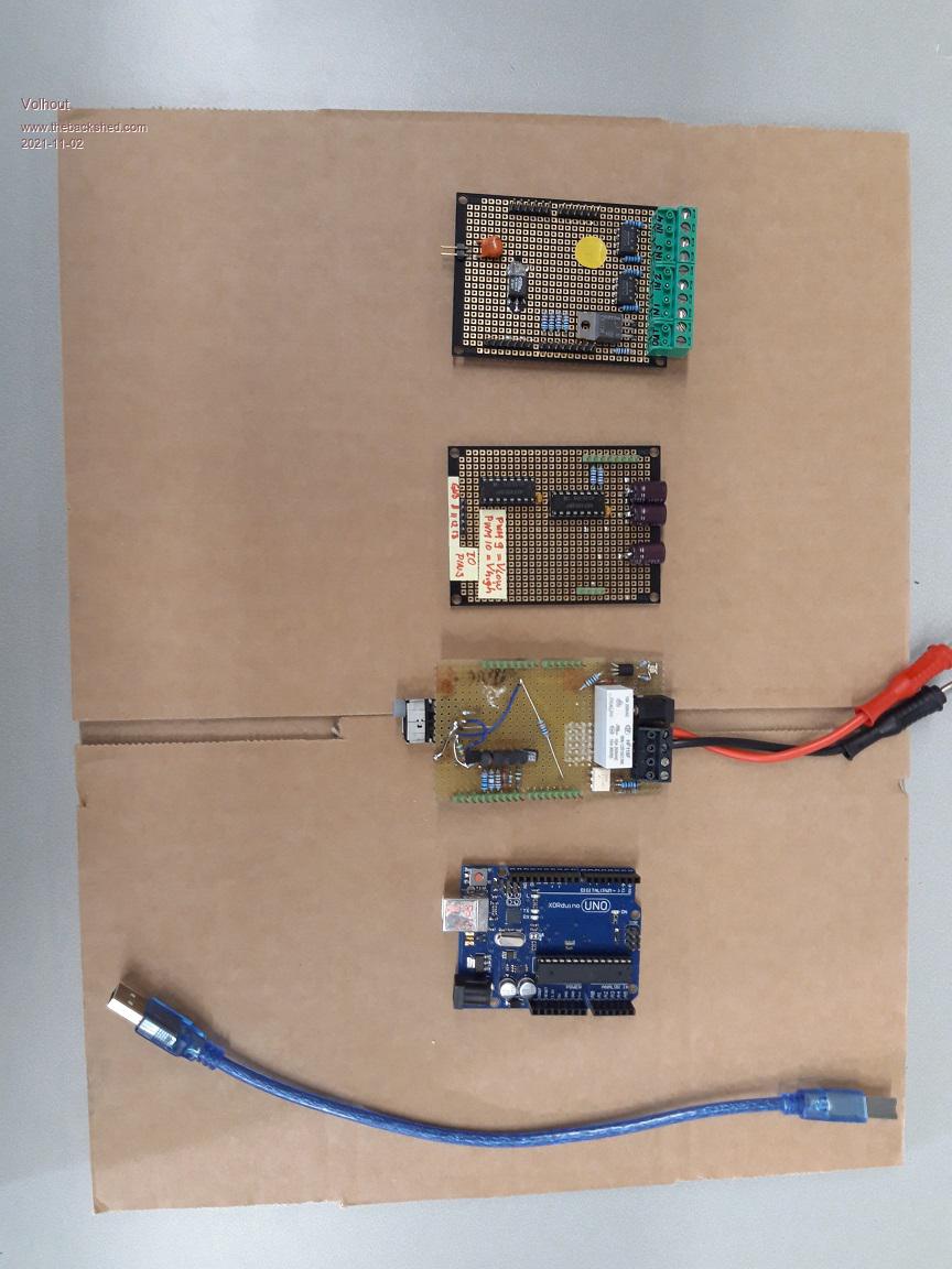

A photo of some of the Arduino UNO cards I made, specific for a task.
The upper card has 4 opto isolated inputs, and a isolated high voltage PWM output (100kHz PWM).
The one below has analog switches, where the analog voltage is controlled from 2 UNO PWM's. I use this to convert normal logic levels (i.e. 3.3V SPI) to +2.4V / 0.8V SPI to check if circuits work under worst case logic levels.
The one below has a mechanical relay, an opto input, and an analog current controlled fiber transmitter (check for linearity faults in fiber receivers).

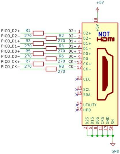

What I haven't seen (unless I've missed it)
Is the fact the Pico can output DVI signals easily and only needs 8 pins
Yes that might put some people off but DVI to HDMI adaptor cables are readily available and there is no licencing issues with DVI as it's open source.
DVI adaptor board

  lew247 said  What I haven't seen (unless I've missed it) is the fact the Pico can output DVI signals easily and only needs 8 pins
Thanks for that, Lewis. Don't know if I'll ever use them, but just in case, I've ordered 5 picosock PCBs from JLCPCB, slow boat shipping, for the grand total of $4.60.
("only needs 8 pins", LOL)

(I assume the frame buffer memory issue would also apply to the picosock DVI PCB setup.)
Posts: 12082
Posted: 01:33pm 02 Nov 2021
  Quote  (I assume the frame buffer memory issue would also apply to the picosock DVI PCB setup.)
Yes

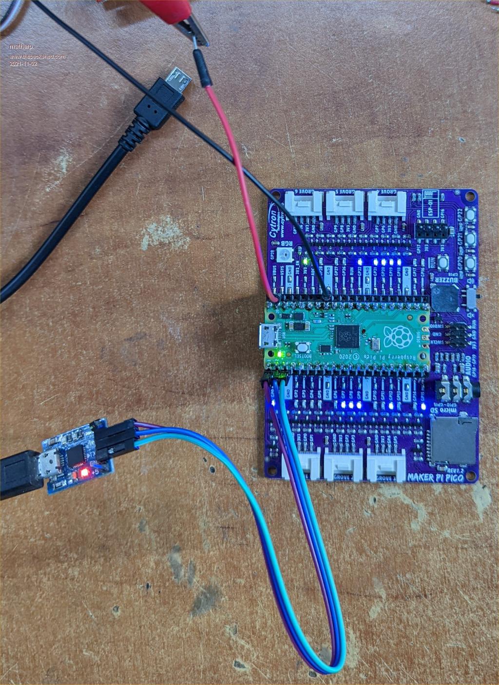

  Quote  When you consider a dumb terminal as development interface to a picomite, it would currently need a USB interface
You mean like this?
Watch out for beta 4 later today
