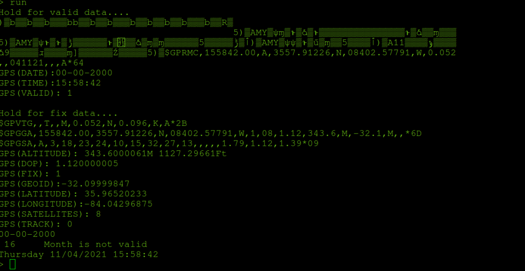

Maybe this helps, looks like the com buffer hasn't been cleared when the open happens
and if it's an $GPRMC as the 1st message, the date is not setup correctly
GPS Monitor ON
> run
Hold for valid data....
$GPRMC,155836.00,A,xx57.91263,N,xx402.57796,W,0.016,,041121,,,A*61
$GPVTG,,T,,M,0.016,N,0.029,K,A*2F
GPS(DATE):04-11-2021
GPS(TIME):11:58:36
GPS(VALID): 1
Hold for fix data....
$GPGGA,155836.00,xx57.91263,N,xx402.57796,W,1,07,1.24,343.7,M,-32.1,M,,*63
GPS(ALTITUDE): 343.7000122M 1127.624714Ft
GPS(DOP): 1.24000001
GPS(FIX): 1
GPS(GEOID):-xx.09999847
GPS(LATITUDE): xx.96520996
GPS(LONGITUDE):-xx.04296875
GPS(SATELLITES): 7
GPS(TRACK): 0
04-11-2021
0
Thursday 11/04/2021 11:58:36
again
(had to paste image, as it has special characters)
Rob

Hey Peter
in GPS.c
You have this
 if (strstr(nmea, "$GPRMC") || strstr(nmea, "$GNRMC")) {
  // found RMC
   char *p = nmea;
   int i;
   // get time
   p = strchr(p, ',')+1;
Which could be like this
  // found RMC
   char *p = strstr(nmea, "$GPRMC");
   if(!p) char *p = strstr(nmea, "$GNRMC");
   int i;
   // get time
otherwise, if nmea has garbage, it'll find the $GPRMC, but point to the garbage
Thoughts ?
