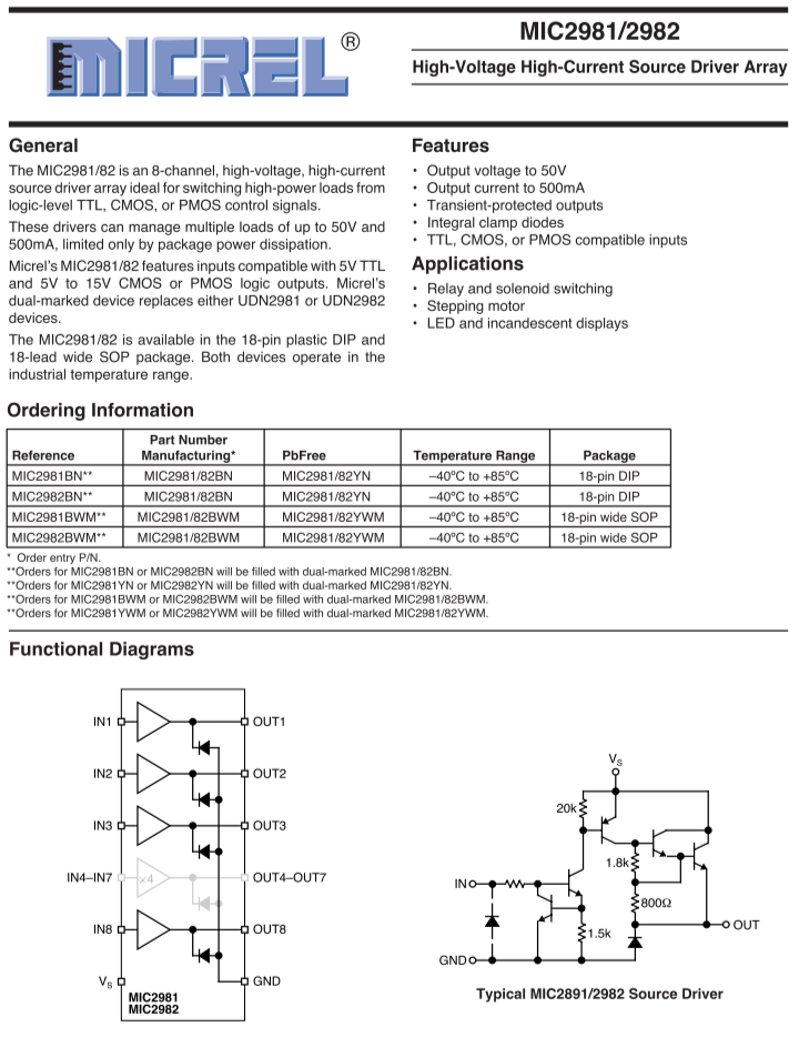

Tinine
Joined: 30/03/2016
Posts: 1646
Posted: 09:59am 24 Jul 2021

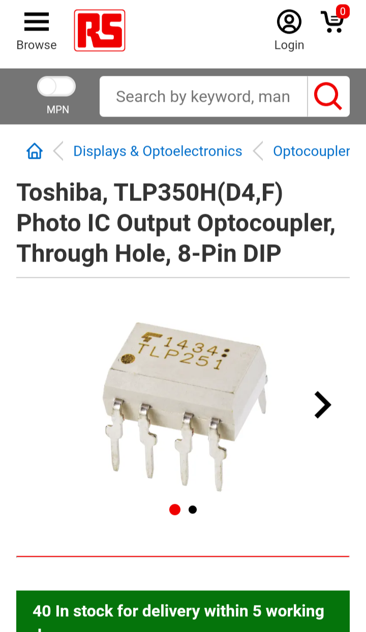

It's common practice to parallel the channels of these devices; it all boils down to the total dissipation.
I would probably use 4 channels for the 900mA and just because they are available, 2 channels for each of the 100mA loads.
Bearing in mind, also that; these are flashing lights and so, presumably, 50% duty cycle?
If opto is a a requirement then there is the TLP350H which will accomplish everything (2A).
