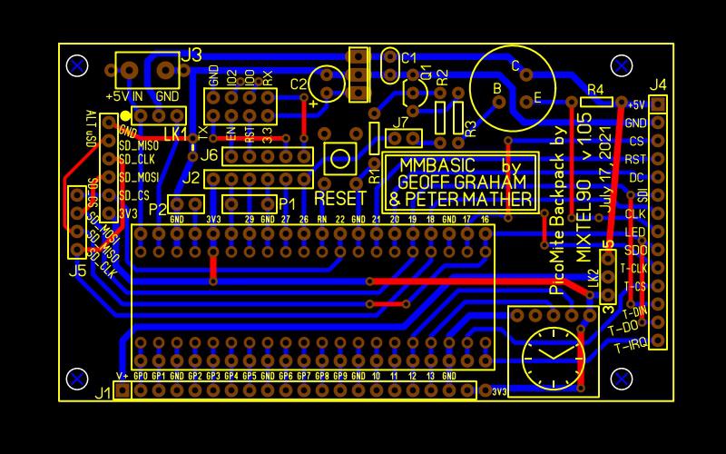

Just saw this thread a few days back and a fresh Pico with V5.07.00a47 seems to be working on a vector board.. I am a bit late to this thread but would love to have a copy of that awesome PCB when available... For now I want to try hooking up the circuit and see if I can get the ILI9341 Display and SD card to work.. I was looking in another thread to see what the INIT code would be for it... Will try and get it going... Much thanks for all the work done with this awesome $10 board... Even has a 12 bit ADC... Nice...

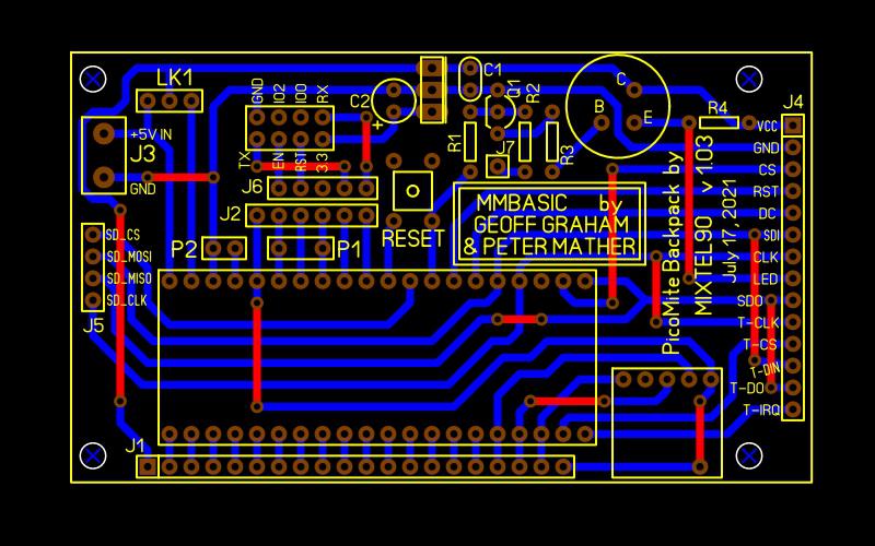

V1.03:
changes:
Capacitors C1 and C2 relabeled,
Speaker redrawn as 12mm
R4 shifted for more space
J7 labeled
Vreg reversed left/right
Pad/drill sizes juggled here and there slightly.
Can you confirm the Pico pin spacing is .700 inch?
Also, where is J7 likely to be connected to? Easy to run traces now...
Posts: 9265
Posted: 05:49pm 17 Jul 2021
The official drawing for the Pico gives 17.78mm. By some curious coincidence that works out at bang on 0.7". :)
I left J7 disconnected as it may not be needed at all and would only be using a pin unnecessarily. Additionally, I'd used all the IO pins on that side of the Pico and single-sided routing from the other side would have been a pain.
For non-square waves it would go to a PWM pin. I *think* it would be on any free IO pin for GUI BEEP but I've never used that. If someone wanted to they could connect an off-board 5V relay with parallel diode to the drain of Q1 and +5 and get a clean contact out instead of using it for sound. :)  I think leaving it free gives maximum flexibility.
If you consider it a good idea to put a pin close to J7 (a 2-pin link might be a good idea) then I think I'd suggest GP11 (PWM5B). It's in a logical position on the circuit diagram and is probably one of the easiest to route on the PCB.
Pin spacing on C1 could be 0.1" or 0.2", but it's not something I generally worry about. It's easier to jam a 0.2" cap into a 0.1" pcb than the other way round. :)

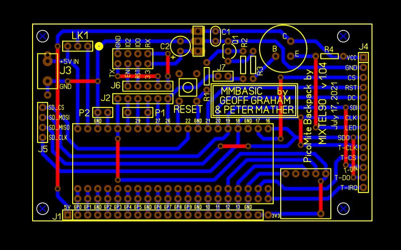

V1.04:
J7 can be jumpered to GP26 - PWM5A,
More labelling,

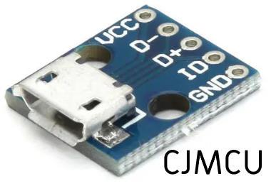

Extra pads around J3 so that a CJMCU USB jack fits.
Posts: 9265
Posted: 08:28pm 17 Jul 2021
That's fine. The mosfet could be wire jumpered to somewhere else if the ADCs are wanted.
I've not used the CJMCU before. Neat option if it will fit. :)
Why the extra row of pads for the Pico and adding an extra blank pad on J1 next to 3V3?
@lizby
We might be able to put a pair of unequipped pads, but J5 can't be extended to either side. SDCLK is almost hard up against the USB plug on the Pico. The pads could have a 90 degree connector on the copper side, between this pcb and the display.
Edited 2021-07-18 06:36 by Mixtel90

V1.05:
J3 pushed around to top edge to make room for alternate uSD card, as linked previously, (CJMCU USB jack goes underneath now)
Voltage on J1-1 selectable with LK2 (near clock module),
Most traces reduced to 24 mil width, except for main power traces. Board could still be fabbed as single sided with jumper wires, except for "ALT uSD",
Both sides of Pico have spare row of pads for custom butchering, er, customizing,
Pins IO0 and IO2 of ESP8266 access pads added, in case someone needs 'em,
Silly graphic added to real-time clock footprint ;-)
Posted: 12:52am 18 Jul 2021

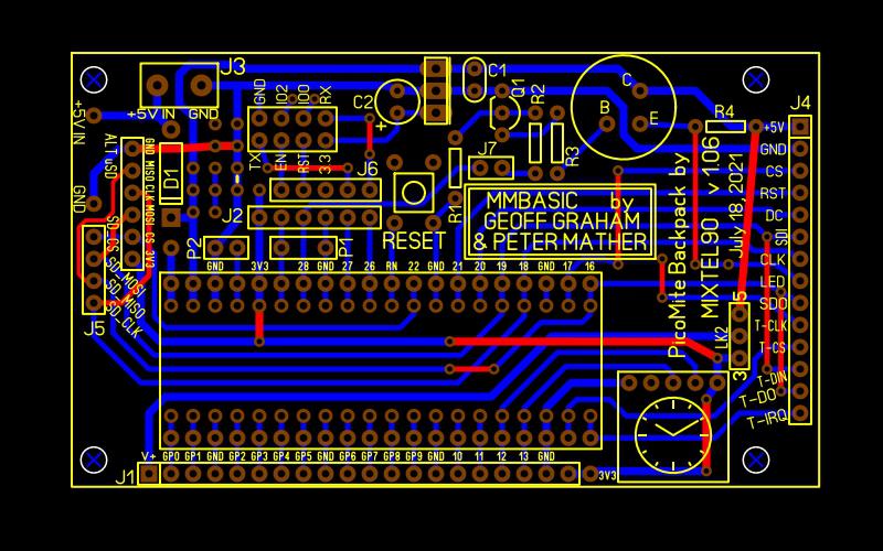

Posted: 09:53pm 18 Jul 2021
I'm drawing this with Sprint Layout.
Note about board size:
As drawn, the board is 50x86mm, which exactly matches the ILI9341 module on my desk. Stretching the board to 100mm wide with a 'sea of holes' (or maybe just a 'small pond of holes') would still allow 2 boards per 100x100mm cheap PCB offer from various board houses.
V1.06:
I think I understand the change requests:
LNK1 is gone, D1 sort of in its place,
J7 moved to GP28, which is AN2, I think,
A bunch of extra pads beside D1, some 5V, some GND, one 3V3, plus 3 isolated.
Posts: 6206
Posted: 06:15am 19 Jul 2021
Swap C an E at the backlight transistor footprint
Posts: 9265
Posted: 06:58am 19 Jul 2021
Yep, that looks right. I didn't think there was space to get a track from J7 to GP28. Neat job! :)  LK2 could be LK1 now.
On this particular build I'm not in favour of going outside the dimensions of the display. My concept for it is as a module to be used in other equipment, not as a development platform so, unless the holes area could be easily snapped off, then I don't like the idea. As it is the module will fit into a small, standard plastic box if the ESP is left off and a slot cut for the SD card. I originally tried to get the ESP within the display area too, but decided that the antenna was probably better if further from the board and that if the module was put in a metal box then it would be useless anyway. It was low on the list of priorities - more of a "nice to have space for".
Having said all that, I've started looking at the idea of an intelligent IO extension that goes between the display and this pcb, using long pin headers for "pass through" display connections and picking up on the RTC I2C, GND & 3V3 pins at the RH end of J1 (probably using a lead). It would hold a 28-pin MX170 connected via I2C. (Not sure what else yet). A similar idea could use a full-size "sea of holes" should someone want one.
How do you like Sprint? I've done a little design on both KiCAD and Eagle. Both are good in their own ways. I find Eagle much more user-friendly but KiCAD much more professional.
Edit:
Quite right, Volhout. Blast these olde-worlde PNP thingies...  (Q2)
Edited 2021-07-19 17:01 by Mixtel90

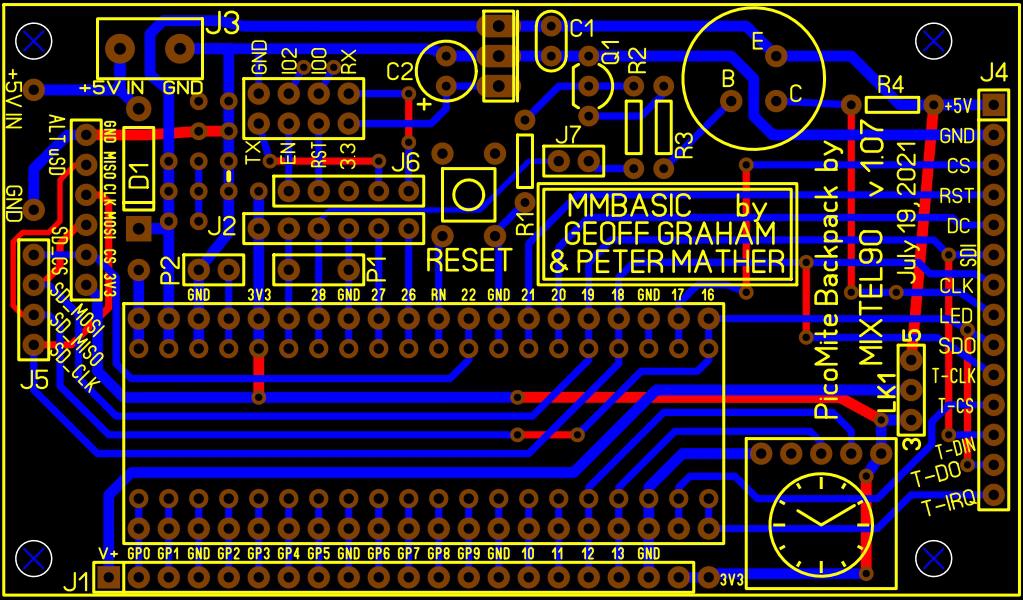

V1.07:
LNK2 renamed to LNK1,
E & C reversed
Bit more trace clearance from J7 to GP28
Fixed trace to T-CLK  (got disconnected)
