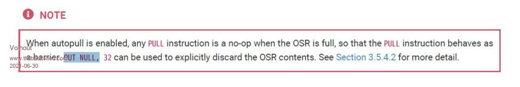

out null,32 won't assemble as there are only 5 data bits.

About out null,32:
So you shift out 32 bits from the OSR, basically clearing the OSR.
