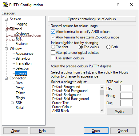

Perhaps, does the Linux version have this option page (from Windoze):
Is there some selection of options in the top-panel that "fixes" the discrepancy ?

  thwill said  Perhaps, does the Linux version have this option page (from Windoze):
Almost the same, yes. (Under Window | Colours)

My linux version does not have
Use system colours
Attempt to use logical pallet

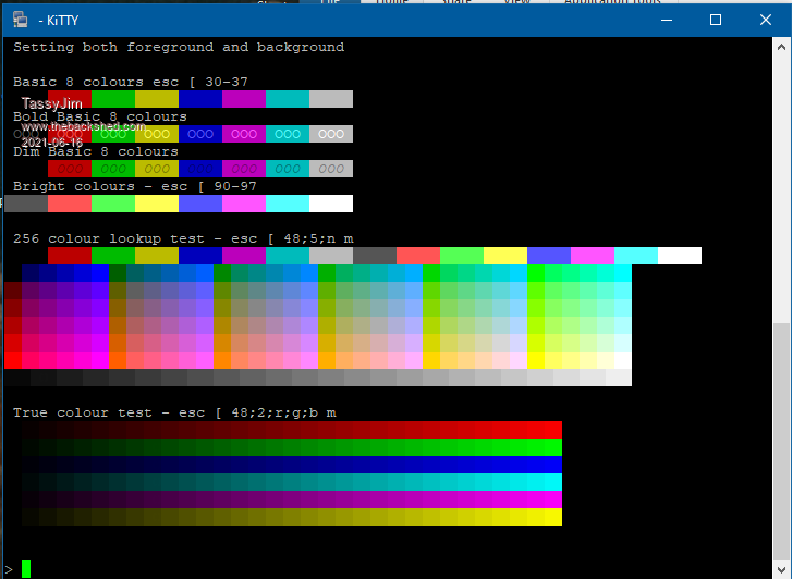

Posted: 05:00am 16 Jun 2021
And the winner is
Kitty (sorry, Windows only)
https://www.fosshub.com/KiTTY.html
Kitty is a fork of Putty with a few extra features added.
It correctly renders DIM text. DIM and BOLD do not change the backcolour.

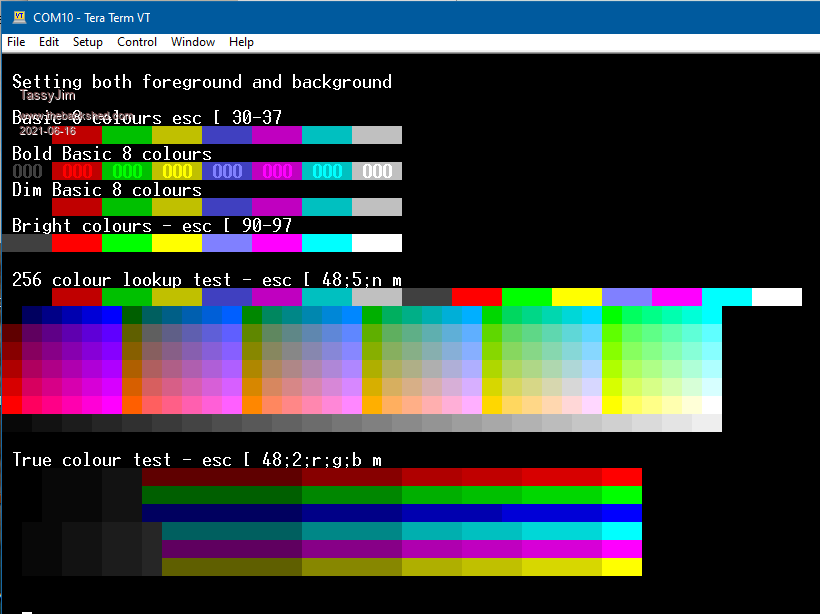

Compared to TeraTerm:

hi jim,
  have you tried Kitty with an MX170 and with OPTION COLOURCODE ON editing a program? that is the cruncher.
