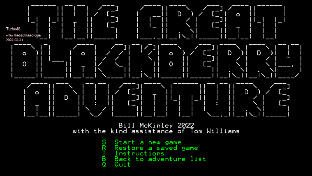

Posted: 05:48am 21 Feb 2022
I have written a Scott Adams style adventure:
Blackberry.zip
The idea came from a comment by lizby about picking blackberries in a previous post.
It is a small adventure with one treasure and 17 locations and it is kid friendly, no gruesome death. There are several ways to complete the adventure and only a few ways to get into trouble. It would be a good one to involve a child, our hero is most likely to be a young boy but not necessarily.
Like any adventure of this type will have to draw a map as you go or you will get lost. It will fit on an A4 sheet so it's not a big task.
Tom has been tireless and very patient in assisting me with this by testing, identifying bugs and making suggestions. Without his help it would have been nowhere as complete and playable. He is doubtless glad to see the back of it. Thanks Tom.
Tom has updated SAAINT since the post above and the download now includes blackberry. If you want to play blackberry (and I hope someone does) then I suggest that you download the latest version. Any comments or suggestions would be gratefully accepted (because it would mean that someone actually tried it   )
If you just download this file the unzip it and put the two files in:
saaint\adventures\misc
