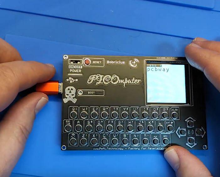

RP2040 with qwerty keyboard and display

now an interesting possibility: hook two pico's together via their USB ports - the pico is capable of acting as a USB host. pico 'A' (as a CDC device) could run mmbasic, with all the I/O pins free, while pico 'B' (as a USB host) could act as a VT100ish terminal, drive an LCD screen, and scan a matrix keyboard. this terminal emulation could be written in python, largely using existing code that is already out there.
this could give you a neat little pocket computer in a form-factor similar to this:

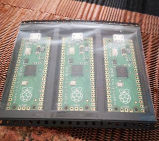

Posted: 11:39am 29 May 2021
woot! less than 24 hours delivered.

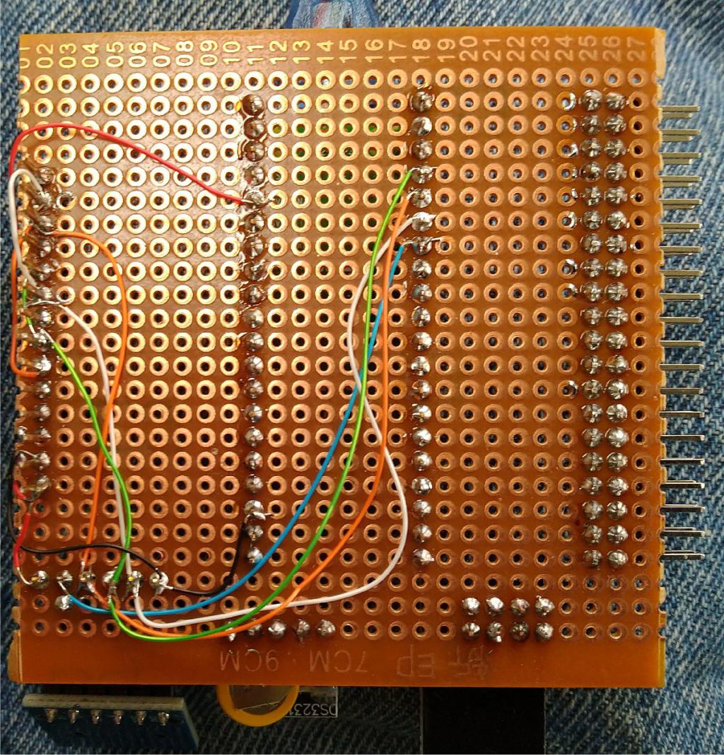

Wiring:
My Newfoundland wife says I have a tendency to be what in Newfonese is a "keener". Is this proof?
